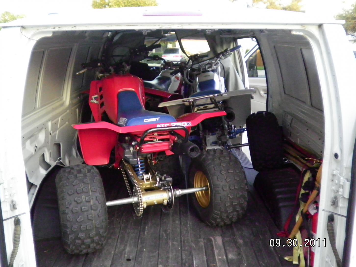

    I paid $1900 for my 85R a couple of years ago. It was worth every penny. I replaced the stator but I'm not sure I had to. Changed all the fluids including taking the calipers apart and cleaning the gunk out from behind the pistons. I finally put a chain/sprocket set on it this spring. I spray painted a few things that had surface rust issues. No other big $$. I don't have many pic of it:

    I paid $700 for my 85 350X and I'm not sure it was worth that but it was a cheap entry price to a 350X and I did not have $2k to spend at the time. I don't keep real close track of project costs but I probably have close to another grand in it and I did not buy fenders - which it needs. I doubt I could get my $1700 out of it unless I spend some $$ on fenders.

    Hard to tell from the pics what a POS it was.
    My point = a nice one is worth the $$

    Quote Originally Posted by 86125m View Post
    jb2wheels your 350x looks great I don't see what wrong with the fenders personally.
    If you look closely, you can see they are sun faded, it is hard to get a clear photo of that, I sold a fender in the past like that and couldn't capture the "badness" of it very well.
    The way I see it, even though he has $1700 into it, it is way better than a $1700 machine with problems/rigged up stuff and pretty plastics.

    We're sliding off topic but...
    Yep - I know every nut bolt chain link and bearing on this thing.
    And the plastics are 10 footers no doubt. Can't see the crazing, cracks, patched cracks, zip tied crack, and the spot where I melted some while "welding".
    But it's an awesome dune ride - ride hard, change oil, repeat!
