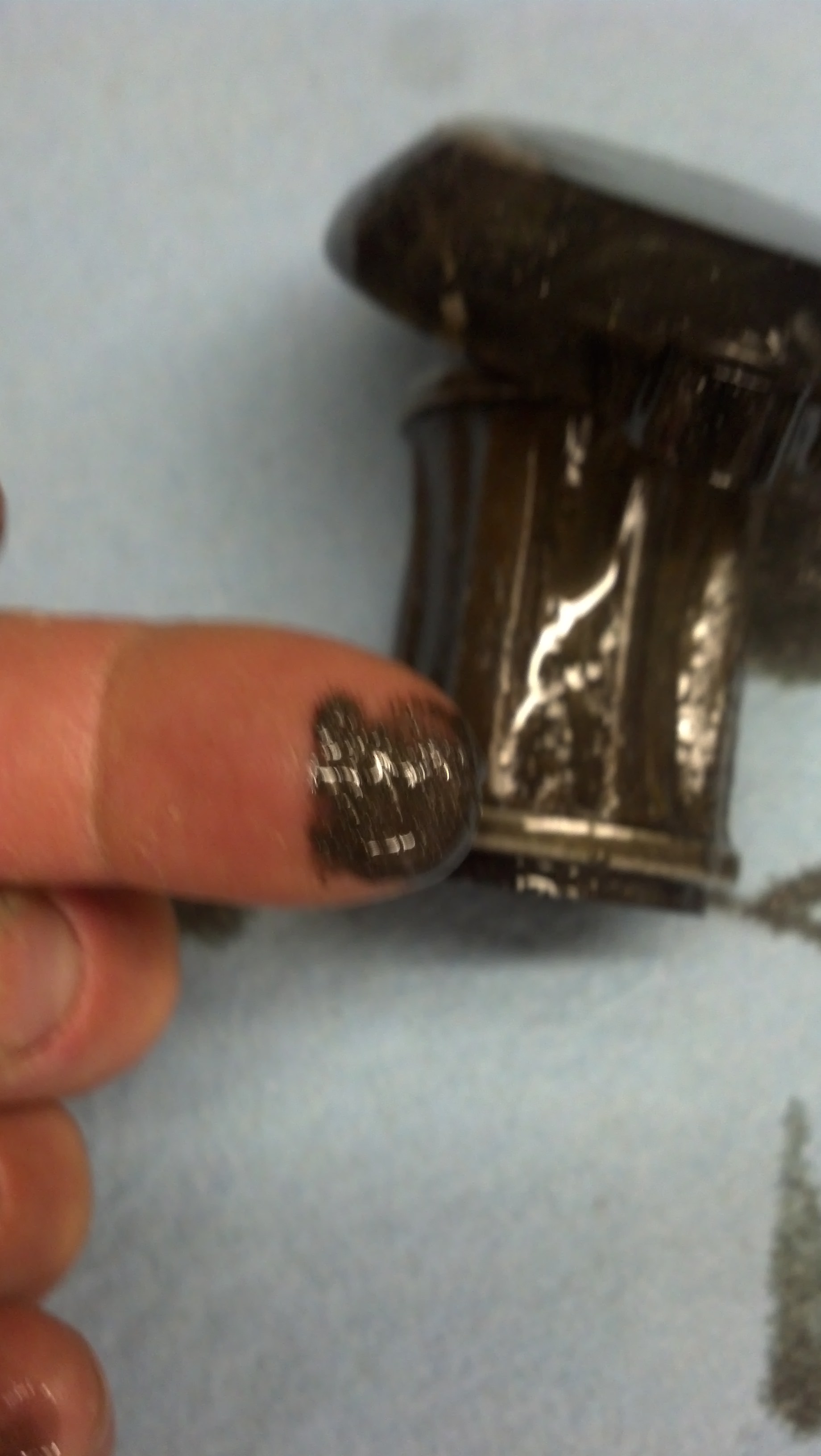

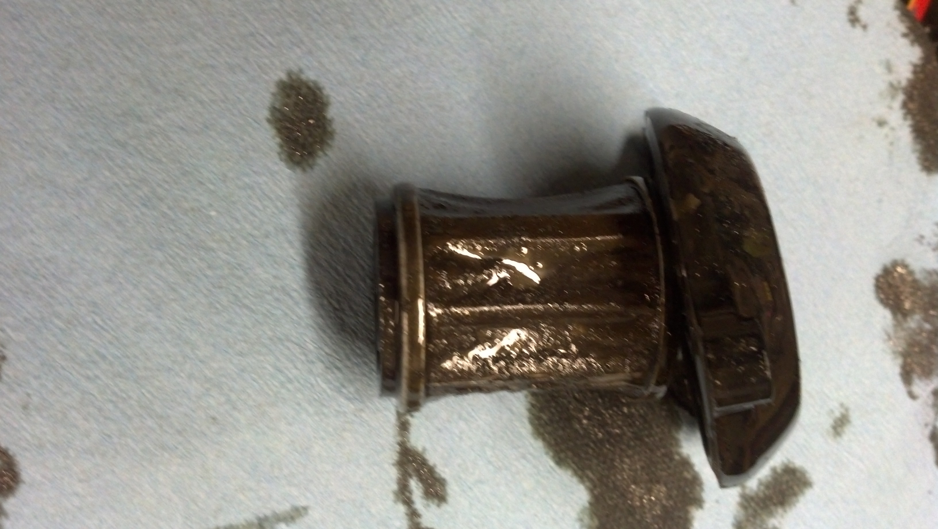

    I ran the first oil change for less than 10 hours and changed it, both the drain plug screen and filter were once again full of metal shavings. I figure I'm gonna have to dig in to the clutch setup and find out what is rubbing where. Good news is I have another complete bottom end if needed...

    Boy that doesn't look healthy at all !!!!!
    glendive, montana
    1,822
    Check with a magnet to see if it's steel or if its aluminum. I have a feeling you're looking at a complete tear down and rebuild on that soon. I would also check the compression and see if its low.
