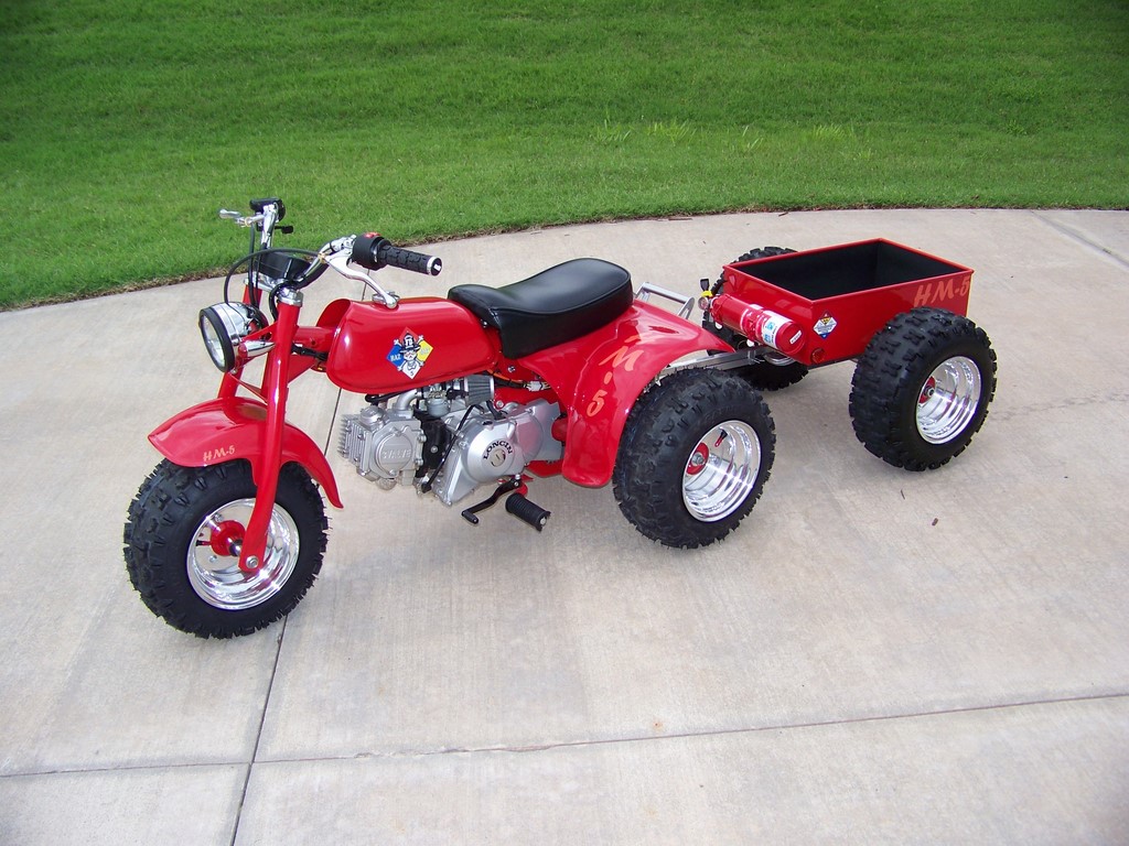

    Thanks. yes i think i am gonna cut and weld it to the right angle. Do you have any photos of your setup?
    Jan 2011
    Choctaw, OK
    2,755

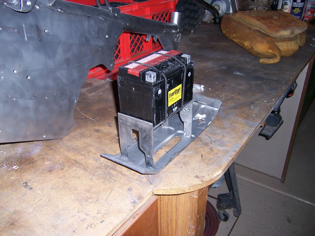

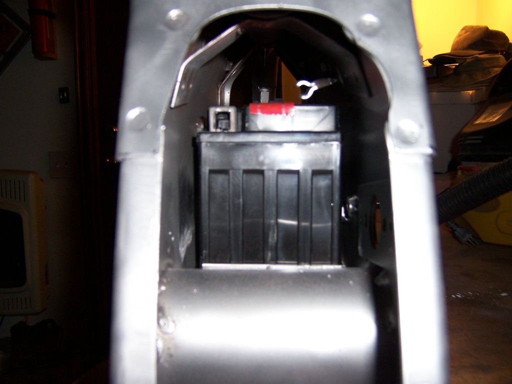

    This is what I did with mine.

    Apr 2014
    newfoundland
    Thanks appreciate the photos! That atc looks really good and the batter box looks awsome!
    Jan 2011
    Choctaw, OK
    2,755
    It works. The only wires on the battery is the 2 battery cables. If I ever need, I can get to the solenoid terminals to charge the battery.
