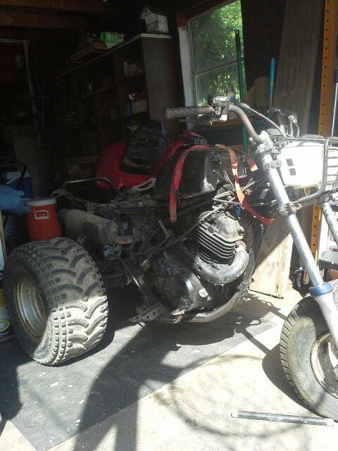

    just picked up this ol atc from a friend for a steal.. didnt run when i got it but after cleaning up the carb she started right up and everythings in working order. just looking for some info on this machine.. what would be my best bet for parts??? i do have the original tank rusted though in a few spots got that getting ready to paint now. and did these things have any issues?? all ive heard so far are great things. but any bit of knowledge would be great. picked it up for 40$ let me kno what cha think, thanks.

    wow... $40.00 is well worth it in my eyes. lol do you have all the plastics for it? that's the big money stuff. go to the partzilla site and download the parts breakdowns for the trike, it will give you the names and part numbers of all the parts and they sell a lot of the stuff there as well...well, what ever stuff is still made...lol plus you can cross reference the part numbers and see what other bikes, trikes and quads they were also used on this way it makes it easier to find hard to get parts on like, ebay... say if the carb floats were used on your trike and on a Honda 2 stroke dirt bike and two different quads, youd now be able to search for it under each bike instead of just the 250R.
    good luck, it should be really cool when done! Yes, the 250R is a very popular trike, lots and lots of members here have them!

    Wow, $40 that's a total steal!!!! Take a look at the vin tag, from the pics it looks like it's an 86, or maybe even better and 87.

    It is actually an 86. And its awesome in need of some new tires and rims. Back plastics a few other small thing

    It looks like it has some killer potential. Make sure to post up pics of your progress.

    Several parts from the 250es big red swap onto the sx, most of the engine is the same, main difference is the color and transmission being geared differently. Bolt pattern is the same on the rims, but I think the 250es was 9in rim while the sx was 8? Body parts do not swap. Differential does, and I think the hubs/axle do too.
    Looks like you mainly need the rear fender, seat, tank, and the rims?
