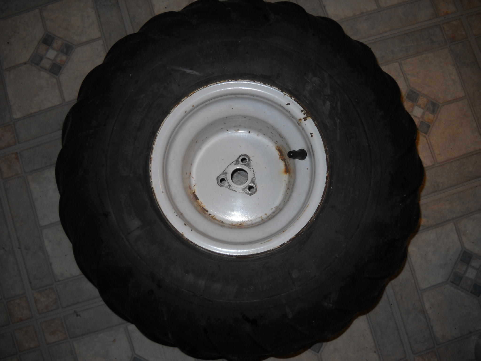

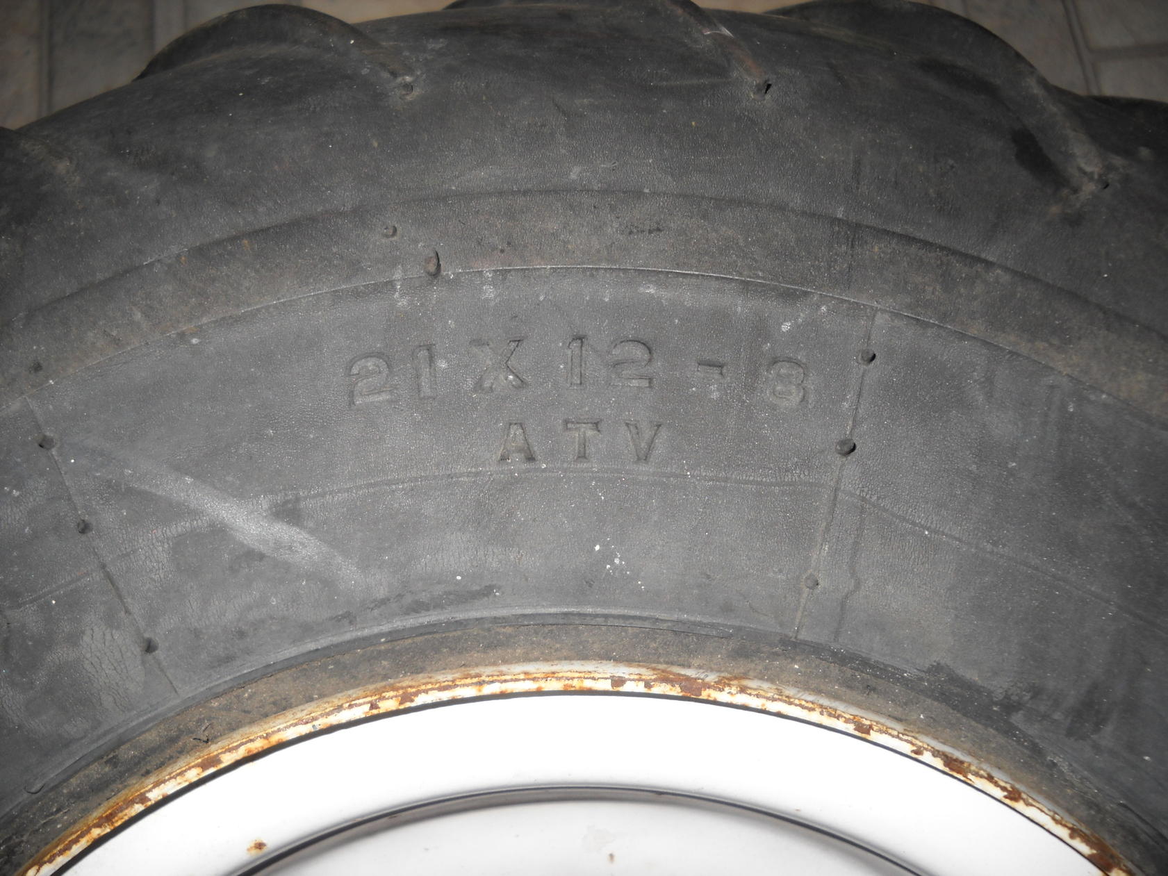

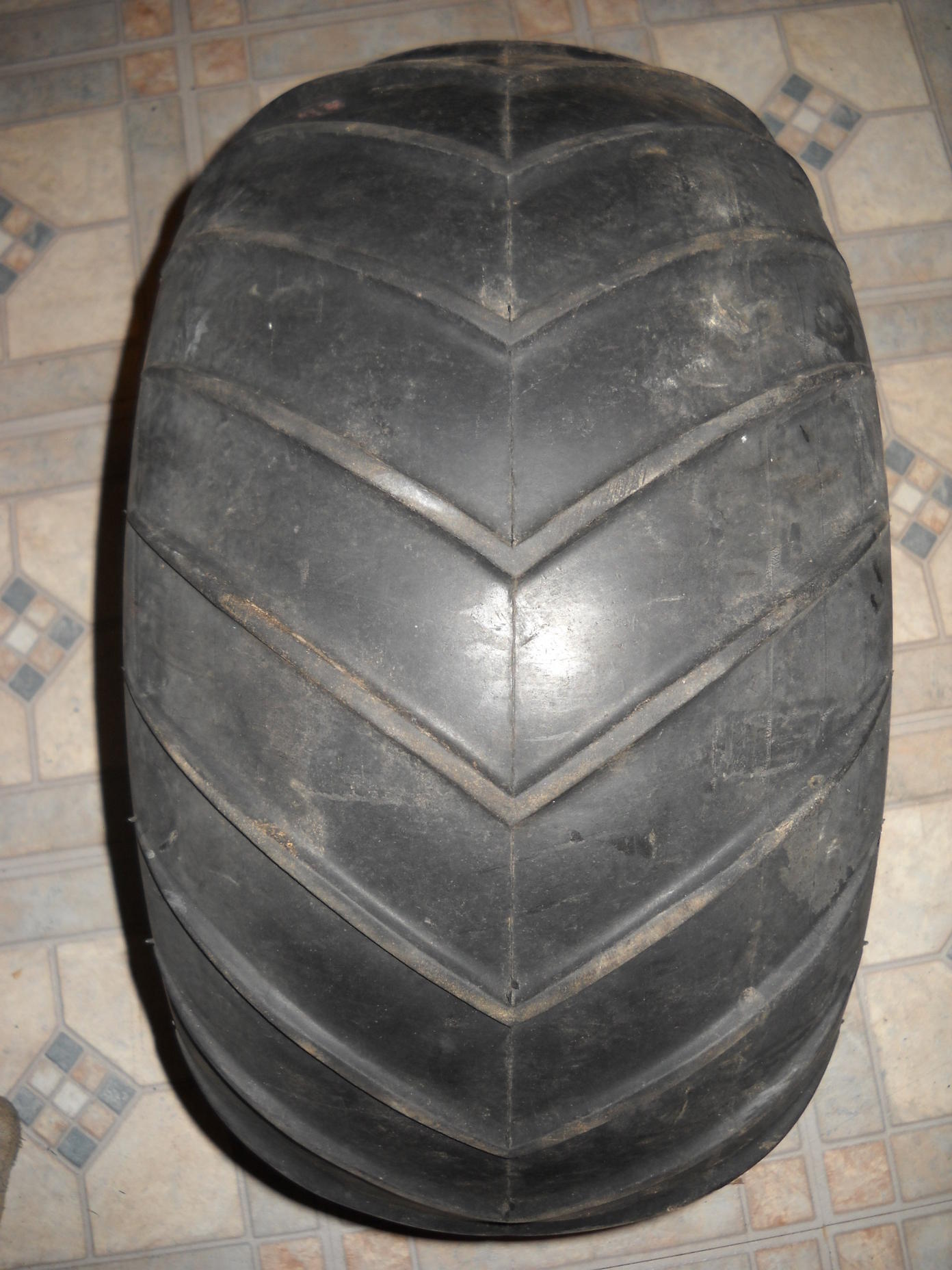

    The US90 I'd say is uncommon to rare. I bought one for parts a while back, the OEM tires are about the hardest thing to find good. I did get an "oem like" tire off a 110 with the same bolt patter. For the year, I think they where made somewhere around 1970-73, then at 1974 the model changed to ATC90, and in 1975 they change the tires to the standard rim+tire setup.
    As for the atc110s, I think they are much more common vs the US90. I have two I parted out, but I think they were 81-82 and the 79-80 had a lot of parts that were different based on what I can remember.
    I attached photos of the tire and the US90 I picked up. I think it was a 1972.
    Overall, I'd say post up some photos and I'm sure there are people here with the parts to fix them up.

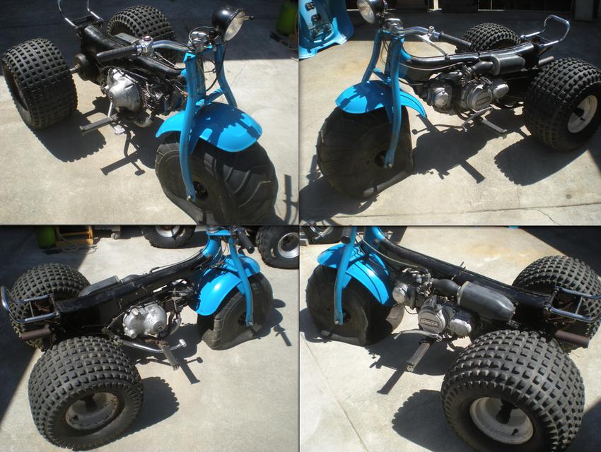

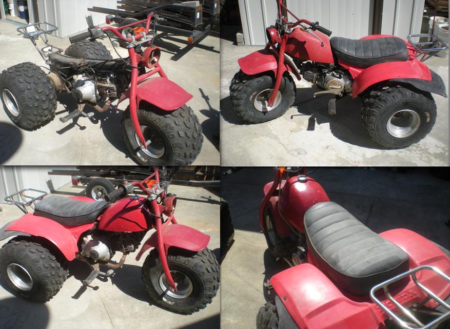

    OK, here are some more pictures. I grouped them in an effort to save space. Anyone asking can have a full photo if they had a need!Click image for larger version.

    Wow, looks like they either cleaned up quite nicely, or your camera is really misleading.
    I'm no expert, but I think the rear rack on the 110 is an aftermarket item and looks to be in good shape.

    I don't really have a story on the front tire/rim, but it is a standard rim with the correct tiny bolt pattern. Not really sure where the tire is from, I couldn't find any info on it. My guess is that it was intended for a 6x6 or 8x8, but I think they had 20 inch tires.
    I'm pretty sure I have an extra atc110 front end if you're looking to convert it over. I should also have some oem split rims with the 110 bolt pattern, just would need to be repainted (spray bombed).

    Haha, I'm about 80% sure the rim isn't from honda, the front hub setup matched my US90 exactly, so my thoughts is someone had it laying around. I don't see why someone would go though the effort to get that setup on a 110 since it never came with that style of rim or bolt pattern.
    I'm not a super expert on these machines, but I'm pretty sure the first year Honda used the larger bolt pattern was in 1975 on the ATC90 when they went from the 1 piece tire/rim to split rims with a tubeless tire.
    I like to use partzilla to confirm interchange of parts and check what was oem factory. For example the link below is for a 1979 ATC110, it came with the split rim and a tire. Sadly, the furthest they go back is 1976, so nothing on the US90s.
    http://www.partzilla.com/parts/searc...EEL/parts.html

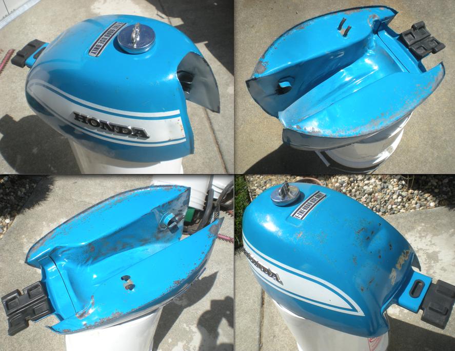

    Hi again, grouped a few more pictures and have attached them. In the meantime have been trying to do more reading. My impression is that of the posts I'm reading so far, most are riders not collectors. Any one have any suggestions on how to get the collectors to talk about detailsClick image for larger version.

    Just noticed your fuel lines, one looks to run to the tank, the other isn't hooked up? Both lines should be going to the thank, one is for on, and the other is reserve.
    I think this is one of the only machines I haven't be able to find a service manual on, but here is a site you can get more of a generic atc90 manual, just to have a good reference since the engine didn't change much over the years. Here is a good site owned by kb0nly - http://www.atcmanuals.info/
    For the most part, people here want to ride their machine, so there isn't a lot of collectors here that only build a machine to look at (proper full restore with 100% OEM parts etc), but if you direct us a question someone that knows your machine will probably reply, like those rear hub adapters, I don't know if that is aftermarket, or home made.
    Also noticed that the chain cover is missing the rubber plug for the oiling hole at the top rear. Kind of looks like the dust cover for that side might be missing too, here is my poor shaped one:
    http://atcfixer.com/bmz_cache/6/6471...ge.733x550.jpg
    http://atcfixer.com/bmz_cache/8/8b56...ge.733x550.jpg
    I re read you first post some and here are some of the major differences off the top of my head of the US90 vs the later production ATC90s (75 and up).
    Axle is completely different, the spines used for the hubs are also very different (newer ones are like quads today, the US90 ones are squared off and are large sized per "spine"
    The front end is very different too, metal front fender, the removable handle bars and of course the front hub assembly as well as the 1 tires.
    Talking about tires, that is the other huge difference. I'm not sure if an axle/hub swap is possible with the later model ATC90, so the tires/hubs/axle might be a 100% indication of what it is (unless the entire carrier is changed, I think they are all the same, bearing sizes might differ though).
    The rear fenders are different as well as the rubber edge to them, the later models ended up having mud flaps that stuck out (like your atc110).
    I don't think the US90 came with a headlight factory, but according to some past research, the wiring should be there to add it yet.
    Also the foot pegs break away (fold in) for easy transport in a car or wagon.
    The special thing about the US90s with their special tires is the fact the pressure on the ground from driving the machine is less than a human, so they float easy, and does not sink in sand/mud like other machines.
