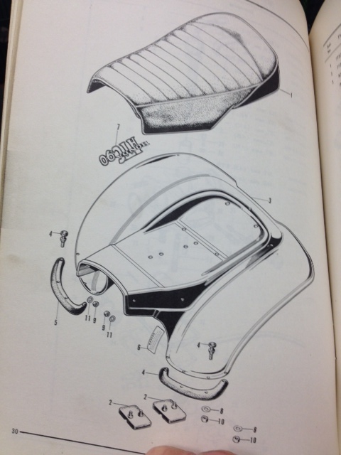

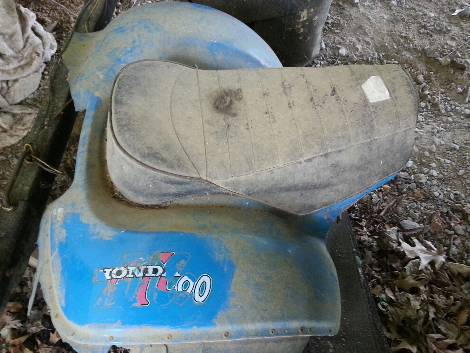

    * No decals used on front or rear fender
    I know the 70-71 US 90 had a fender decal with "Honda ATC90" on the Right hand side on the rear fenders.

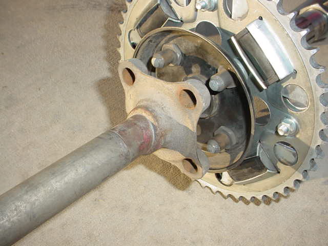

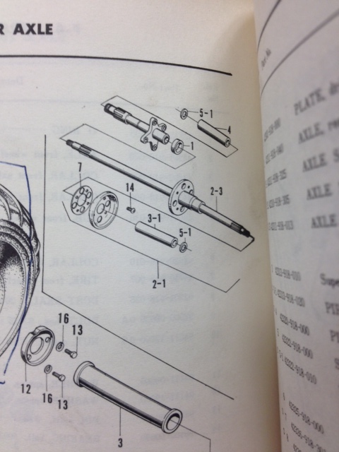

    * Rear axle made to be removable for transport by removing right wheel and spacer and sliding axle with drive plate clear out left side of sprocket/drive assembly. No spacer used on left side
    I really think there were tubes on both sides of the axle.

    With regards to:* No decals used on front or rear fender.
    I am under the assumption that Honda was calling the unit a US90, and not an ATC90 until some time later, so it doe's not seem reasonable that they were using decals that said "ATC90" in the beginning. Your photo of the decal show a very unusual rear fender with metal rivets along it's complete outer edge, quite a divergence from anything else Honda ever made on trikes or motorcycles, so I am doubting it is an original fender without rework.
    With regards to :* Rear axle made to be removable for transport by removing right wheel and spacer and sliding axle with drive plate clear out left side of sprocket/drive assembly. No spacer used on left side.
    The left axle in the picture supplied appears to be a solid weldment, not a spacer! Is it actually a spacer?

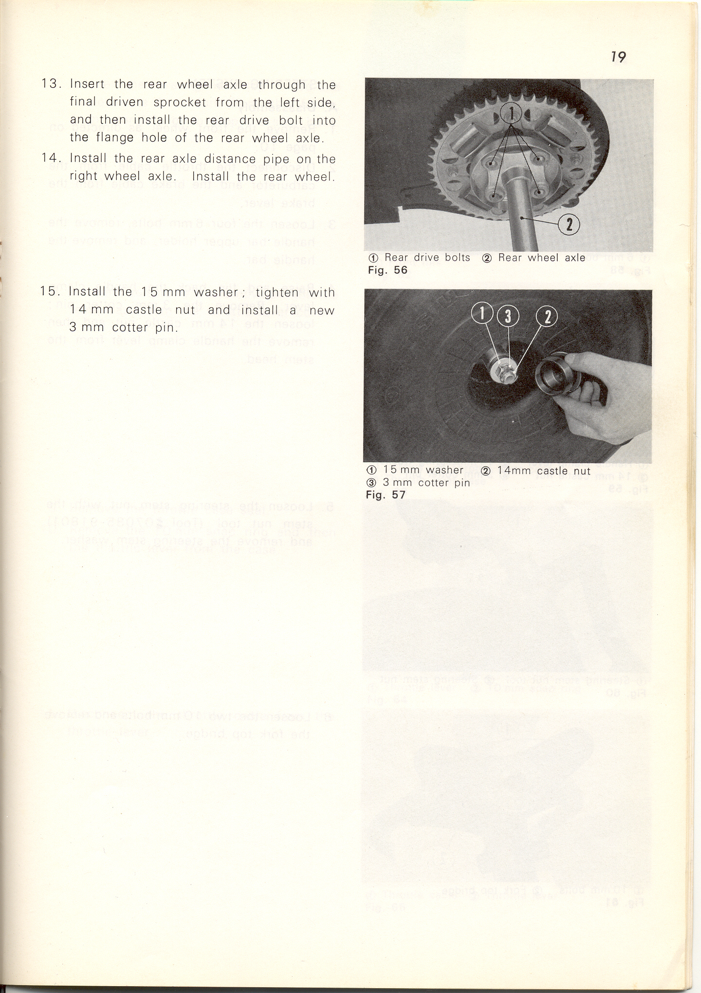

    As for transporting, the instructions in the "Riding the Honda ATC" manual dated 1971, list two ways to deal with the fuel for transporting: 1. Drain all gas through the carburetor drain until empty, or 2. Drain carb, seal off the tank with the optional fuel tank cap.

    First of all I’m no expect with computers or programs, but I can scan a couple pages maybe to show from the manual its 33 pages. Believe me when I say “Honda’s” attempt at top quality shop manuals back then where fairly basic, no engine repairs noted either reference you to a CT90 Shop Manual. Not one picture of the complete bike as an overview, all close ups of the particular subject for explanation therefore no seat/fender view of any decal or rubber heal guards. Page 20 shows no “on/off” gas cap although I know it was available on other Honda models such as ’68 Z50A Mini Trail’s and newer as I have taken the cap from my ’72 Z50K3 and used it. Frame neck only painted to just behind the gas tank rubber mounts. Could only find two pic’s of axle left side and looks to be no spacer used as the 4 drive bolt hub is angle cut and pressed on the axle and appears to look like the smaller shaft diameter than later models with sleeve/spacer. Having said that those parts being new the metal colors could blend well at the joint and after looking at my early axle shaft pic’s you can see the different metal discoloration. Sleeve is rosette welded next to the outer splines keeping it from being removed. Last page 33 showing wiring diagram lists headlight and taillight as optional parts. Did find one picture of the grab bar (carry pipe) with no taillight installed and of course no headlight pictured anywhere.

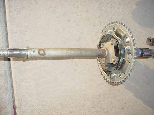

    couple pic's of my early rear axle
