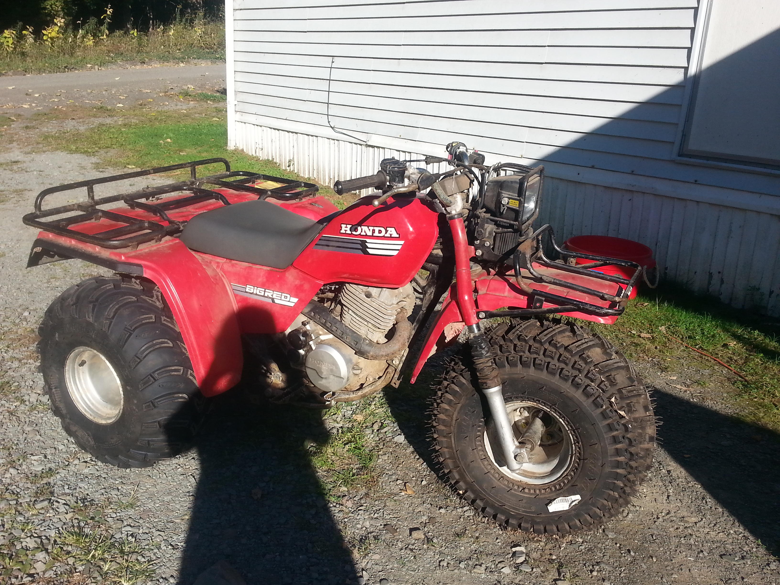

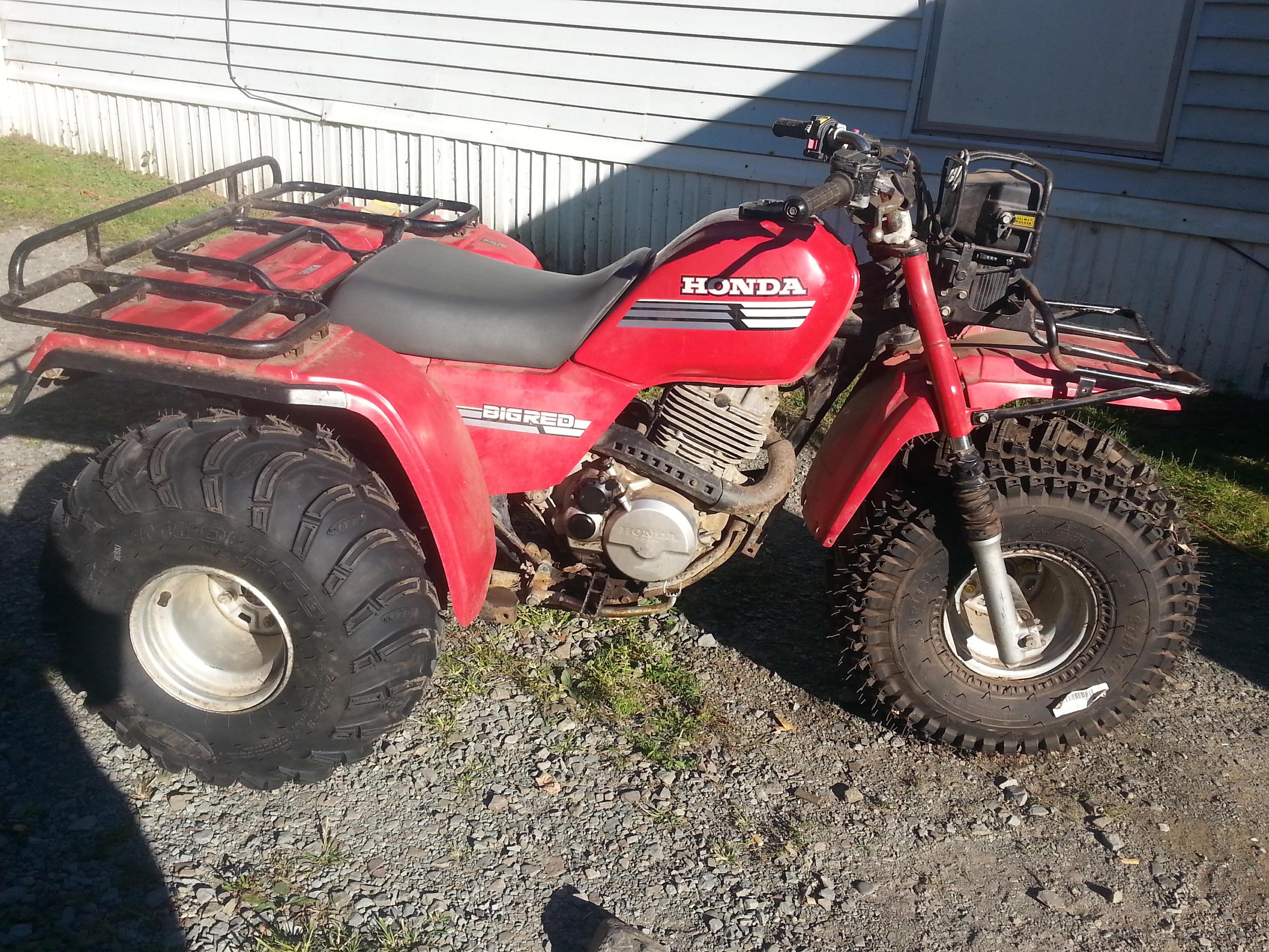

    Got it running today. Took it for a short test ride and all seems ok. It doesn't run flawlessly, but it's close.
