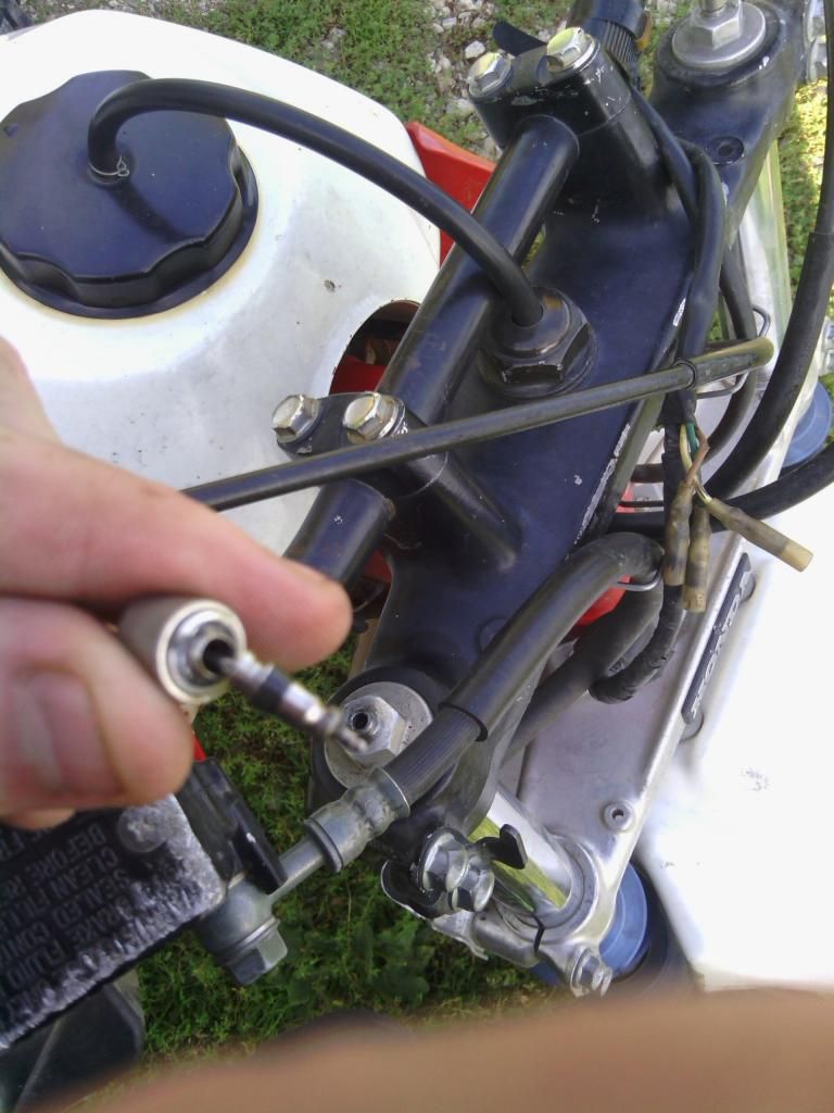

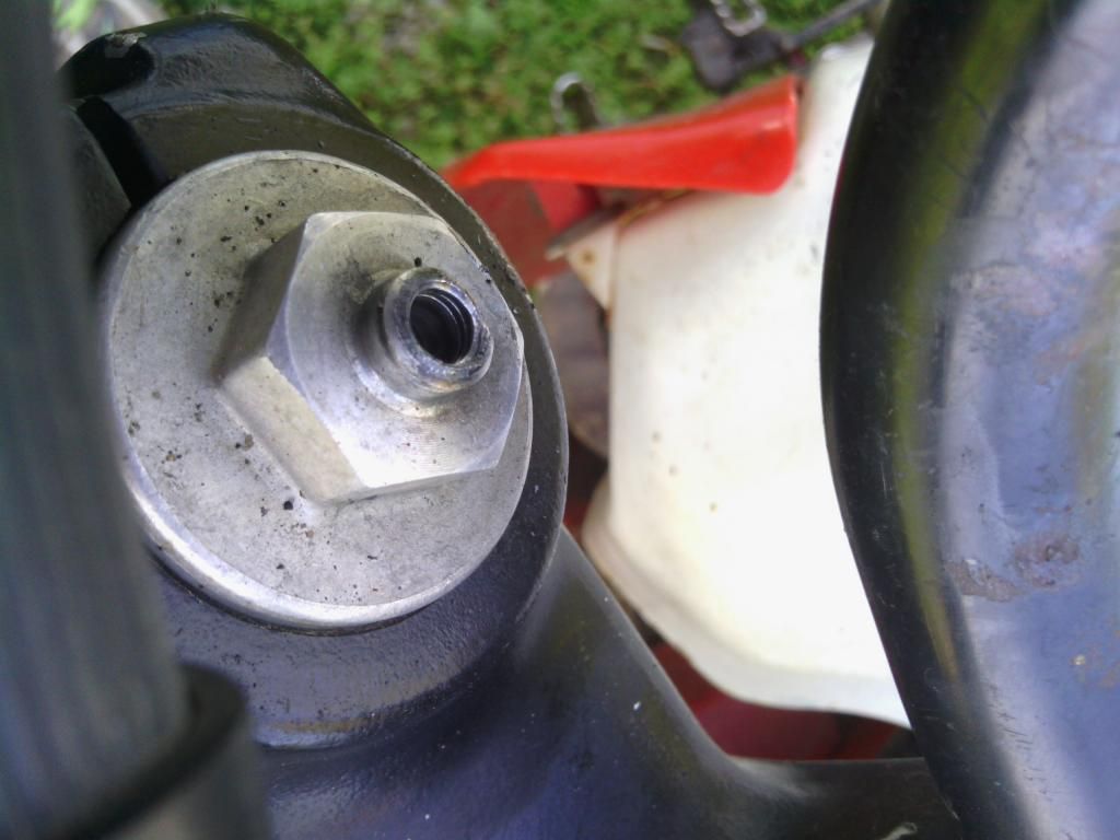

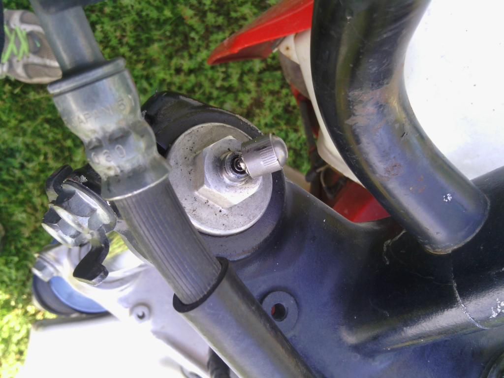

    so i finally got around to checking out the 3 wheeler today. front breaks no longer work that might be what was leaking out that we though was oil handle is bent but still works, clutch side is fine just have to re adjust every thing to where it was comfortable to grab again. and the top of the shocks there's some air valves the 1 on the break side broke.. how can i fix it? also i'm gonna need to rebuild the shocks, they needed it before this but are way worse now anyone have a write up on that?

    Sucks about the fork valve stem getting broken. You either need to replace the bolt, or cut off the valve stem and weld another on. Biggest thing is finding someone willing to weld AL.
    I checked http://www.partzilla.com/parts/searc...ORK/parts.html
    That part is long gone from honda, but I wonder if #13 would work to replace it, if you don't need charge the forks (air pressure).
    Also, the oil you saw was probably the fork oil, which would make it ride like crap in the front end.

    ...the top of the shocks there's some air valves the 1 on the break side broke.. how can i fix it?
    To fix it, remove the fork cap, drill out the cap to the appropriate size, and install a metal valve stem. When fixed, it won't look identical to left fork cap, but it will function the same & get you back on the trails again for less than $5.
