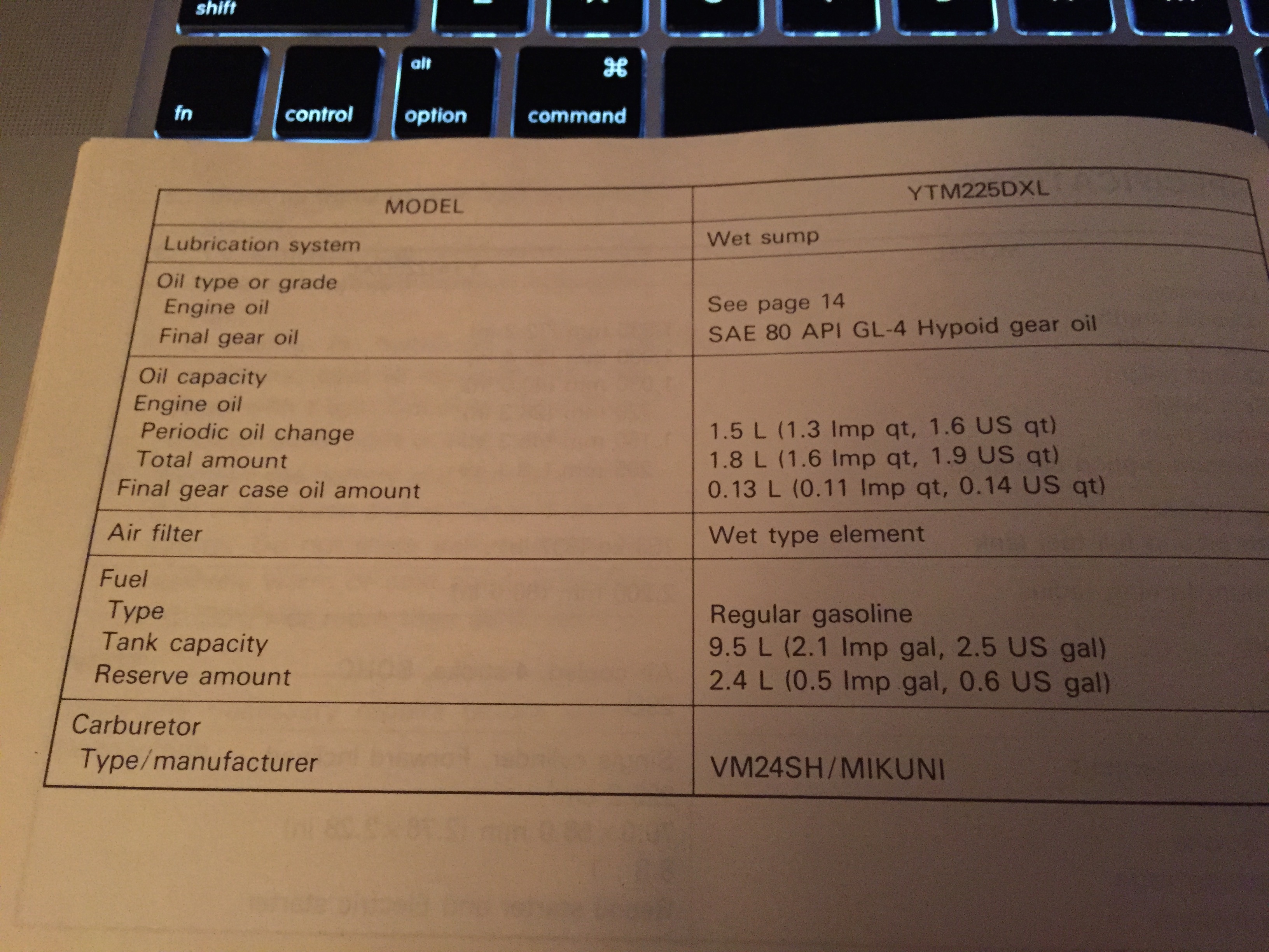

    Its a Mikuni VM24SH
    Owners Manual
    Anything else you need while I got my owners manual out?
