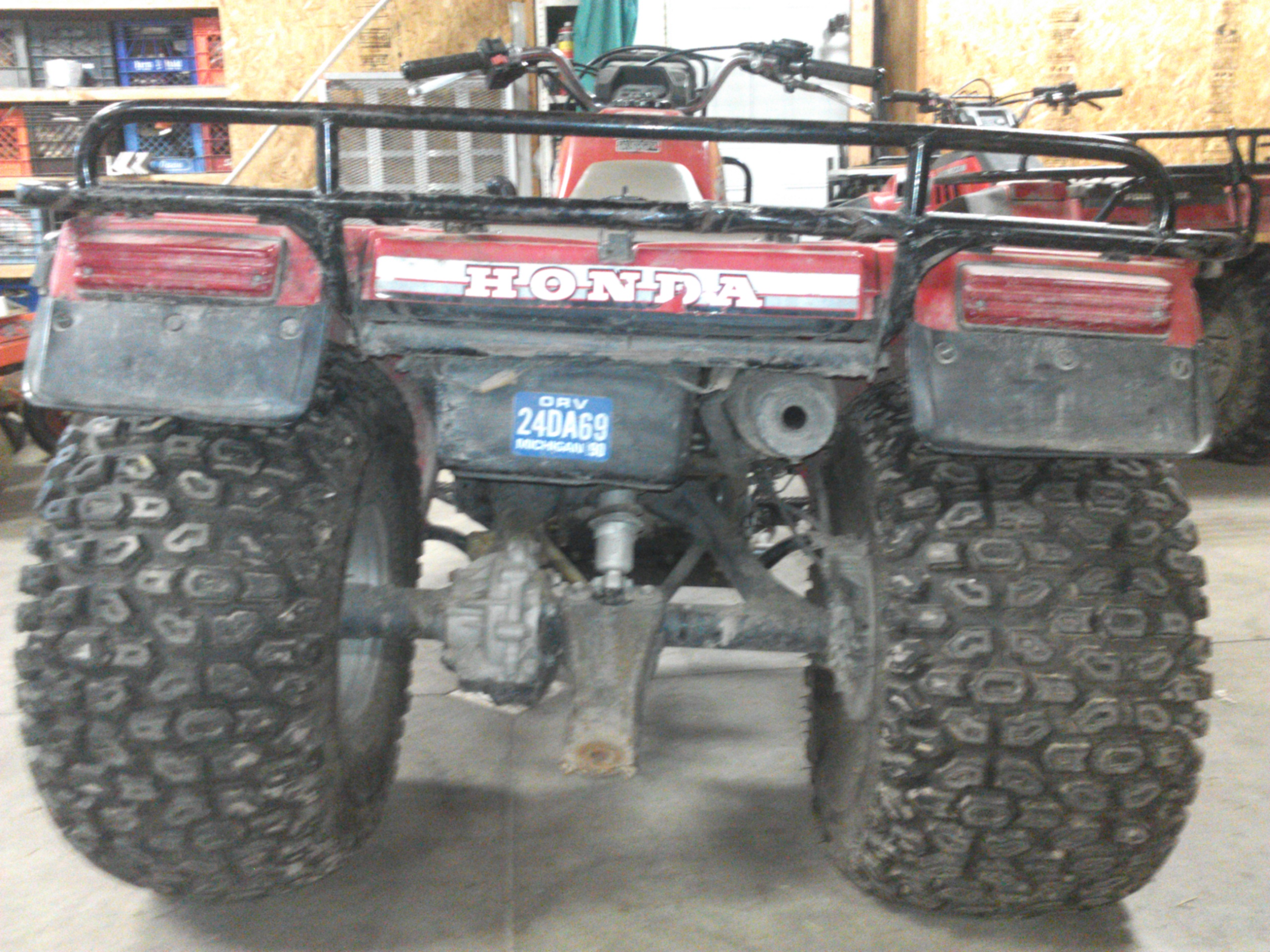

Pictures or it didn't happen.![]()
Nice score, thats 300$ worth of rubber alone.
There is one in similar shape over by me for 650$, he has come down quite a bit. I might go over with some cash and make him an offer. I've been looking for a SX but...
Thanks. Im stoked with it. When I was younger I had a bigred 200es I loved it then. When I seen this one I had to have it. I had an SX back then to. I broke the big red in half at the forks, When I came to red was in 3 pieces, handle bars, forks and the rest held together by thoatle and brake cables. Moral of the story is dont ride a big red like its an SX lol
