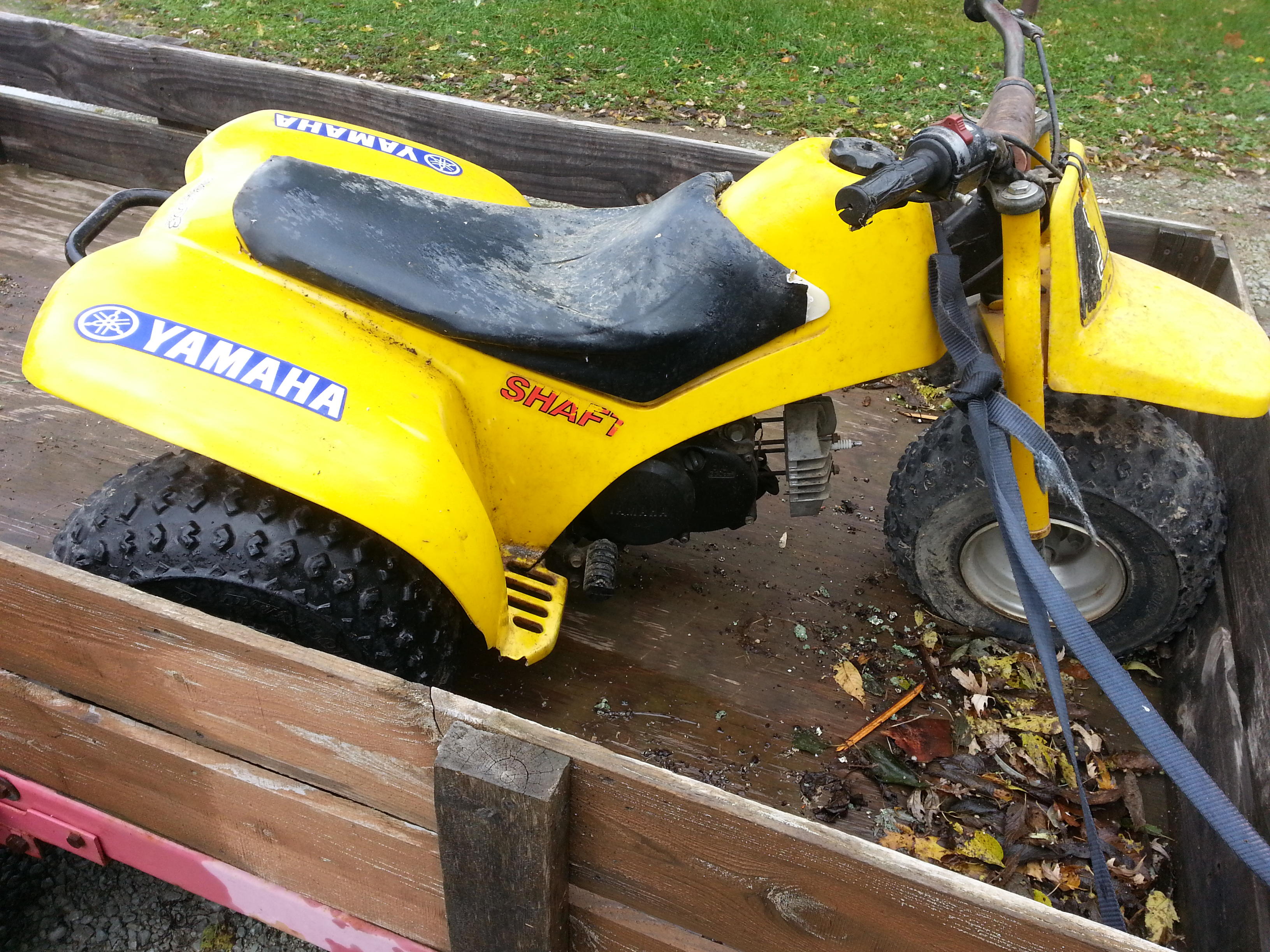

    Picked up this little guy today for free! It's missing the jug and piston and could use several other parts. I read a thread about buying yamaha motorcycle parts since they are cheaper, could anyone let me know what is a comparable model to this and if it is practical? Tag says it is a 1984. My 250 and 185 still need work but i couldn't pass this up!

    A lot of people on here are running these kit and love them. I don't have one myself but will soon enough.

    Thanks for the info. Any idea of what this bike would be worth in good running shape? That would be with this new top end and maybe a dg exhaust.

    Looks like it has some great potential. Price was awesome too. I recall the front fender is one of the hard to find items.

    Front fender is not too hard to find on a zinger. The Suzuki ALT 50 front fender is the hard one to find. If that thing was running, I would pay $300 for it

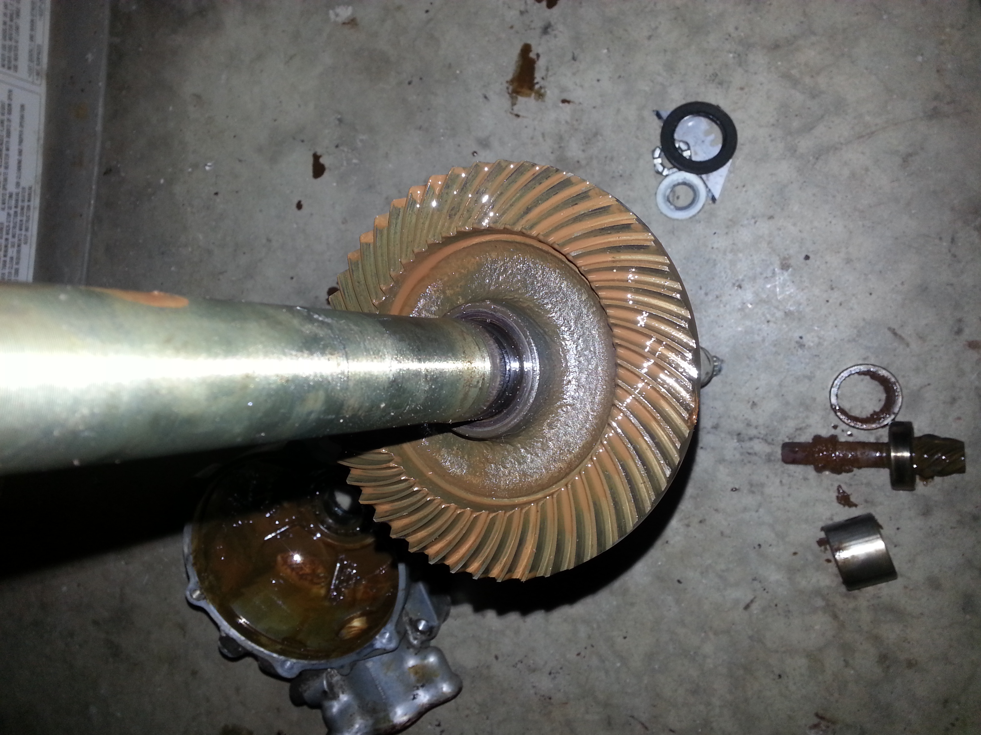

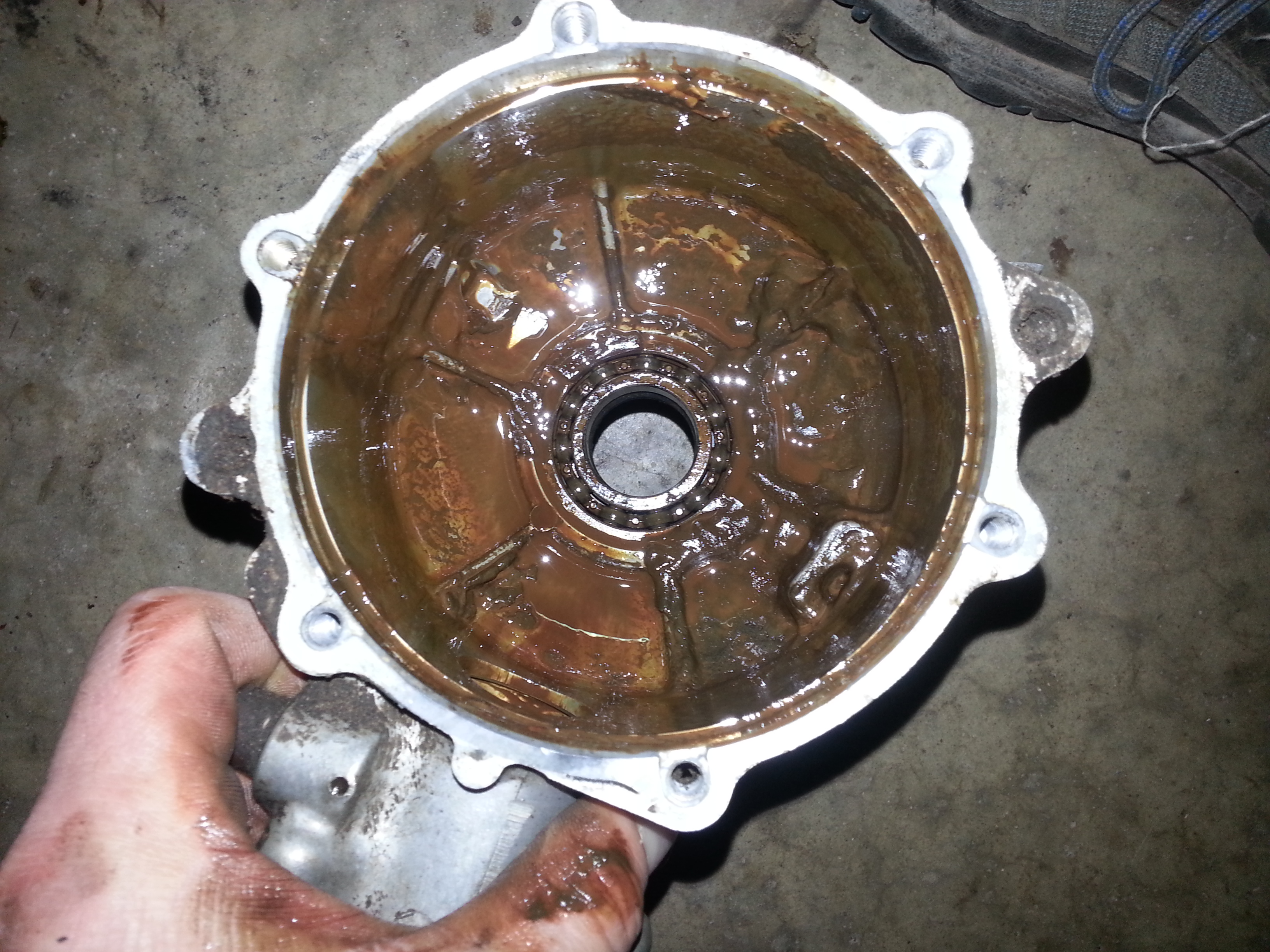

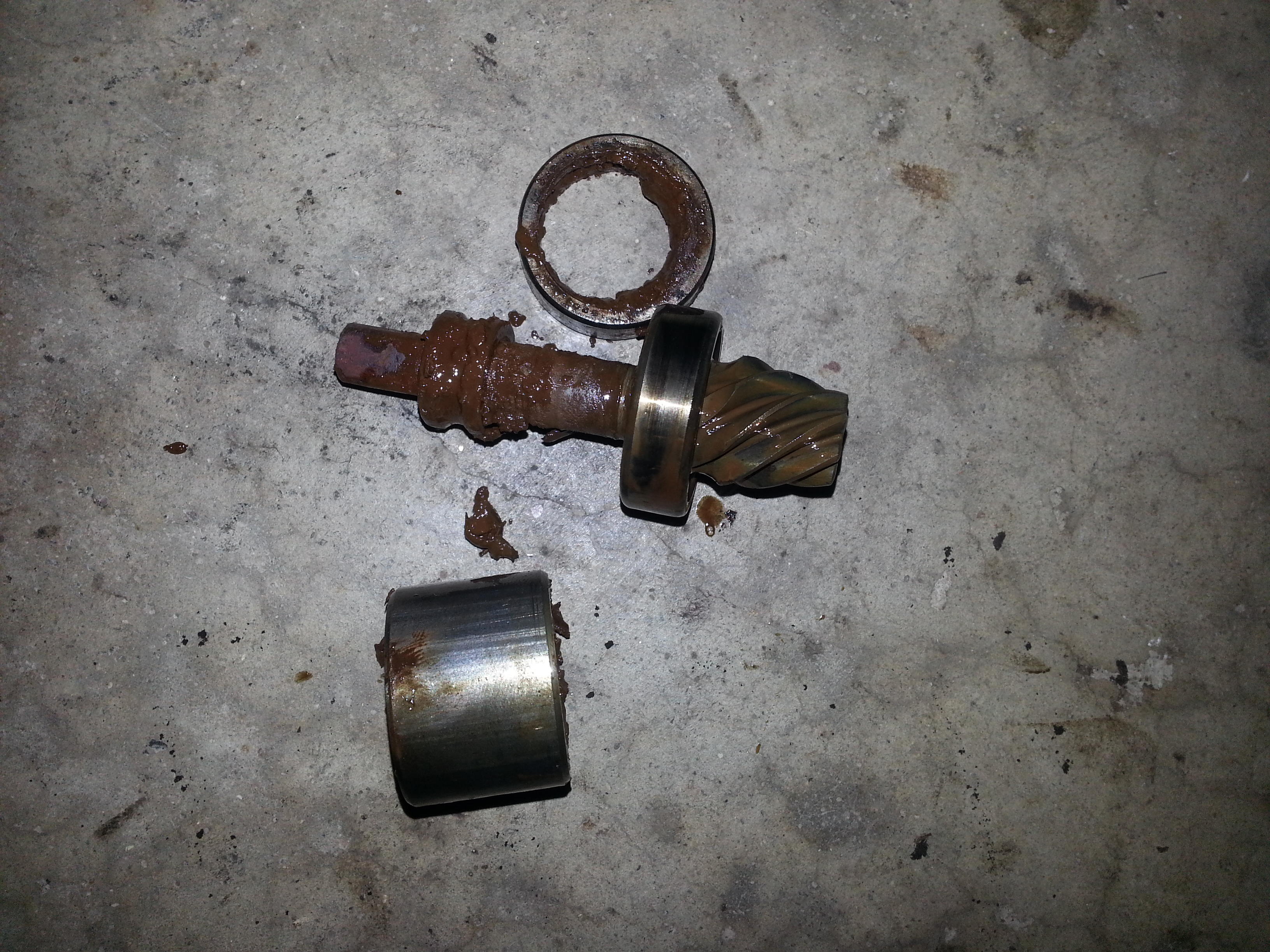

    Got the rear end torn down. Used a 22mm nut, heated, wrenched, then bingo got the main nut out of the housing. Here are a few pics of the inside. Water definitely got in there at some point.

    The gears seem to be ok but I am going to replace all of the bearings and seals. Allballs has a kit on Ebay that I think Ill snag it. One of the bearings on the short gear was completely shot.

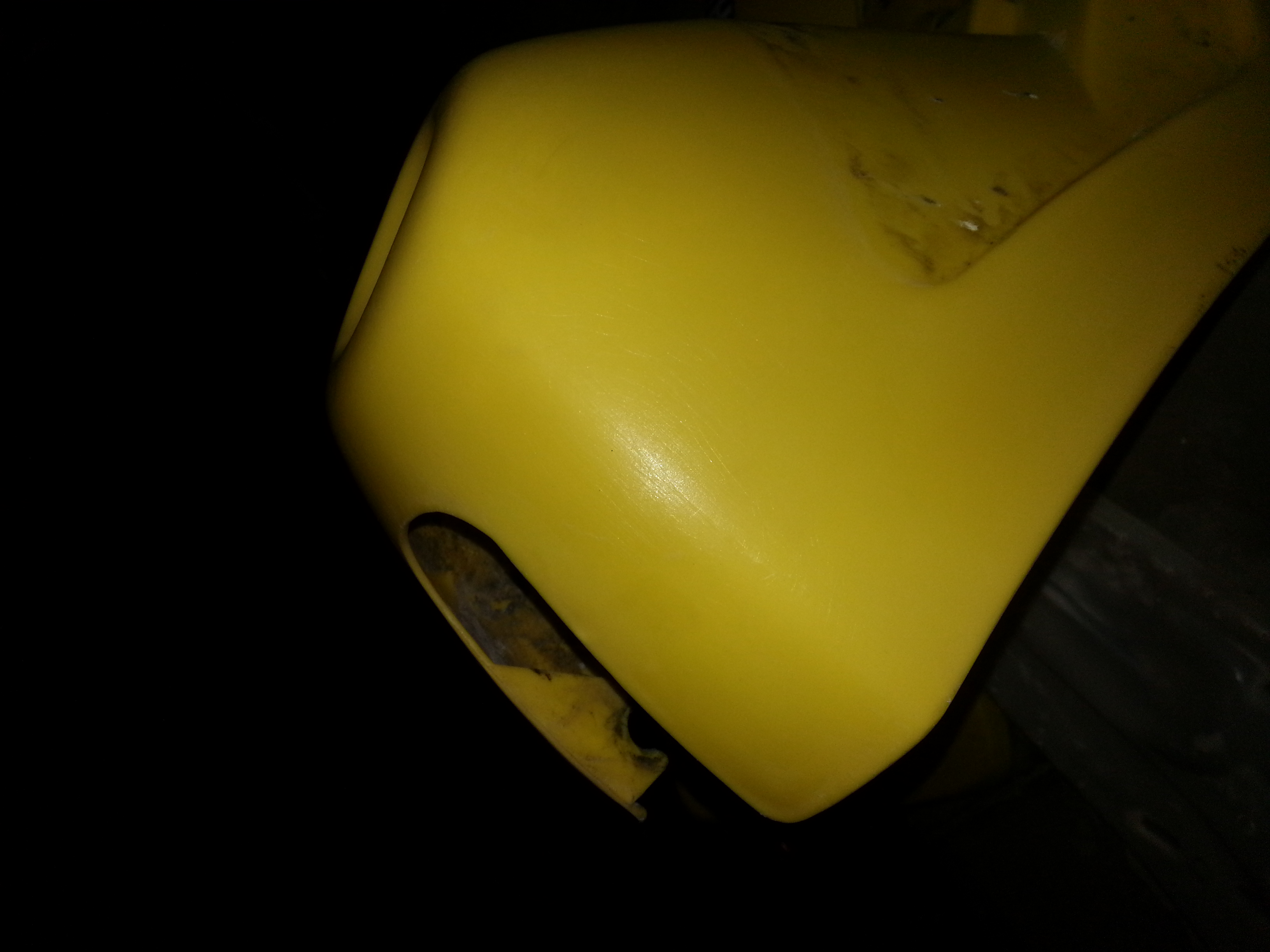

    Side note…has anyone used Softscrub on plastic? I was in Autozone tonight and started grabbing sandpaper. I asked the old fella working if he had done any plastic work. I explained that I wasn't needing an overhaul just a clean up. He said that he had good luck with Softscrub. I got home and pulled the bottle out and it worked well!!

    A previous owner tried to sand it with a higher grit than they should have (seen in pic 1). The entire plastic has the light scratches on it and I did not make any! It seems to clean up nice and I think that Softscrub would make a nice clean up for the future. I plan on refinishing the plastics at a later time.

    That rear doesn't look too bad, gears look nice too. Go with the allballz, they are a good replacement.
