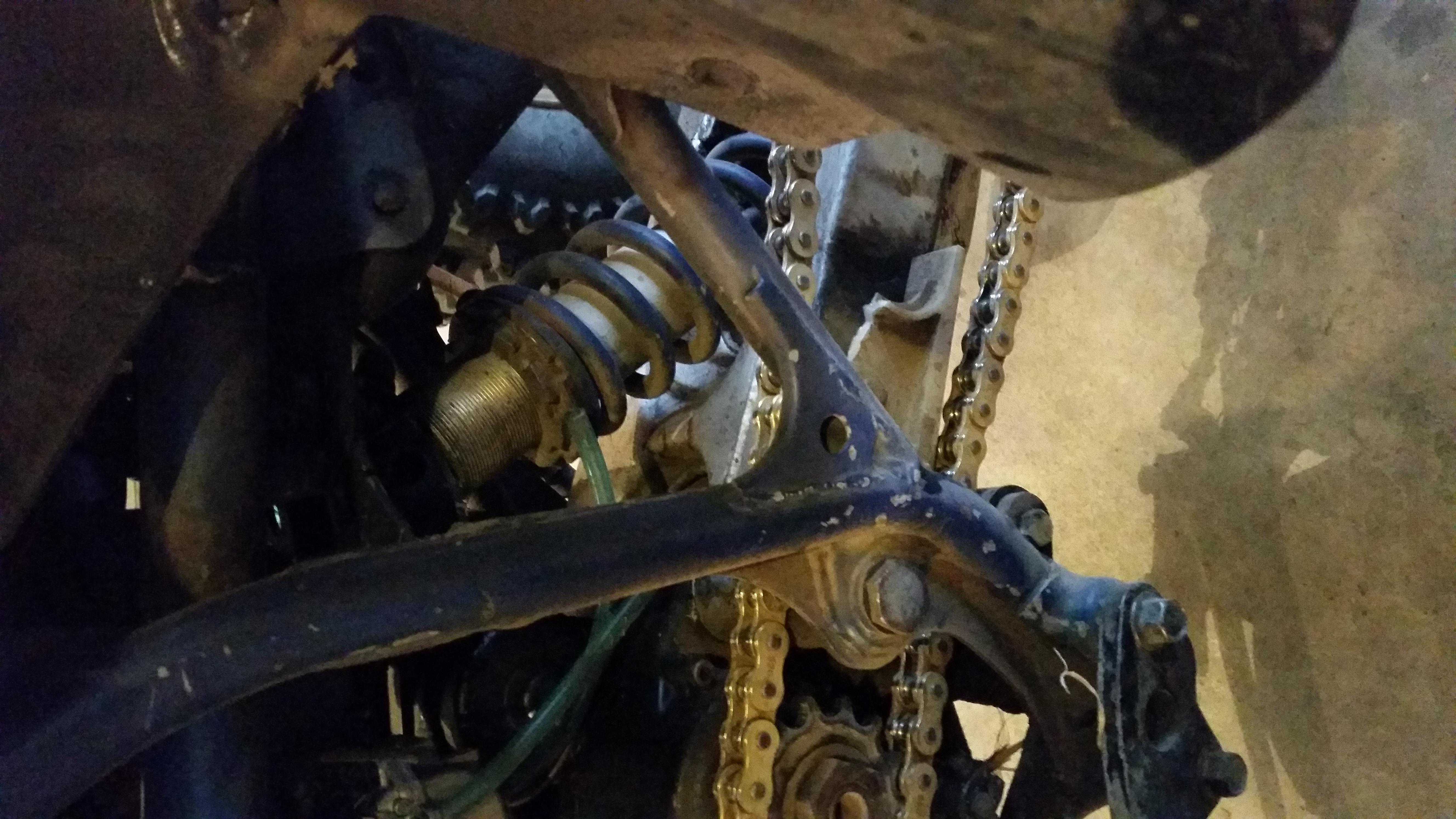

    This is what I'm dealing with. The one in the yellow frame is the good suspension.
    I had no idea that the suspension would make it jump all over when I get into the top end. My 250r suspension is bad too but it doesn't do that.

    yeah that's one of the problems with the shock they used, not cheaply rebuildable and very expensive to replace with a duplicate.there are others that can be used a warrior shock I believe is a direct replacement, and there are some others. I just did my swing arm bearings and races this spring. the only advice I can give is to take all the excess weight off before you start, will make it much easier to do. Also you might have to use a to slide it back into place. I have a complete banshee swing that I am going to modify to make as a swap out for my oem in case something happens to my original. You should try and make it this way we have one of the best atv parks in the area here. I have a few vids on youtube of some of it. here's one of them.
