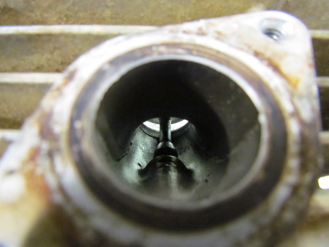

    It slid out easily. The hole is not egged visibly. But as my luck would have it, there is a tiny fracture on the part that sticks out. Very hard to see, but sure enough it is there.
    What is the worst that could happen if I just put the new valve in and go on, I may have to replace the head later if it wears the valve loose? (which is also the fix for a fracture of this nature anyway right?) The fracture is only along the lower edge, maybe 1/4" long, and there is a lot more surface area to guide the shaft. Except for when a big goof (me), gets the timing out and smacks the valve on the piston, there is no lateral pressure on that shaft correct?

    Pics of fracture please. Sounds like valve guide maybe damaged and at that point do not just throw another valve in . You will be right back where your at now.

    This is as good a view as I can get, fat camera lens and flashlight won't go in there at the same time.

    new guides are available from Honda, what's 14 dollars when you've done all this work?

    I've personally ground away 20 times that much guide porting before. I would do just that. Dremel it down to where there is no crack,smooth,deburr,ride. Just "buying " a new guide doesn't fix this problem. You need it pressed out and back in. Aligned and regrind the seats. Turns into $200 in a hurry. If you get rid of the crack. She will go for another 30. Most will disagree,I will guarantee lol.
    Never heard of anyone doing this, learn something everyday
