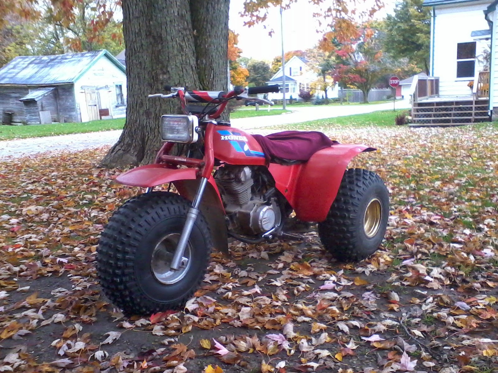

    I used 250r hubs for mine.fits most my rims. Actually have the 250r ones on atmClick image for larger version.
ID:	209692 and ya its a 200s front ATM gotta save money to rebuild the proper one
