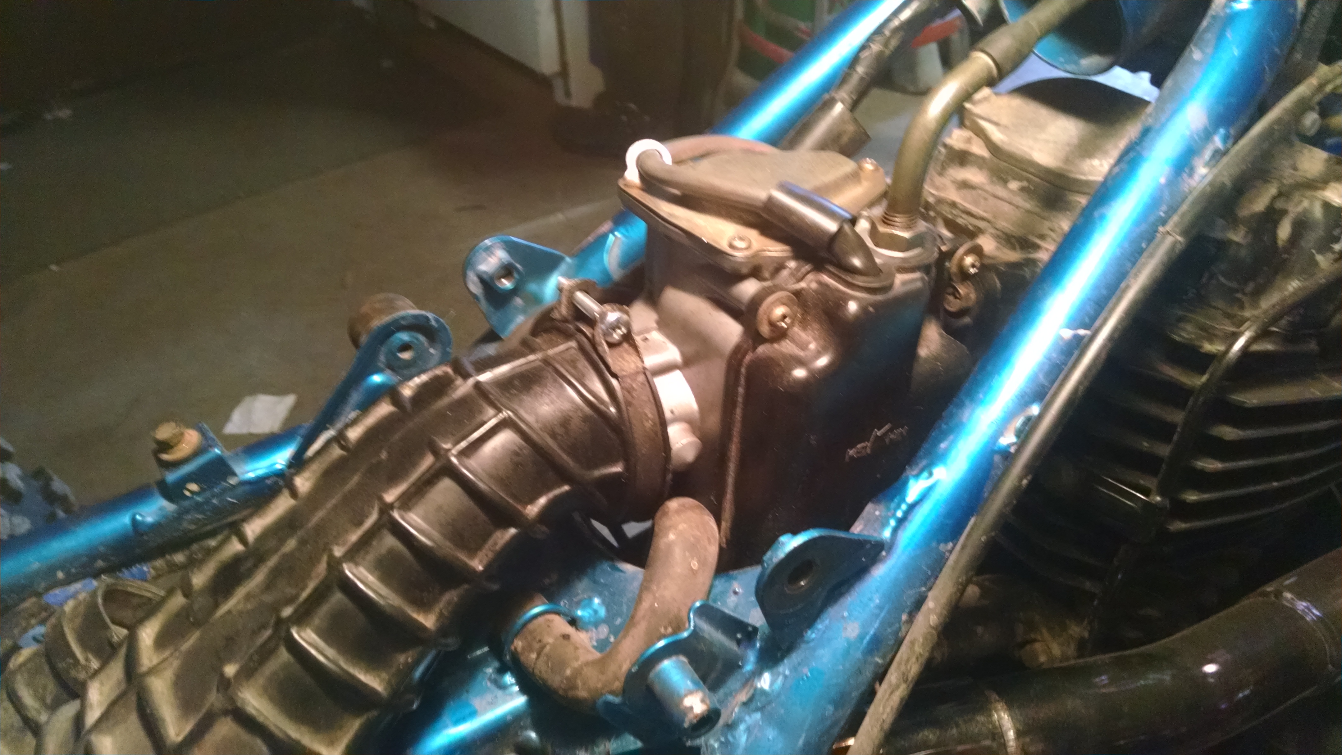

    Well, I got further with it than I expected to tonight thanks to the terrific hardware store I have just two miles down the road.
    I was able to get the carb into the intake and airbox tube without heating them. The airbox tube was more stubborn though. I did need longer clamp screws as the originals were just not long enough with the larger carb in place. That's where that hardware store came in, I can't tell you how many times I have gone there taking a shot in the dark that they have some obscure little thing I need and they have it. Anyway, you will need 5x30 metric screws for the for the intake and airbox tube clamps and you will be all set.
    As I have seen others say, the pipe that connects the airbox to the frame should be removed or modified so it doesn't press up against the choke on the EX carb. I opted to remove it as I removed the same piece from both of my 250r's and don't have a problem. You just need to be a little more frequent with your air filter service, especially if you ride in dusty conditions.
    All I am waiting on is the choke lever I ordered last night.
    From what I have been able to gather, stock 400ex jetting is 148 main, and 42 pilot and have seen some say that stock 400 jetting is very close, but maybe a pinch lean on the pilot. Since this 350x is running a full DG exhaust, and K&N filter and now has the pipe connecting the airbox to the frame removed, I opted to start with 150 main and 48 pilot, 2 turns out on the idle mixture screw. Remember, on these carbs the idle mixture screw regulates fuel, not air.
    Despite not having a choke lever, I was able to fire the ol' girl up with her new carb. Started pretty easy, and I think the accelerator pump on this carb will be an asset for easier starting. A couple pumps of the throttle and it fired right up. Remember, this is my wife's ride and up to this time I have always had to start the thing for her hot or cold. Hopefully the accelerator pump makes it so she can start it herself.
    I did not however take it for a ride. I had a friend with a 400ex and for some reason his choke lever fell off and the engine would suck the choke butterfly closed while riding without the choke lever in place. I'll save the test ride till I get the new choke lever.
    So in closing as far as how it sits now, this was a pretty easy upgrade in my opinion. From all accounts I have read it is a very worthwhile upgrade to the 350x.
    Will follow up with a test ride report and any jetting changes I make if needed.
    Pics of the carb installed.
