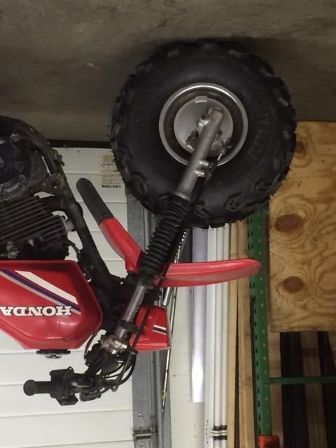

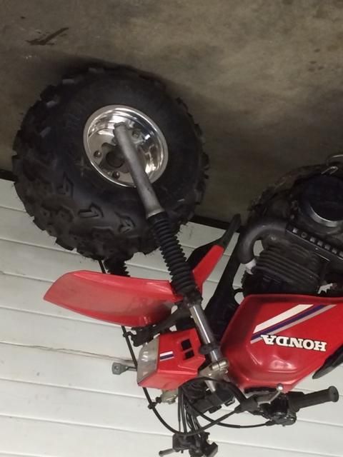

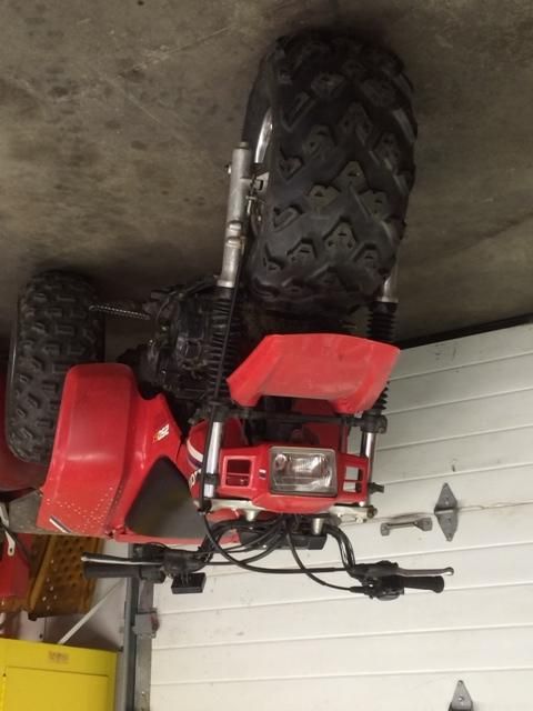

    9 with a double stack of spacers is what I ended up doing. Mechanically not ideal but it got the job done.
    I believe the offset on this is 3+5

    Awesome. Thanks for the pics, that looks great!

    What size tire are you running on the front Dave little?
    22x11-9 STI diamond back it's called. Very very close to rubbing but does not, the rubber whiskers do however. 3mm clearance on both sides.
