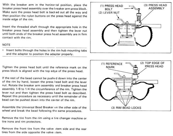

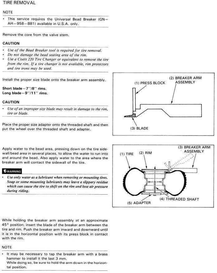

    I have a very similar tool to this one, but not this exact one. I was going to pull the trigger on that one, and then I found the official Honda bead breaker tool on e-bay (the one that they describe in all the service manuals in the tire section)
    The Honda tool works on the same principal though. You have a press-block which pushes on a foot which is clamped into place. The way that the press foot is clamped into place, it prevents if from flexing out and pushing on the sidewall of the tire. These tools are locked in and push directly on the bead.
    I used to have to always pay the tire shop to break down my tires, now I am self sufficient.
    I'll post up pics of the official Honda tool when I get home tonight.

    Here is the Honda official beadbreaker from back in the day. Keep your eyes on e-bay, they come up from time to time.
    Here is how it is used (from the service manual tire section):
Name:	Instructions Page 1.JPG
Name:	Instructions Page 2.JPG
    Last edited by wonderboy; 12-09-2014 at 09:11 PM. Reason: Put instructions in proper order
