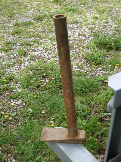

    You mean one of these?
    My dad has one of them, broke down 500+ tires with one similar with a wooden from my grandpa's place when he sold his house. Hell of a lot of work, but fairly quick if you are good. The semi sized tires is where it really shined though while the normal tire press style one did better on smaller car tires. ATV tires have always been a bit of a fight though, the little bead breaker linked above might be a good investment.
  15. #30

    Neat video. very similar process as what my dad uses. The tires I talked about before were OLD and have been sitting around 10-50 years. All of the semi sized tires were the ring style where you have to break the bead down, remove the holding clip and pull the ring up to slide the tire off the rim. Royal pain when everything is rusted up. Tool looked almost exactly the same as my dad's except it is probably 20+ years old, just a basic wood handle, but the same head.
