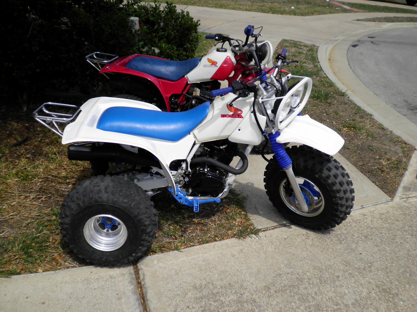

    I remember when the 200X came out. Made the hardtail suspension conversions (like my fully suspended 185s) obsolete overnight.
    Working the 200M like you're talking about sounds like fun but you'll be ahead in all ways ($$ and performance) if you just buy a 200X.
    That said, an easy engine swap is one of the Chinese 200CC engines. They run great and just about bolt in. I put one in a 200X. Others have put them in hardtails as well.
    This X has a 200cc OHV Loncin in it. E-start. Manual clutch. It would walk all over my stock (tired) 200X.

    I bought a compelte 200CC dirt bike for under $200 to get the engine. It took 6+ months of watching Craigslist to score the great deal though.

    was the sprocket align with the rear one? i've seen build where you had to buy what they call a "wonder sprocket" to make it fit?
