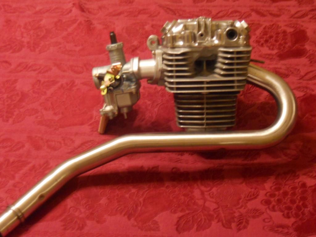

    I've decided to go with the TRX pipe. I'll have to tighten a few bends, cut it in one place and rotate it 180 degrees, re-weld, and that is just the head pipe.
    I've done a LOT of thinking on this: Since I have the ability to regulate the back pressure using the Super Trapp setup, the only other variable would be to tune the exhaust for a specific resonance.
    For example: depending on the RPM, head port shape, exit diameter of the port, pipe sizing after said port, and speed of the negative pressure wave that follows the initial exhaust pulse.........and cam timing; (do you see why I'm just going to go for it) ?
    I am convinced that I have nothing to gain, by keeping the header pipe sizing to what other aftermarket companies determined to be "optimal". That specific size may have more to do with getting it to clear the down tube, than it does a "best size" for said engine.
    Just a thought.
    I have used their mufflers in the past, for the very reason that the exhaust back pressure, can be regulated/tuned. More disks= less back pressure. Fewer disks= more back pressure. Tuning for an exact RPM based on pipe sizing , on this project, ain't going to happen.....

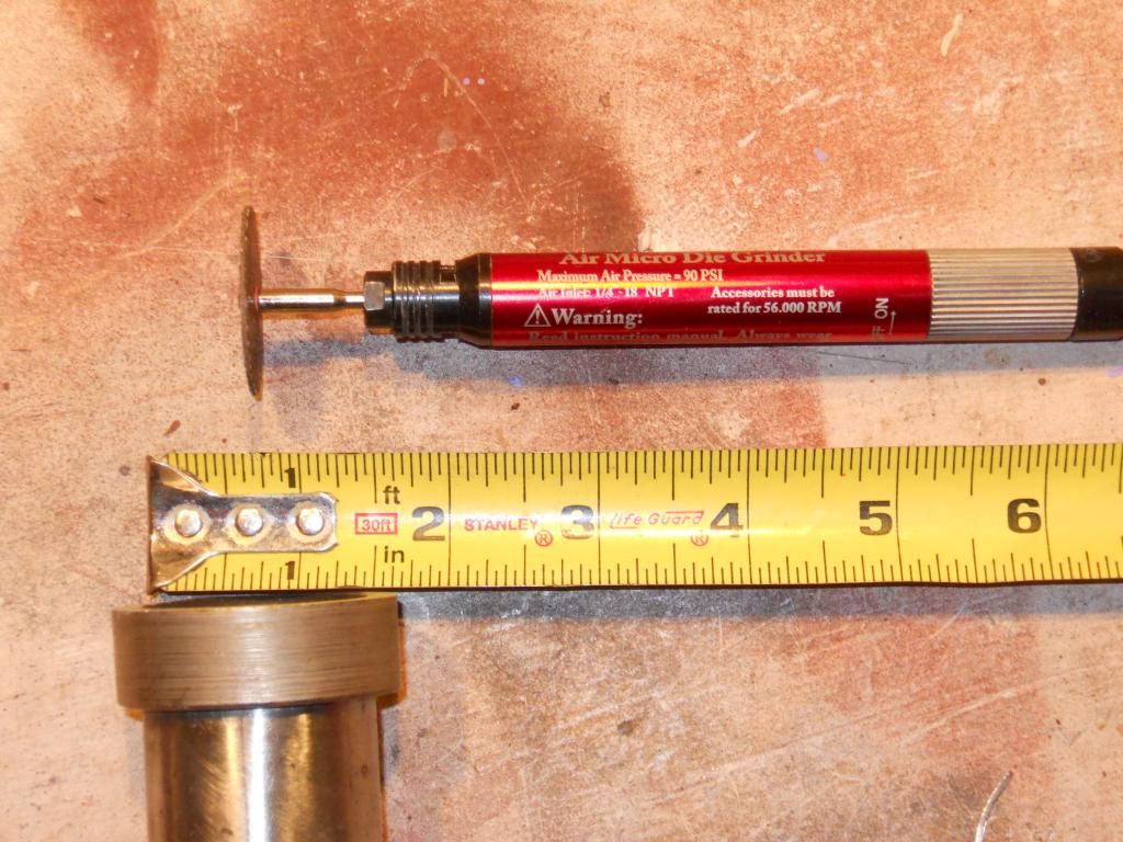

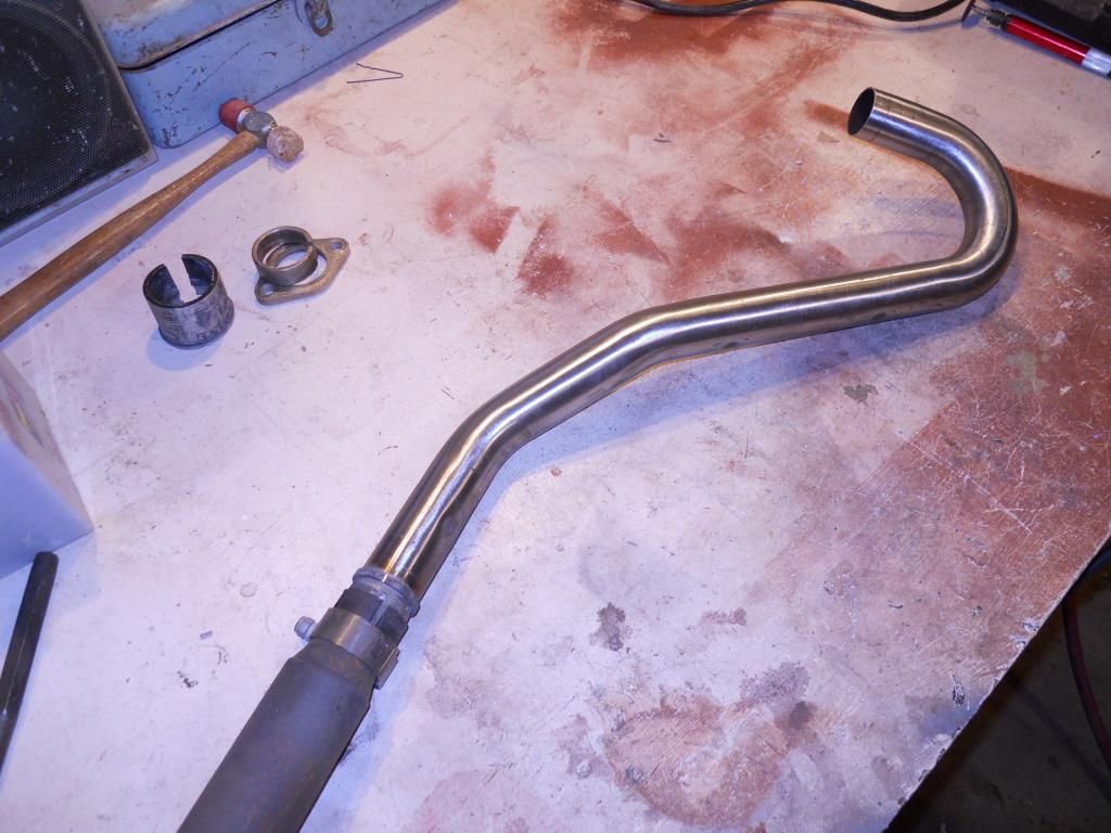

    Since I've committed myself (some would argue that I've missed the turn into the sanitarium...) to the TRX pipe, I would like to shed a bit more detail as to why. After measuring three of the 4-stroke, two valve bikes that I have, I found this to be the case: All had larger exhaust pipe ID's than they did exhaust valve size. And all had a graduating exhaust pipe diameter from point of entry, to point of exit. There must be a reason.... In addition, ALL put more power to the ground on a CC to HP basis. From this, along with the carb sizing (two of the three have 32mm CV carbs with one being fewer cc's per cylinder and one being just over (212 cc's)), it is my thought that I must be somewhere in the middle of all of this. Time will tell...
    Here is the TRX pipe, just prior to the mini-die attack:
    Here is the other reason for this specific combo:
    The TRX header is exactly the OD size that I need to combine with the Super Trapp...
    There really is a method to my madness......................

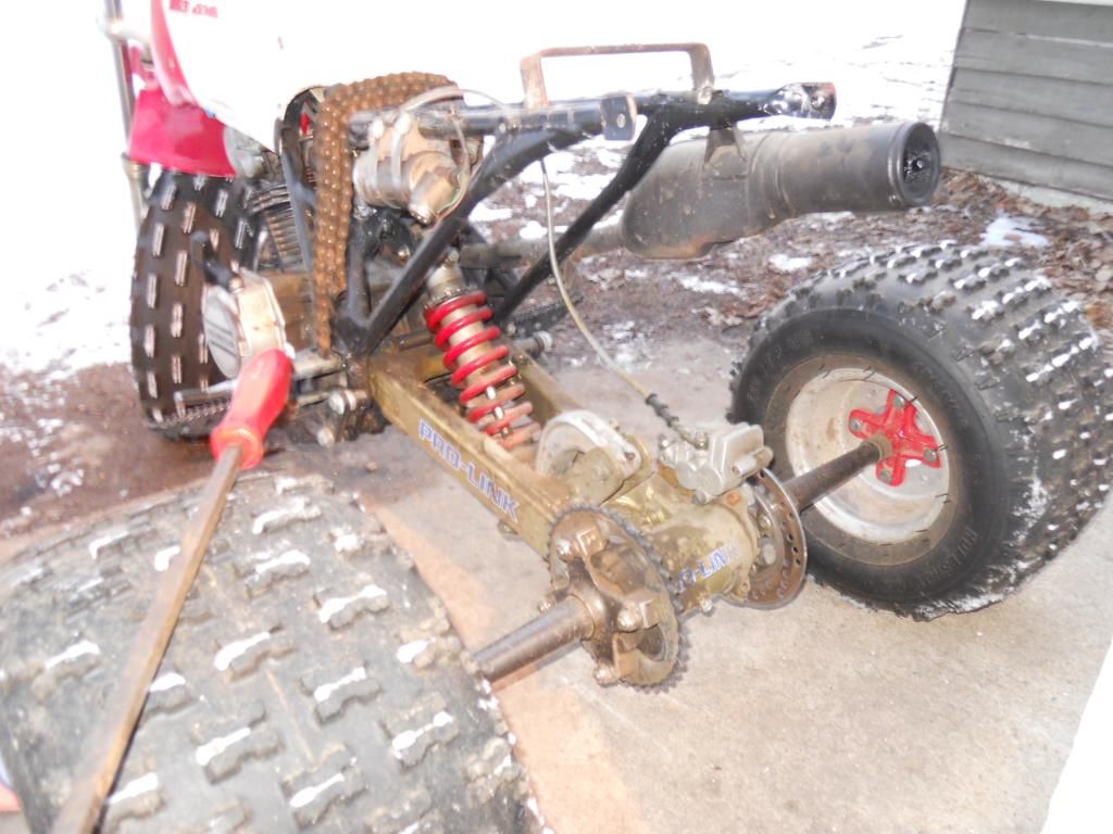

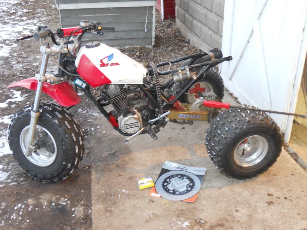

    Took the time to swap out the front sprocket (Sun-Star #12) and was running out of daylight. No room, or time to make room, for climate control.
    Thought I would show what almost 2-years of abuse and nary a shower, looks like:
    She threw her necklace at me last summer as a result of another idler failure. This IS changing. Still not convinced that I have enough height with the sprocket change, but in worse case scenario... the angle will improve = less force on the bearings...
    Sprocket size, sorted out in this thread:
    http://www.3wheelerworld.com/showthr...uick-question)

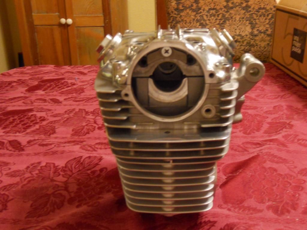

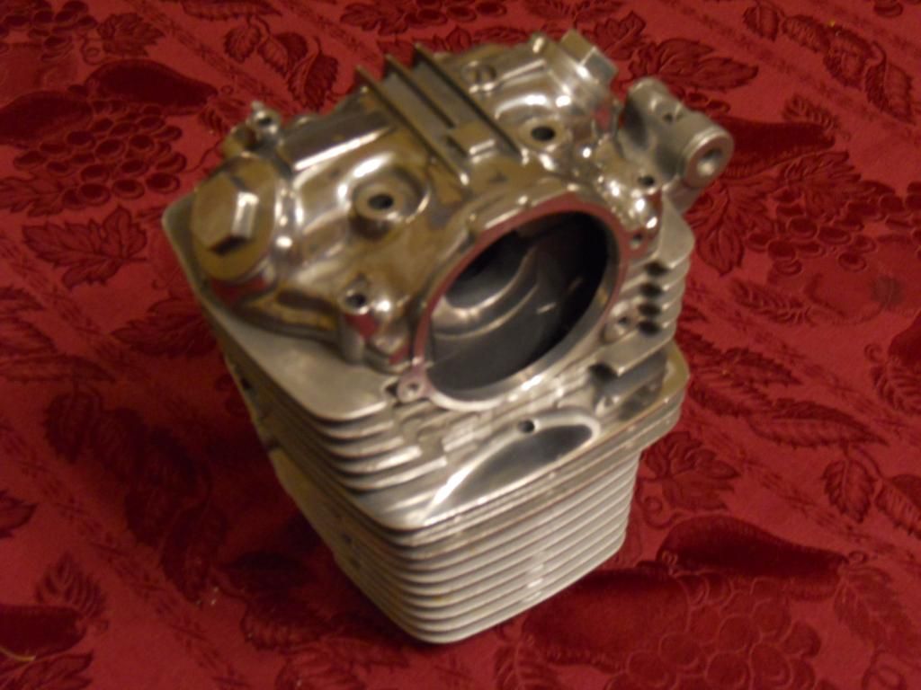

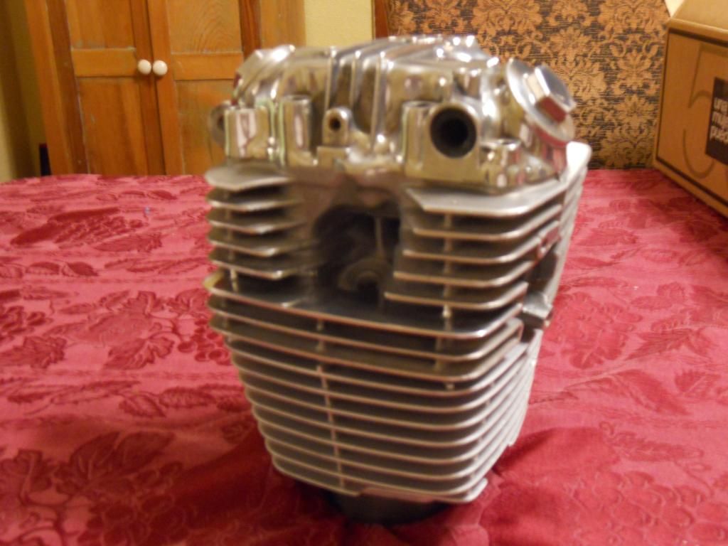

    Couldn't help myself ! I have a new cylinder on the way...
    Wanted a bit of a different "look".
    I'll have enough extra new parts to build a complete spare, minus the lower cases. Getting ready to pull the old 185 and tear it down. Time for some clean, assembly fun.

    New cylinder arrived today. Will bring a bit of a change to things and allow for even more change if/when I want to.
    No replacement for displacement, as the old saying goes...
