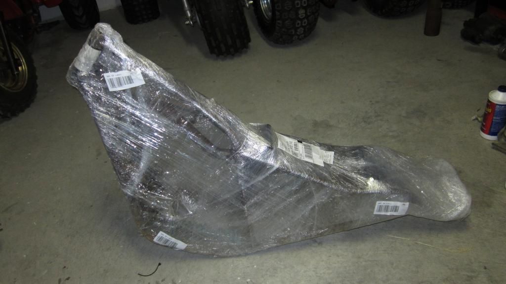

    Quote Originally Posted by Ol Deuce View Post
    The ham bone
    Awesome, cant wait to see it start going together.

    Picked clean and blasted ! Looking forward tho this build. GREAT work................

    Quote Originally Posted by Dave8338 View Post
    Thanks!! It won't be long now!
