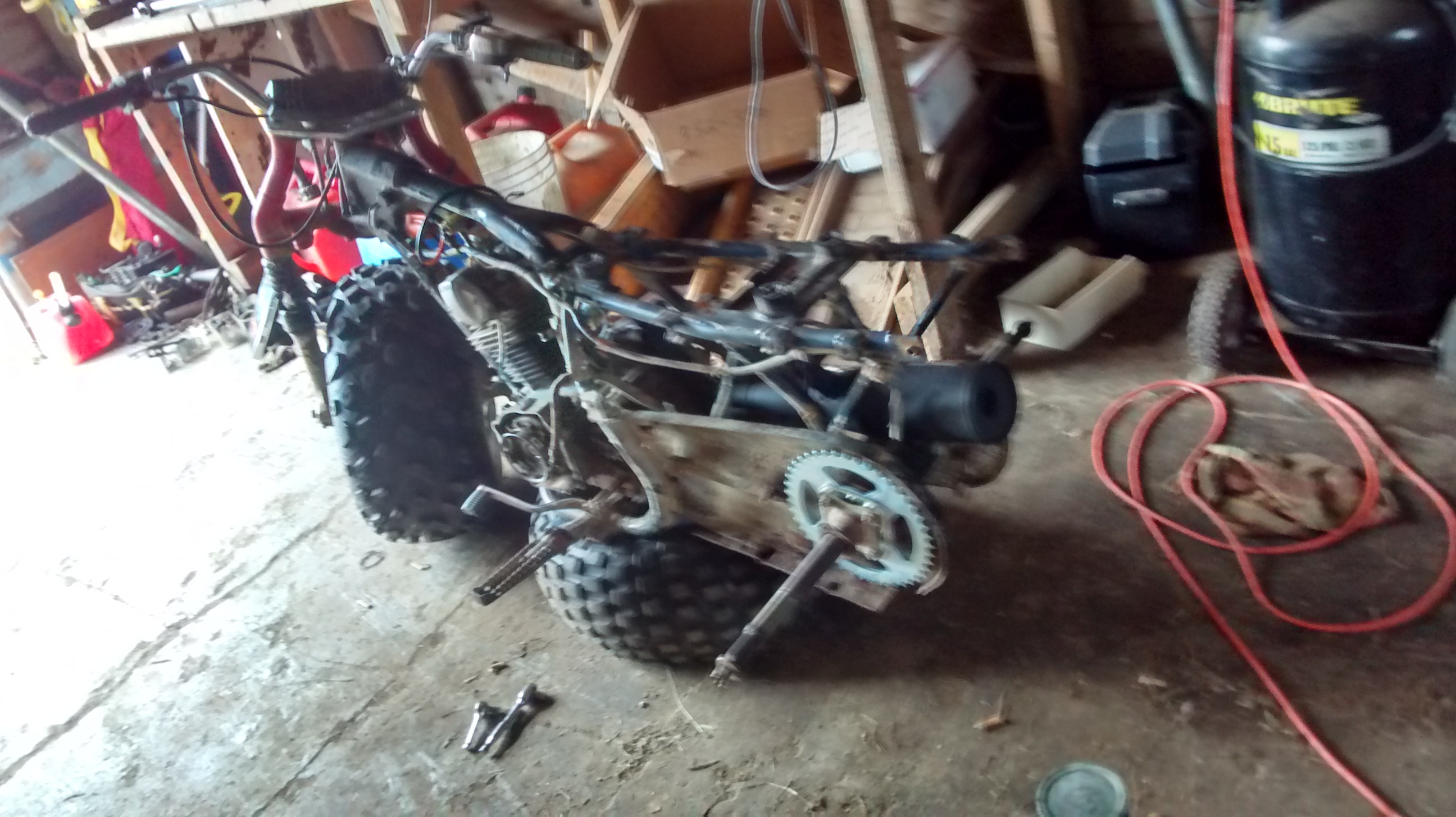

Hey guys just about finished on the 200s. Been working on it for 3-4 months now. Still have couple things to do like brake cables and seat cover and possibly through 200x forks on. As of right now new plastic, tires, complete top end with 12:1 compression, 200x carb, xr185 cam (bolts right in), DG exhaust, new clutches(steel plates friction plates and springs. She's a blast and will out run a 350 warrior with 10.25:1 compression, DG exhaust and no lid. Here's a few pics first one is where I'm at now the other two is what I started with.
