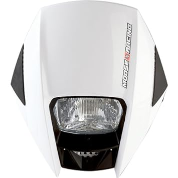

    Think I'm going to Use Moose Racing headlight to replace the missing one

    Nice find & score! I think you owe your workmate a 12'er (at least) for bringing your attention to it. IMHO, none of the aftermarket headlights look right on our trikes, so I'd personally hold out for a OEM Tecate unit. After all, the Tecate did have the sexiest headlight shroud out of all of the 3-wheelers.

    http://ecx.images-amazon.com/images/...WL._SY355_.jpg
    Thats the one I think will actually look good.
    Im torn between White Shrouds and Green lol
    I think im going green.
