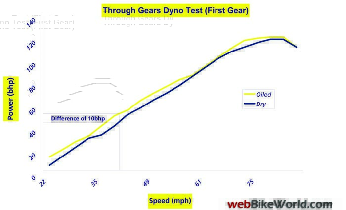

    El, as you may know, just because one dyno test may have shown only 1/5 th of 1 hp difference in the test mentioned, it doesn't mean that it is not possible to gain more than that by using different chains then the ones they tested . . There may have also been errors in their testing method . . I have seen errors in various testing methods dozens of times before . . Tests are only valid if they are repeatable, and the fact is that it is absolutely possible to "free up" more than a paultry 1/5th hp by using a lighter chain and contrary to what has been implied by some [or one] the amount of gain I mentioned absolutely is achievable in some instances.
    In addition, power can not only be gained by using a light chain as opposed t a heavier one, the lighter chain also reduces the weight which in turn increases the power to weight ratio . . Obviously the amount of change in this instance would be extremely small and therefore not worth "worrying" about in your particular case, it does exist as you know, and in some cases at Kawi such as the works MX and Road Race bikes, we actually spent a LOT of time and money per ounce reducing a vehicles weight.
    Having also seen many dyno tests, including ones we did at Kawasaki, I can say for a fact that it is nearly impossible to accurately determine the cause of such a small difference in hp because of other variables such as engine temp and dyno error and operator error etc. One thing that must be done when trying to determine the cause of such a small difference in hp is to use a sealed, climate controlled dyno room where the temperature and humidity can be controlled . . The atmospheric pressure also affects hp and it can change enough from morning to afternoon to cause a slight difference in hp, however, most dynos are able to correct the hp numbers based on the different factors IF the dyno operator puts them in.
    I have seen several cases where a dyno operator simply entered incorrect factors which were then shown on the dyno sheet . . This is actually not a big problem if one is only using the dyno for a comparison test between different parts or settings, however, if the same bike is run on the same dyno under the same conditions but the operator then uses the correct correction factors, the bike will miraculously appear to have either gained or lost hp . . Also, the readings from wheel dynos are not as consistent as the ones from engine dynos because different tire pressure will alter the hp rating.
    For these reasons as well as others, it is sometimes best to get try and find info from an another source when one looking for something just to see if both sources say a similar thing . . Obviously there are several mfg's that say their product is better than everybody else's and in some cases they even say it has been "proven" to be by an "independent" lab, but I think that most of us know that Dos Equis really is much better than Corona.
    Here's a dyno test where all they did was oil the chain and they "freed up" 10 more hp, so heck, just oil yer chain and grease yer bearings and ya might "free up" as much as 15.
    http://www.webbikeworld.com/t2/bmw-scottoiler/
