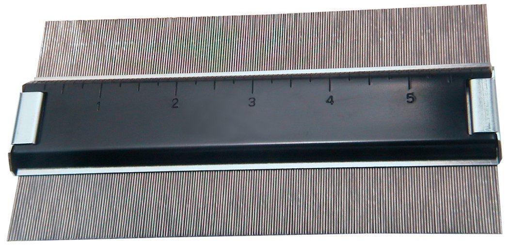

    Quote Originally Posted by El Camexican View Post
    If any one knows of a better way to get a profile short of cutting the head in half please let me know!
    A contour gauge might work . . Just press it into the head then lay a piece of lined tracing paper on the edge of the table then lay just the pins of the gauge on the table over the paper . . Then use a pencil with replaceable lead and make a point on the lead by rubbing it on some paper . . Then, pull the lead out far enough so the body of the pencil will not touch the pins and carefully trace it without pushing against the pins too hard because they might move . . Photocopy it or go over it with something darker . . You can then lay one tracing paper over the other and compare the differences . . Of course you can measure the heights of the lines too.
    Only 8 bucks at Amazon.
    http://www.amazon.com/Empire-Level-2.../dp/B0000TFIBW
    Sorry about the big photo.
  13. #58
    Mexico
    9,020
    Both great ideas guys THANK YOU!!!! CCing is still pending.
