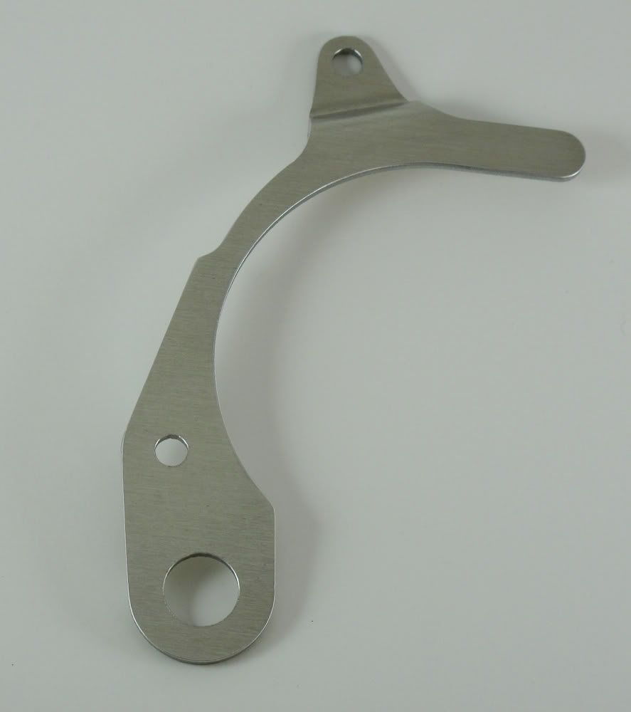

    Yep, I agree. I don't think there is any bolt left in there. That pedestal protrudes out beyond the "shift-shaft case area" by about 7/16-1/2". A new pedestal could be welded on to your case, if you were so inclined. Your top hole is cracked just like mine. I've thought about getting it welded up, but have never bothered to, as it doesn't cause any issues with my sprocket cover/case saver.

    Hey Onetrackmind, thats a great R for the money. My case was broken the same way on my R. I bought one of these case savers. Click image for larger version.

    It uses the shift shaft, and i tapped the hole in the upper mount for a slightly bigger bolt. OEM uses a very long bolt that is also used to hold the center case together. Someone broke mine.

    Thanks for the link...that IS a great price! And it solves my problem without any headache...bonus. Were you able to find a sprocket cover using shifter shaft or are you just running without the cover?

    Quote Originally Posted by Jason125m View Post

    This is an okay design if both of your case saver mounts are intact, but if you're missing the bottom mount, and you wad up the chain, it's going to put a ton of stress on your shift shaft as it pivots around the top mount.
    I like these designs better if you're missing the bottom mount. It still wraps around the shift shaft, but it is braced against the stator cover, which is a much stronger design in my opinion.

    Thanks Red...I definitely like that design better. The price isn't near as good, but it looks like it would perform better when it has to.
    Any ideas on a sprocket cover in my situation?
    Las Vegas, NV.
    2,531
    If you want to run a sprocket cover, I'd thread that bottom hole and bolt the sprocket cover to the case saver, then attach the case saver normally via the top bolt.

    Yep, that would work for sure. Thanks for the idea!
