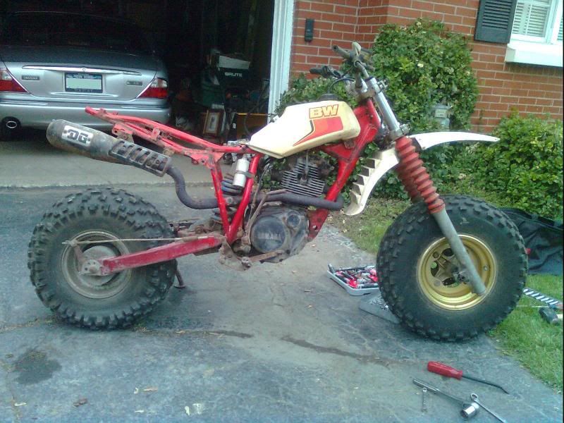

-Someone put a Honda ATC (200cc model I believe....you guys would know better than me on this one) rear mono shock on it and ditched the stock dual rear BW200 shocks. To fit the shock, they welded on their own linkage on the swingarm and hacked the airbox up very badly.

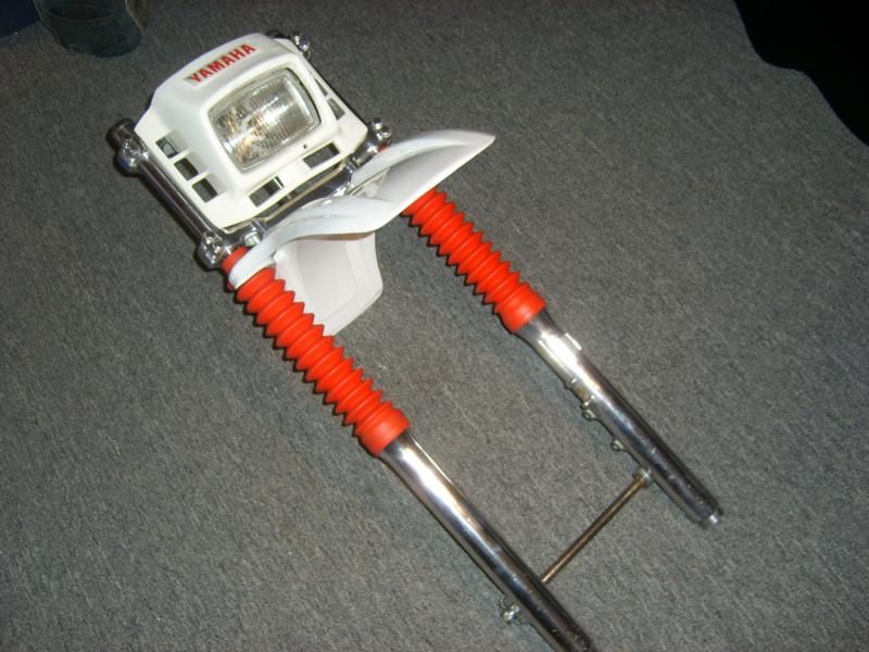

-The cool part of this bike is that the front stock BW front end was replaced with 1985 Honda ATC250R forks, brakes, hub, triple clamps, and wheel. This is a huge improvement over the BW200 forks and drum brake. It sits taller, stops better, has more travel, and just looks cooler. The front tire is a Dunlop 24.5x8x11, OEM for a Honda Fat Cat TR200.

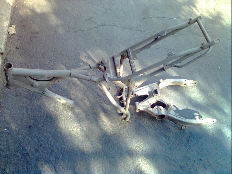

-The frame, swingarm, rear wheel, and front ATC250R hub have been sandblasted and will be either painted or powdercoated (not sure which one I should do yet).

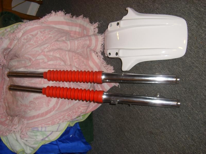

-I polished the ATC250R forks and they have new red Daystar fork boots installed on them.

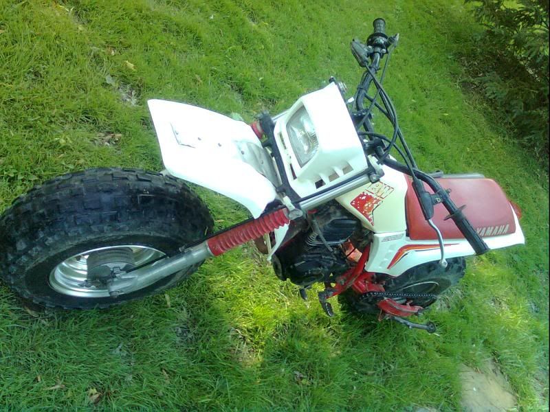

-I took the stock BW200 headlight and frame and made a piece of aluminum angle to fit it onto the ATC250R triple clamps. It took some thinking, but it worked great and actually looks pretty much stock.

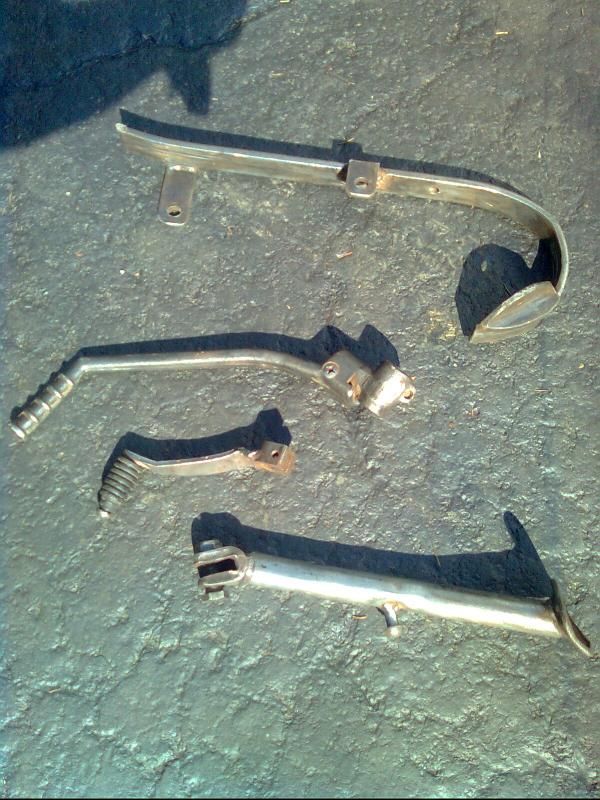

-I wire wheeled and painted all the bolt on parts such as the foot pegs, mounts, shifter, kickstand, etc, etc.

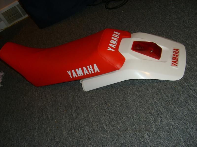

-I sent my old seat cover to some nice folks overseas that sell repro motorcycle seat covers on ebay, because they had an offer where they give you a free brand new repro seat cover if they didn't already make one for your make and model of bike. They used mine as a template and sent me my new one free of charge and I had it put on by a local vinyl shop and the guy said he was very impressed by the quality of it and it fit and looks amazing. Since then, they've been selling them like hotcakes. This seller is GREAT to do business with. http://www.ebay.com/itm/YAMAHA-BW200...9db2b5&vxp=mtr

-I ordered a new Maier ATC250R front fender (a white one). It was hard to find white since most everyone out there only carried red, but I got it and it'll bolt right onto the lower ATC250R triple clamp and hopefully blend in and look like stock OEM piece on the Big Wheel.
-I got some nice polished ATC250R tripled clamps off ebay because the lower triple on my bike had hairline cracks near where the forks slide through.
-I had my new ebay seat cover installed and it looks great, just like OEM.
-I buffed the taillight lens (which seems to be a very expensive part) after removing the rusted OEM hardware for it with a tiny drill bit and a very steady hand. I replaced the rusted hardware that I drilled out with stainless steel hardware that of course, I had to polish too.
-I got a piece of aluminum angle and fabricated it so that the stock BW200 headlight assembly could be bolted onto the ATC250R upper triple clamp and it fits perfectly......the white Yamaha plastics are even a somewhat close match the the white Maier front fender. I some little red "Yamaha" decals that I'll put on the bike when I get it done that look just like the OEM BW200 ones, just to add a nice finishing touch and help blend the BW headlight shroud to the 250R forks.

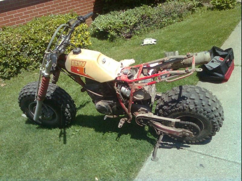

The pic of the bike from the auctioneer's website. This is what reminded me of when I saw a Big Wheel when I was a kid and sparked my madness and made me go buy it.
Right after I won the auction and rolled it up to the front of the lot to be loaded on my truck.
Got her home and started tearing her down and cleaning her up!
Somewhat cleaner, and that front rim, underneath all the years of caked on mud, is gold.

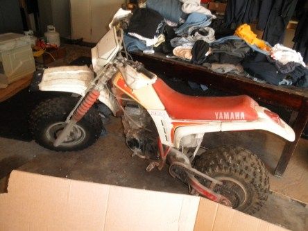

The other BW200 that I got off Craigslist and used for parts. It needed too many little things, I wouldn't have parted it out if it was really nice. PS- I do have lots of nice parts of this bike for sale still including the engine.
The frame and swing arm and other parts, wire wheeled and sandblasted and ready for paint and powdercoating.

Some pics of the progress I've been making.......
Many more pics to come. Thanks for letting me share this rebuild with you guys!
