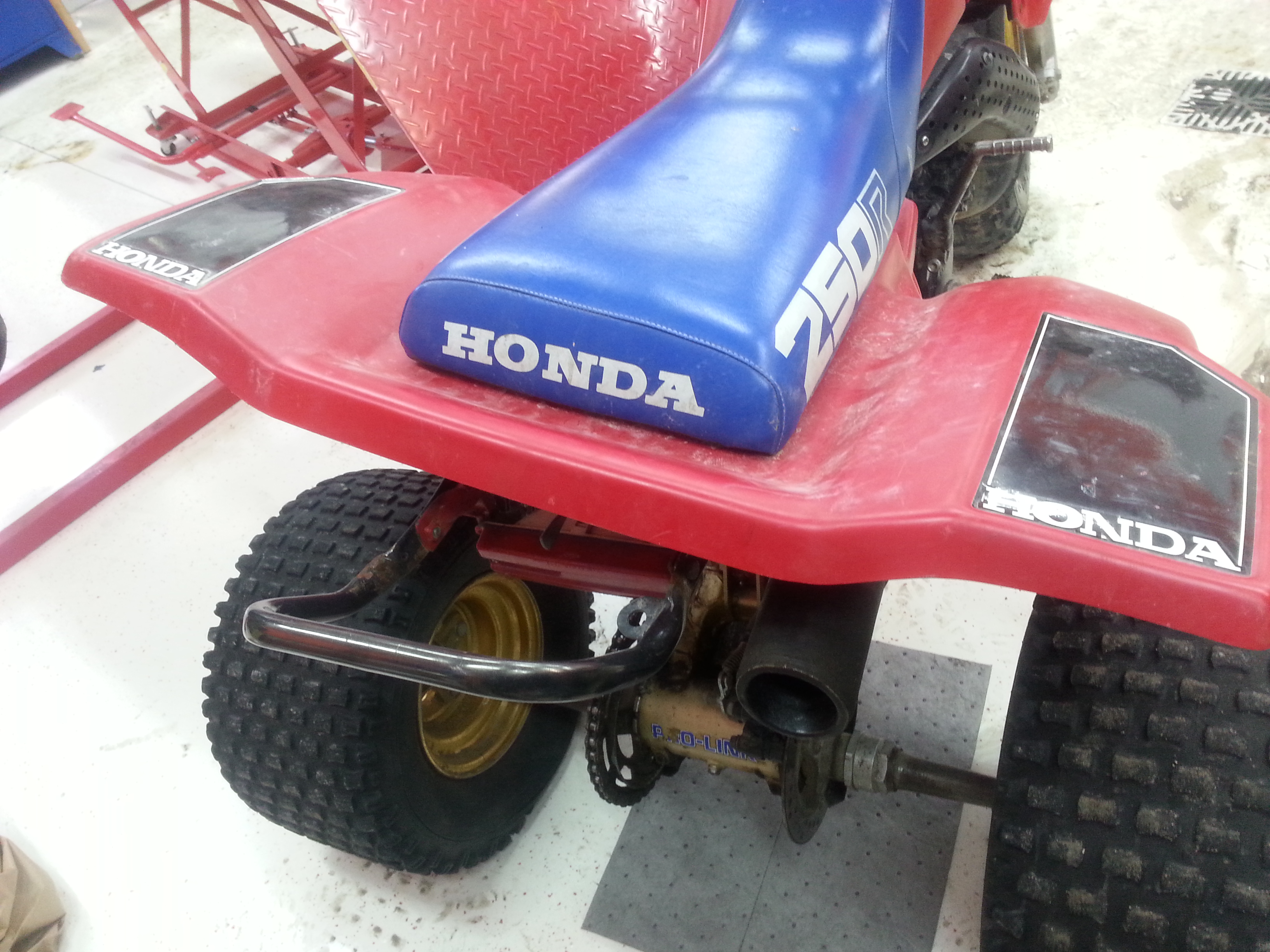

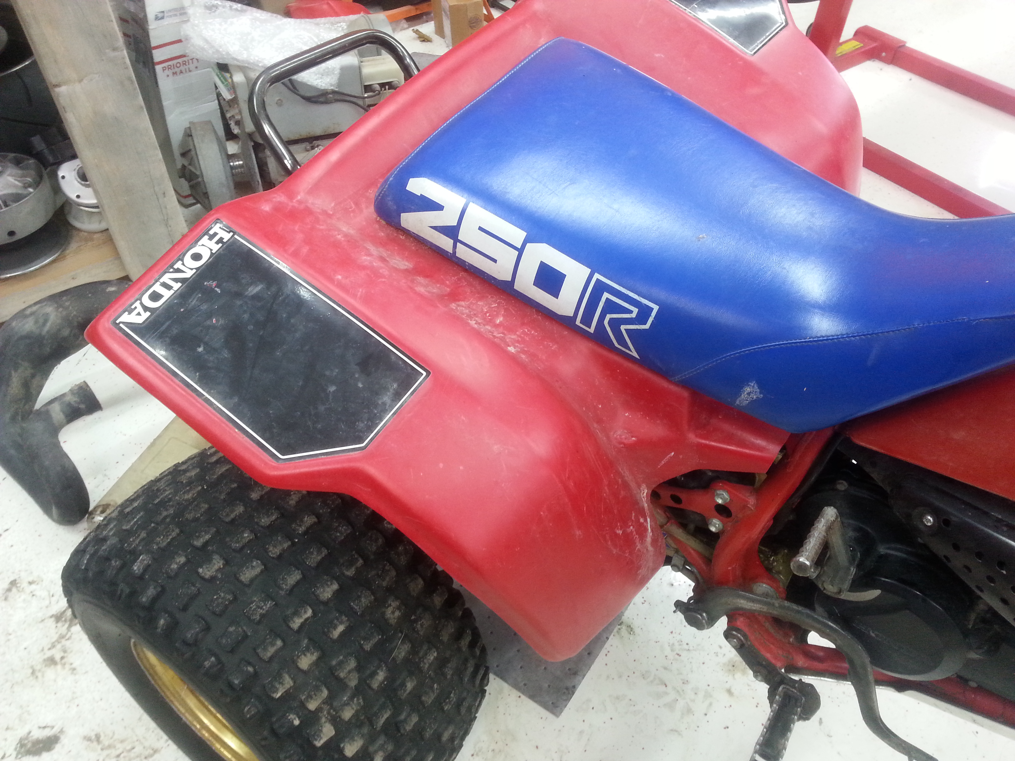

    I just picked up another 85 to add to my collection, and I am trying to determine if these fenders are OEM as the previous owner insisted. I dont think so as they dont have the crisp corners as my other OEM's do. I need the help of an expert here..
    It is my understanding that the 85 fenders did not have hte warning label embossed on the left fender (a sticker was used)..So I know that they are not 86's because there is no warning label embossed.

    looks like maier
    186
    have you tried peeling off the honda sticker thats on top of the big black sticker? it probably says maier under it

    WINNER! Sometimes I over think things and forget the obvious. THanks

    That's the best indication right there, that they're not OEM.
    devore,ca
    1,054
    If there is ejector pin witness marks on the underside, they injection molded, making them OEM. If there is no marks, it came from a vacuum mold, making them aftermarket. The marks will be round or elliptical. Barely visible.
