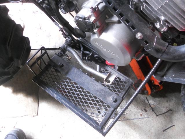

    Hey guys, Has anyone put netting on the brush guards on a big red 200es? I have one had have several times run into a potentially dangerous situation when my foot slipped off the peg and got caught between the peg and brush giard. THis has happened while getting on and off the trike and also while riding. My fear is that if this happens while riding my foot could hit the ground and cause a big owie.

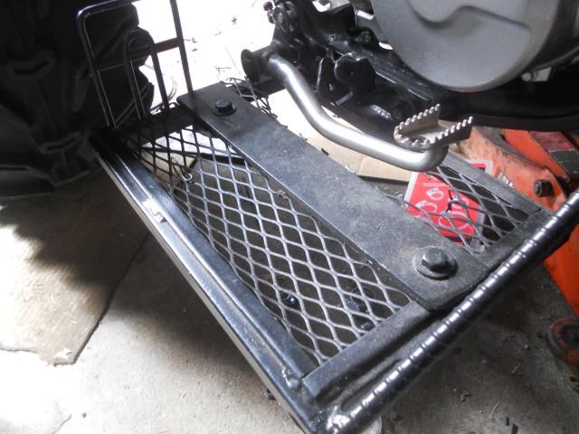

    this is what me and my dad came up with a while back.works great.

    Well that is pretty neato looking, I may be able to work something like that up. Thank you for the pic!
