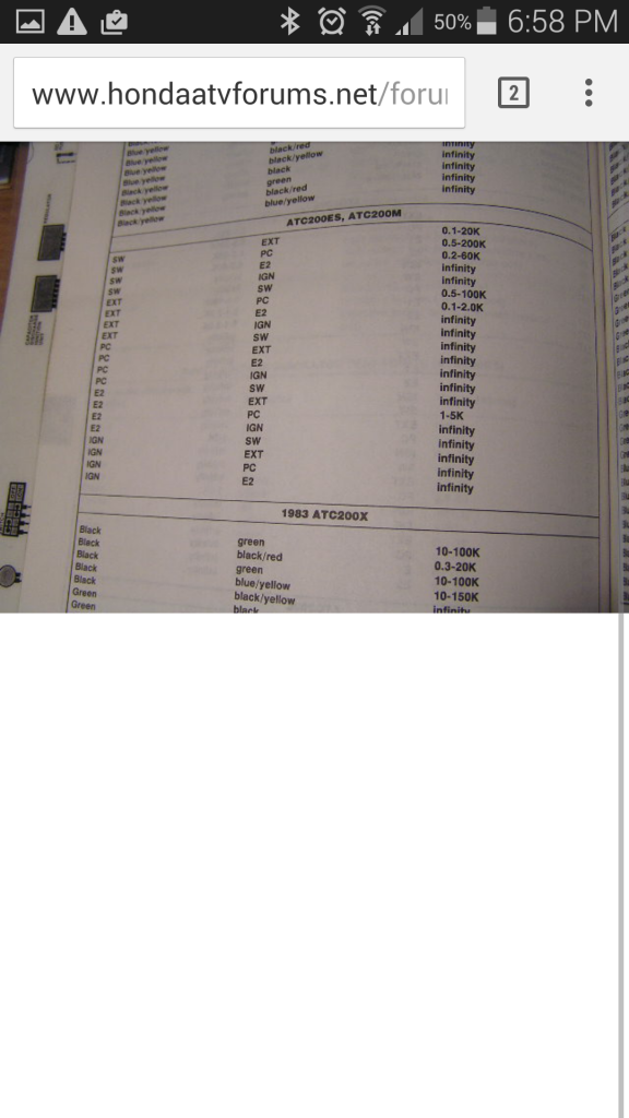

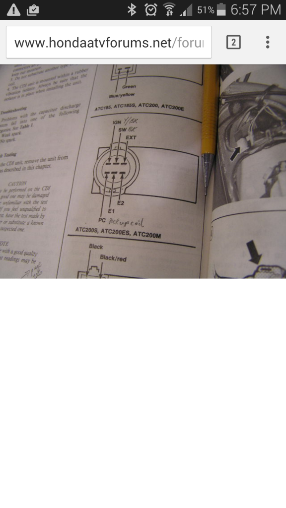

    Or you could always test yours

    Thanks frank! Appreciate the info, I'll have to pick up a manual...I didn't know it contained all this info. Are those resistance/ohms values?? Does it happen to say any kind of testing for the coil or regulator?
