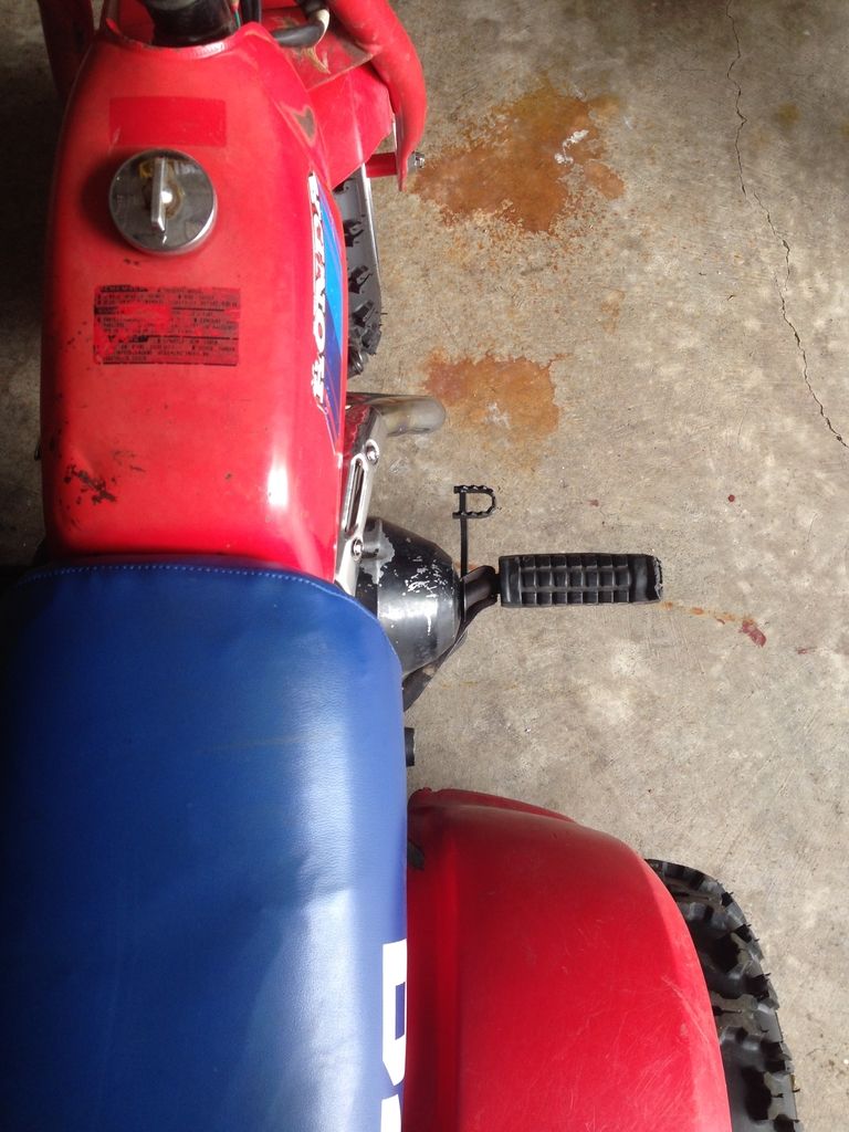

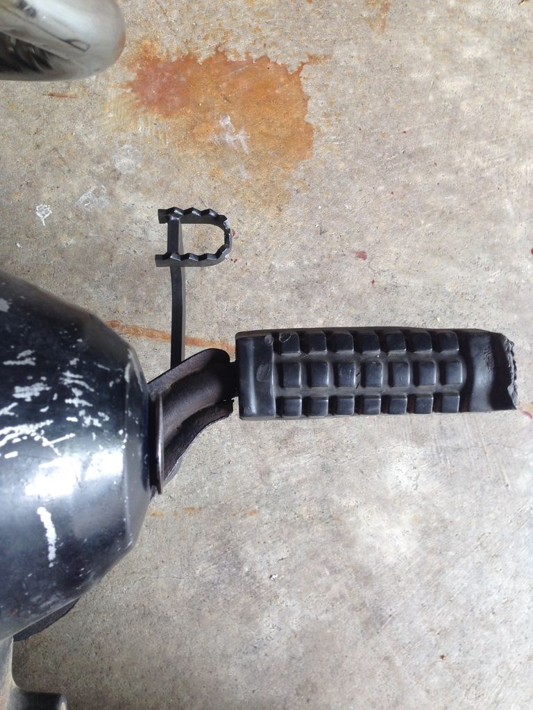

    Hey guys, just wanted to report back on how things ended up. In my original post, i said that the foot brake kit from Spanglers wouldn't work with the 110 motor and foot pegs but after installing and making some minor tweaks, it worked well. The brake lever is a bit further inside than I'd really like but after shimming it with some washers, it worked out much better than I thought.
    I decided just to run the original 110 foot pegs because moding the adapter plate to make the custom 70 pegs work was going to put things in places that I didn't like (foot pegs would have been offset and lower than normal). The 110 pegs worked well with the foot brake lever so I returned the 70 pegs and shifter.
