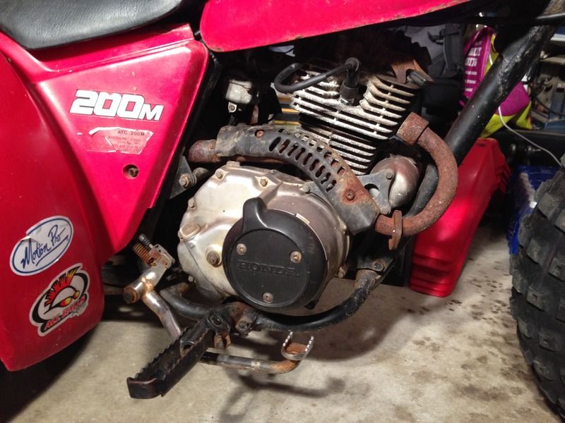

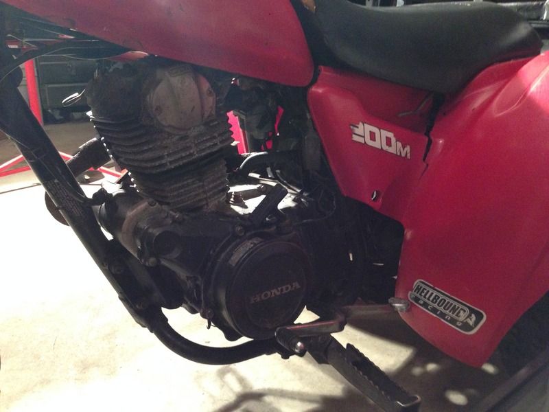

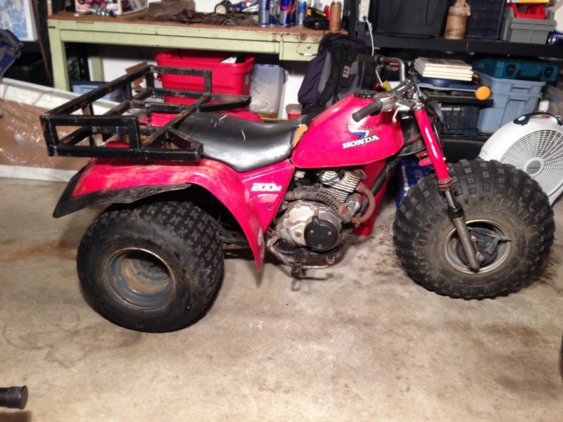

Well I picked up this 1984 ATC 200M on craigslist for really really cheap. It has just about everything broke or messed up. Most would think its a parts bike but I will fix it. Upon arriving home and unstrapping the bike, the exhaust completely fell off the bike. One rear tire also popped a bead.

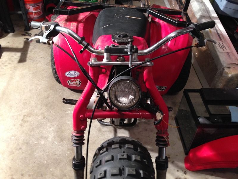

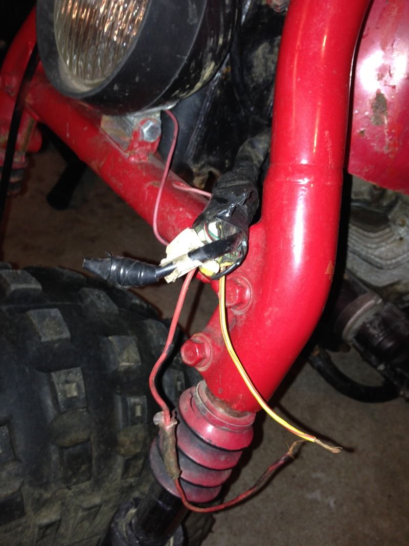

All the front wiring is hacked, no key, no lights.
Crazy homemade rear rack.

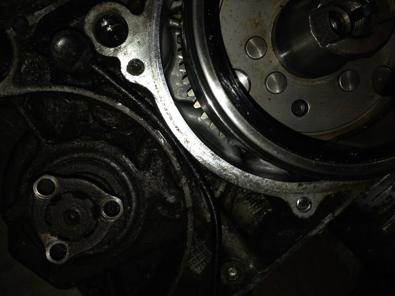

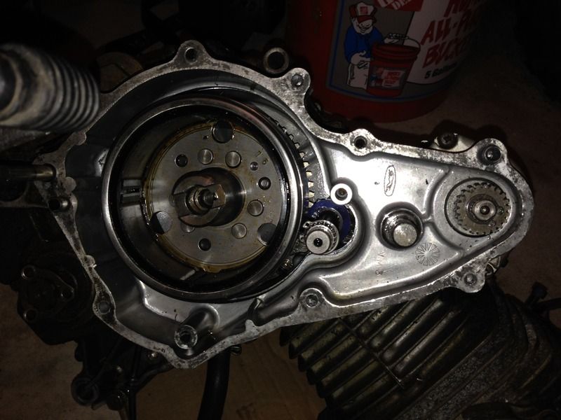

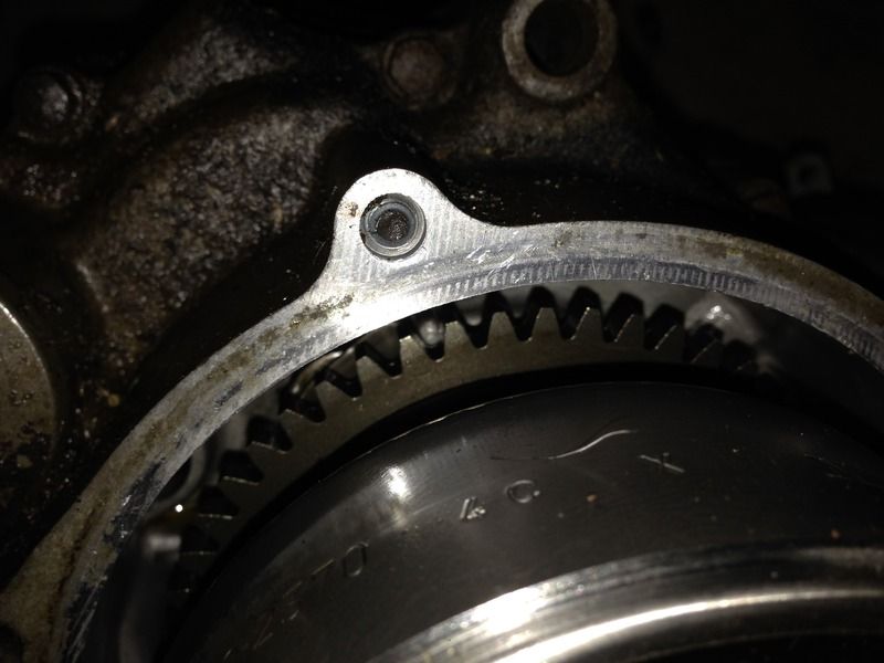

So the kid who had it snapped 3 of the 4 recoil cover bolts, that go into the crankcase. His fix was to replace 3 bolts with bolts that are shorter and don't even reach the crankcase...
. The starter housing thing is held onto the main left crankcase with the two starter bolts, the idle pin, and the recoil pulley. wow. Now I have to ez out three snapped bolts from the crank case.
I was looking for the bolts that go into the recoil cover and through the starter case into the left center crankcase. I don't see exactly what I am looking for. I see them in the right crankcase diagram but not the recoil assembly diagram or the left crankcase diagram. http://www.partzilla.com/parts/searc...VER/parts.html
