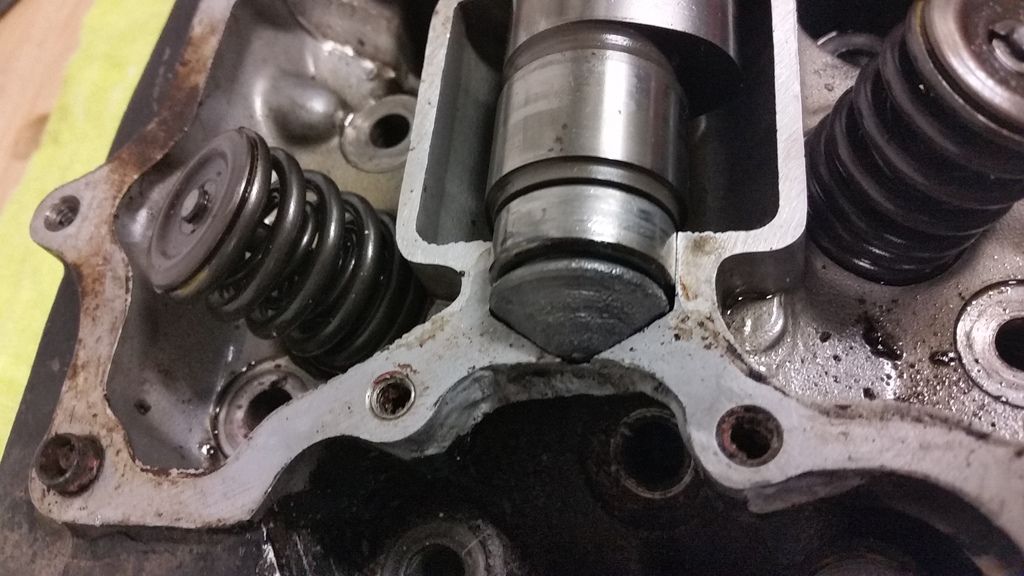

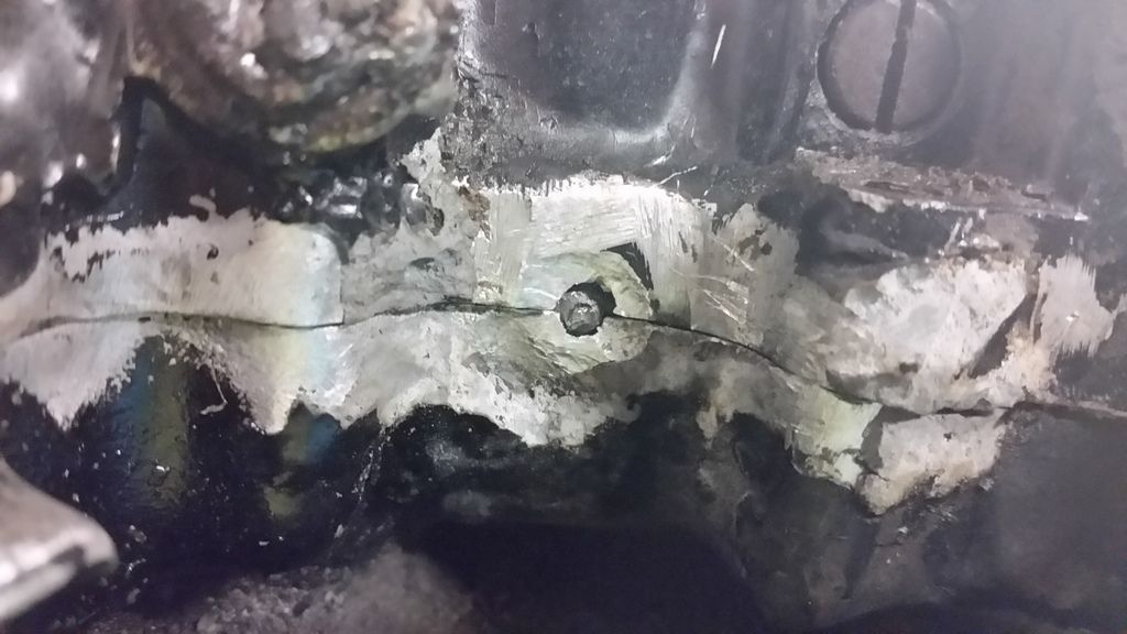

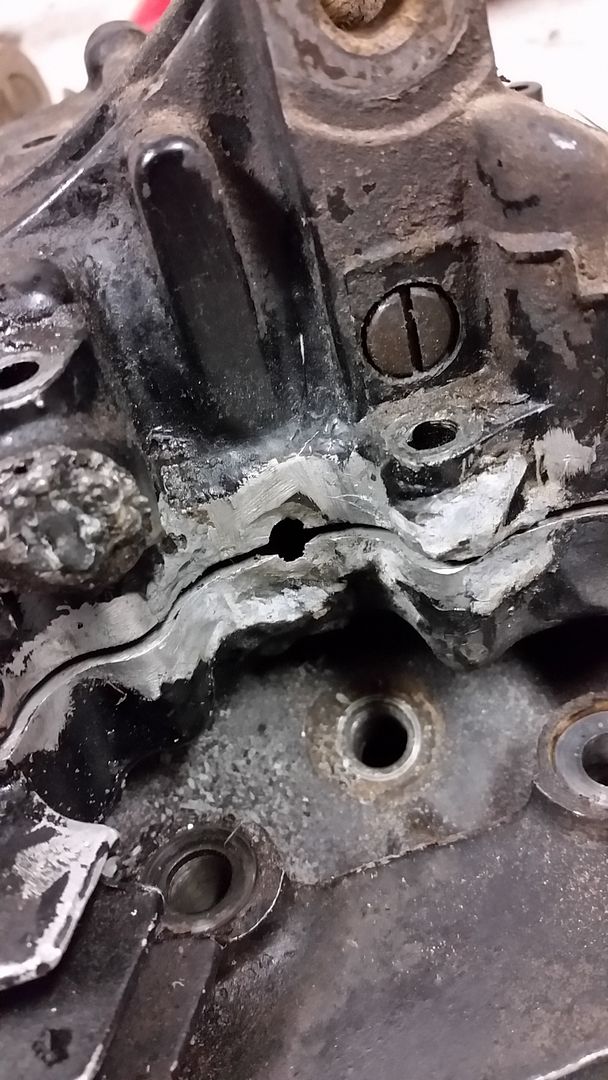

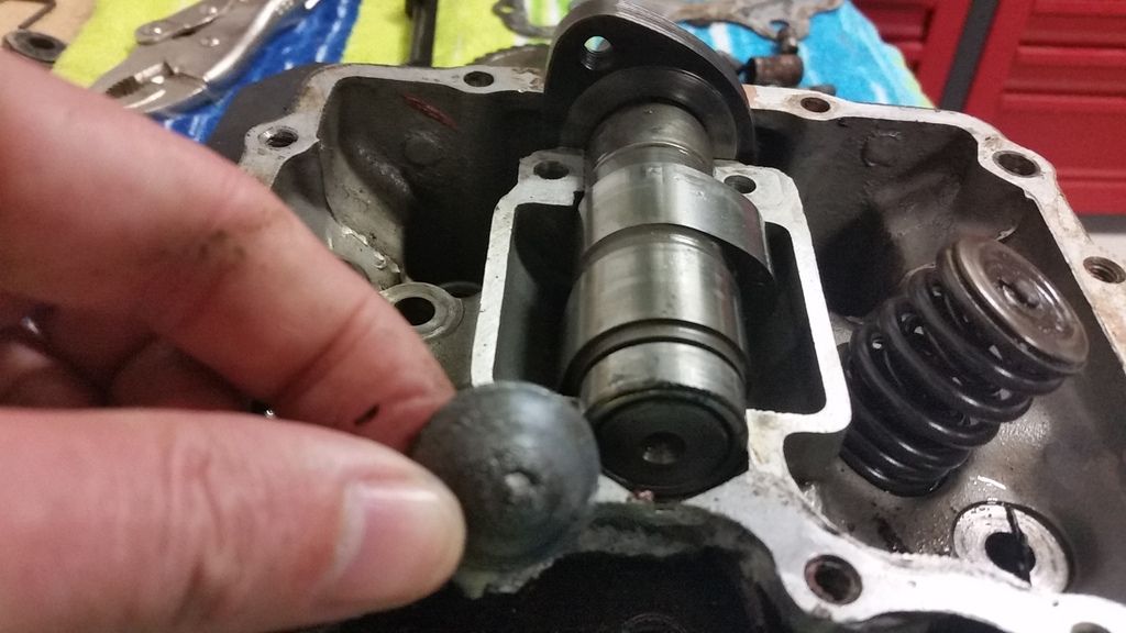

    My recently purchased 87 250sx had plenty of what looked to be JBWeld above the spark plug hole where the head cover meets the head. It also had a broken head bolt which was causing some oil seepage so I decided it would be a good time to take it apart and fix it.
    After getting enough of the JB Weld off I found what appears to be a hole in the head. After further inspection the hole looks to be part of a head modification to accommodate a aftermarket cam.
    Plenty of pictures follow. My question, is this what it is supposed to look like or did someone try to machine this in their garage, screw up, and came up with this as a resolution? The Cam is a Megacycle #15700NB which appears to be a correct cam for the 250sx.
    Assuming this is a major hack job, there doesn't appear to be a way to fix this other than to replace the head and head cover. If I am going to do that I will probably just go back in with the stock cam. What would a used cam and perhaps the HD springs be worth?

    that's the most F@#$*D up thing I`ve ever seen.
    there`s not supposed to be anything n the back of that head behind the cam but a wall of aluminum . That end bearing outer race should bottom in the hole (which is a flat bottom and not an angled one.
    Looks to me like someone took a big drill bit and drilled into the back of that rear journal for some dumb reason (that angle is identical to a drill bit), broke out the other side, then tried to JB Weld their mistake.
    That head is trashed and I`ll bet the valve cover is a mirror image of the head. Throw them both away. Call Megacycles and get the cam specs, measure yours to determine wear. It may be ok to run and even if it isn`t I think Web or MC will do rewelds on their cams for much less than a new one. Definitely replace that rear needle bearing that was up against the JB Plug.... Are there any worn spots on the lobe faces? With high ridges on each side?

    Just a quick update to this cluster. The head and the valve cover were obviously trashed. I had a parts bike with a head that had a bent valve. I sent that head off to G&H for a rebuild. The cylinder and piston were still within spec so I put the newly rebuilt head, valve cover and stock cam back in and she is purring like a kitten again.
