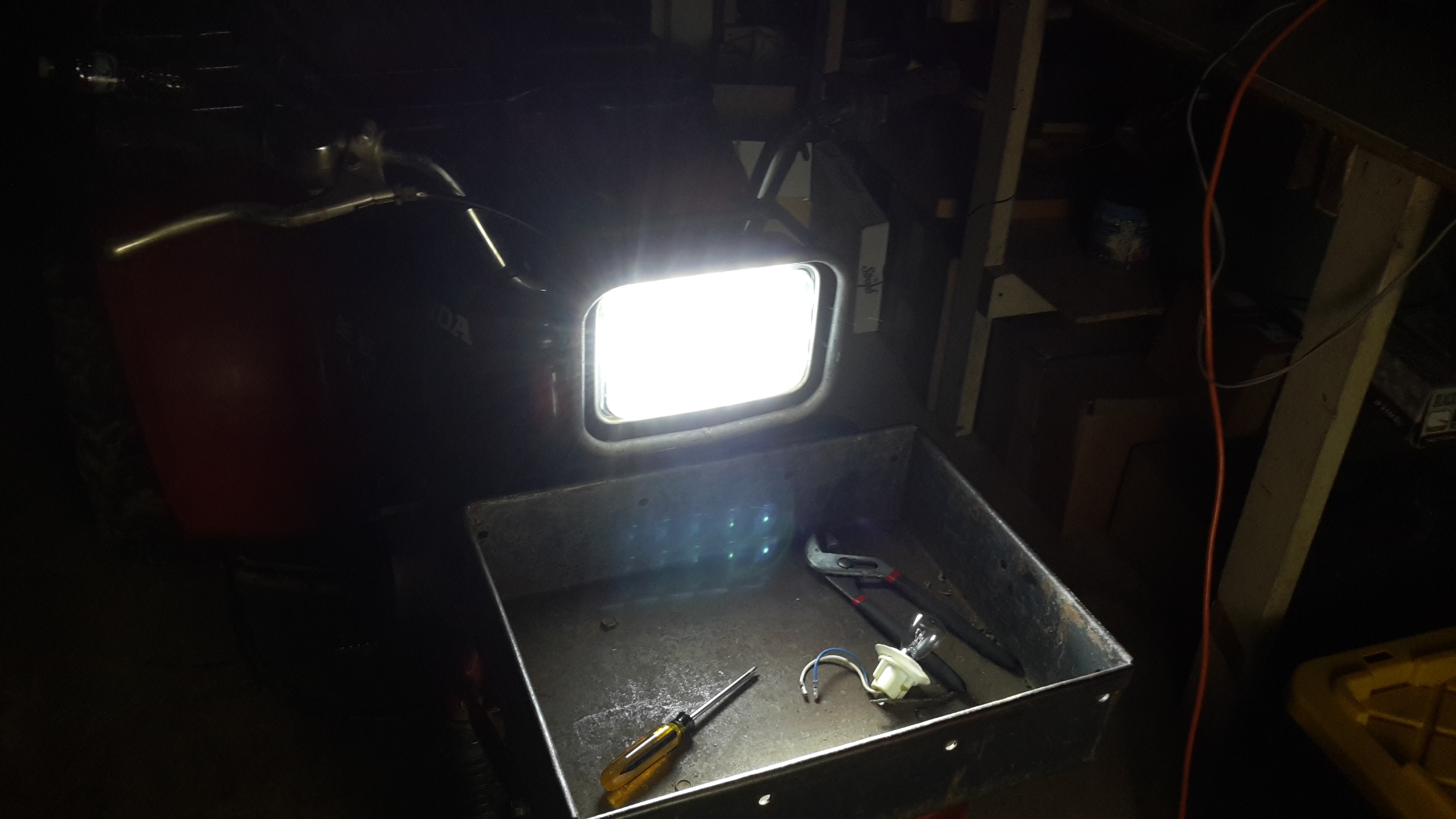

    Here is a handy guide for an almost drop-in LED replacement for your headlight. The headlight when installed will look completely stock and fit inside your original headlight housing. In addition, it has high and low beams, and hooks into your existing wiring so that your stock headlight switch will work to turn it on to low and high beams. You should be able to do this for about $30 (cost of light) and in less than an hour. You'll need a wire cutter/stripper, and some wire nuts or electrical tape. Existing hardware can be used for mounting the new headlight inside your stock housing.
    Frustrated by the dim stock headlamp on my ATC 200 ES, I decided I wanted to upgrade it to something brighter. However, I wanted to maintain the look of the stock headlight.
    I searched these forums far and wide about upgrading the headlamp to LED, but hadn't found anything definitive. So I decided to find a solution.
    Here is my new headlight installed in the stock housing:

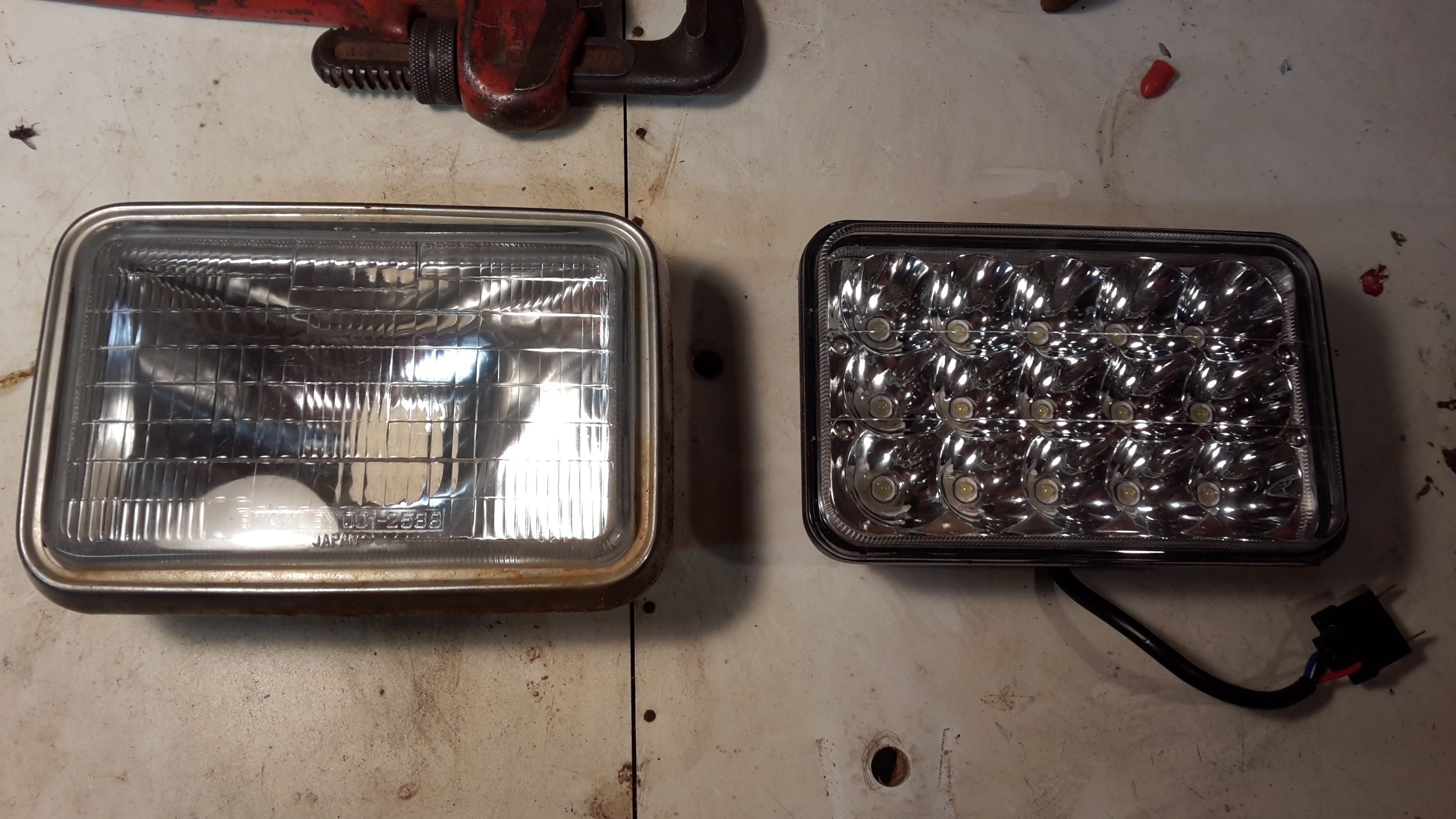

    First, the LED headlamp assembly.
    You'll need a 6.5 or 6.6 inch sealed beam LED headlamp, with high and low beam.
    I chose a 45 watt model, I wanted to stick with 45 watts because that is what the stock headlamp used. Because it is LED though, that 45 watts will give you a lot more light, at least twice as much. The 45 watt LED should draw about 3.75 amps. This is about equivalent to the power draw of the stock headlamp.
    Here is the one I bought, sitting next to the stock headlamp after I removed the stock headlamp from the plastic housing:
    These can be a little hard to find, especially finding just one, as most sellers sell them in pairs (for trucks, jeeps, etc).
    Here is an example: http://hg-light.en.made-in-china.com...10-30V-DC.html
    You should be able to find them on ebay from various sellers. I actually bought mine on Wish.com, it was cheapest source to get just a single unit, the only drawback was that it was shipped from China and took about 2 weeks to arrive. Here is a link to all the ones on Wish: https://www.wish.com/search/45%206.5%20LED
    I chose the 6.5 inch unit, to give me a little room for installing it, but afterwords, I believe the 6.6 inch would be a slightly better fit.
    At this time of writing, the going price was $30.

    Here is the stock light high beam inside:
    Here is the new light high beam in same location:
    Much better!

    You are correct! These fit in there so well that they are basically a direct replacement.
    The connector on the new light is an H4 plug.
    I chose to wire mine up directly wire-to-wire, but someone could easily wire in an H4 socket to plug the light into.
