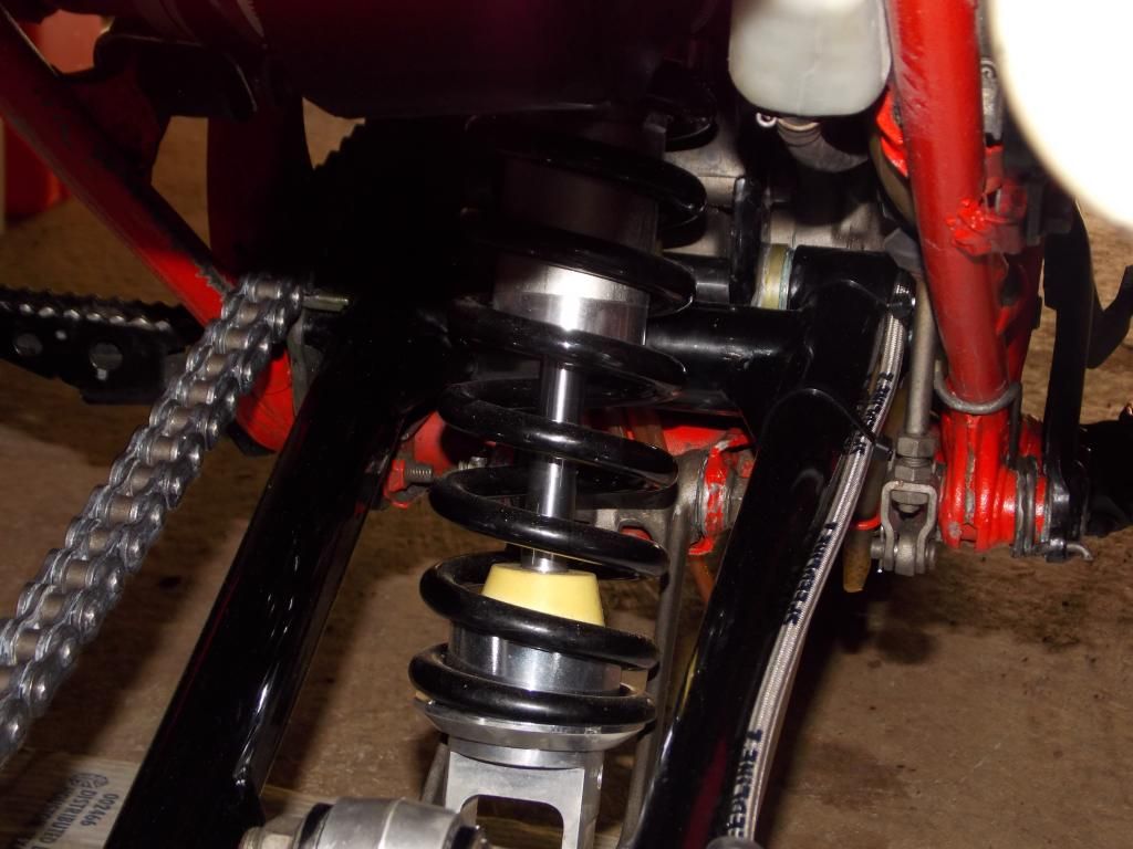

    Here is a shock that I built without the plating/anodizing a while back that is very, very trick inside.
    I raced/rode and taught MX schools with this shock on 3 different bikes over 5 years.
    I sold it on EBAY for $1000.00Click image for larger version.
