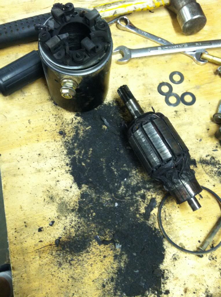

    This has happened to me before...my guess is you have a path to ground inside the starter, very common. LOTS of sh1t accumulates in the starter...

    I've checked all the conections of all the wires. I did that before I bought the new solenoid. What made me ask the question Is it worked right away with the new solenoid for them 3 seconds. Then went to doing what the old one did. That's what is troubling me. I have not taken the starter off. The owner before me used the kick starter to start it. I'm sure the electric start has not been used since the early 1990's when the battery went dead. This machine starts first kick Eveytime. I'll pull the starter and see what it looks like.

    Almost certainly a short in your starter. Jump the solenoid,or jump it direct on the starter stud. If the starter doesn't turn. It's inside. You most likely simply need a new set of brushes and a cleaning. And the new ones on ebay work very well also,if you aren't comfy tearing into it. But there really isn't mush to them.
