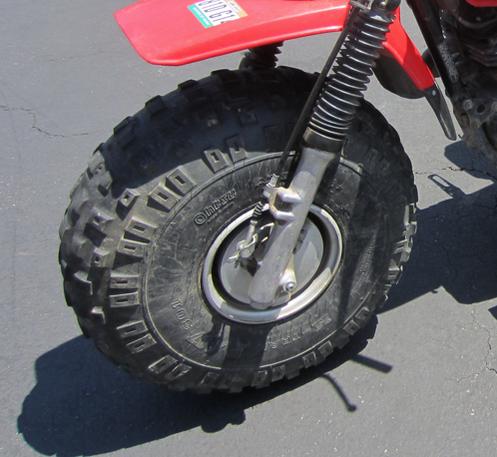

    ps Here's a shot of the 'balloon' tire on there now. 30 years worth of expansion!!!

    Yea shes a little puffed out there lol
