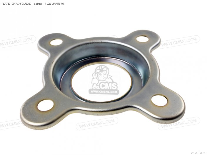

    The question I have is about the rear sprocket flange on the 350x. What is it's purpose? And more importantly, is it detrimental to run the 350x without one in place?
    I was checking out my brother's 350x over the weekend and noticed his has this flange and my wife's ride does not. I am trying to find some info in it and not having much luck.
    In this link, it is item #6 in the fiche. http://www.partzilla.com/parts/searc...AIN/parts.html
    It says it's a guide plate, but seeing this part installed on an actual machine, it kind of escapes me as to how it has any ability to act as a chain guide.

    That is a factory Chain Guide. it does help support the amount of torque on the rubber dampers for the sprocket. will it run w/o it? yes, should you have it? if your trail riding and are using stock parts use it. it will help. if your racing or have an aftermarket axle, then no.

    as you probably noticed, they are discontinued . . if you don't know where to get one you can try the link below . . there is also a big atv salvage in phoenix az.
    http://grimcyclesalvage.com/
    i know you know what they look like but here's what a new one looks like if you need to email the photo off to someone so they know exactly what you are looking for.
