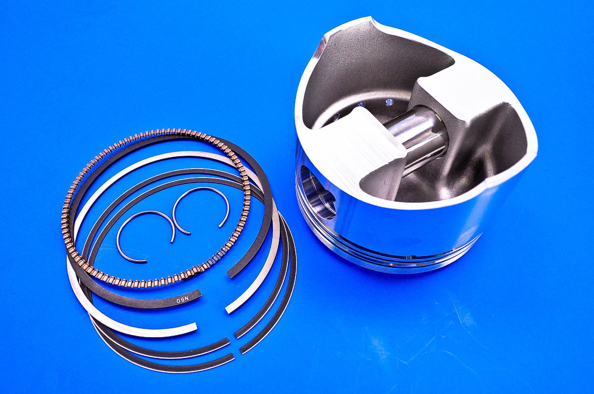

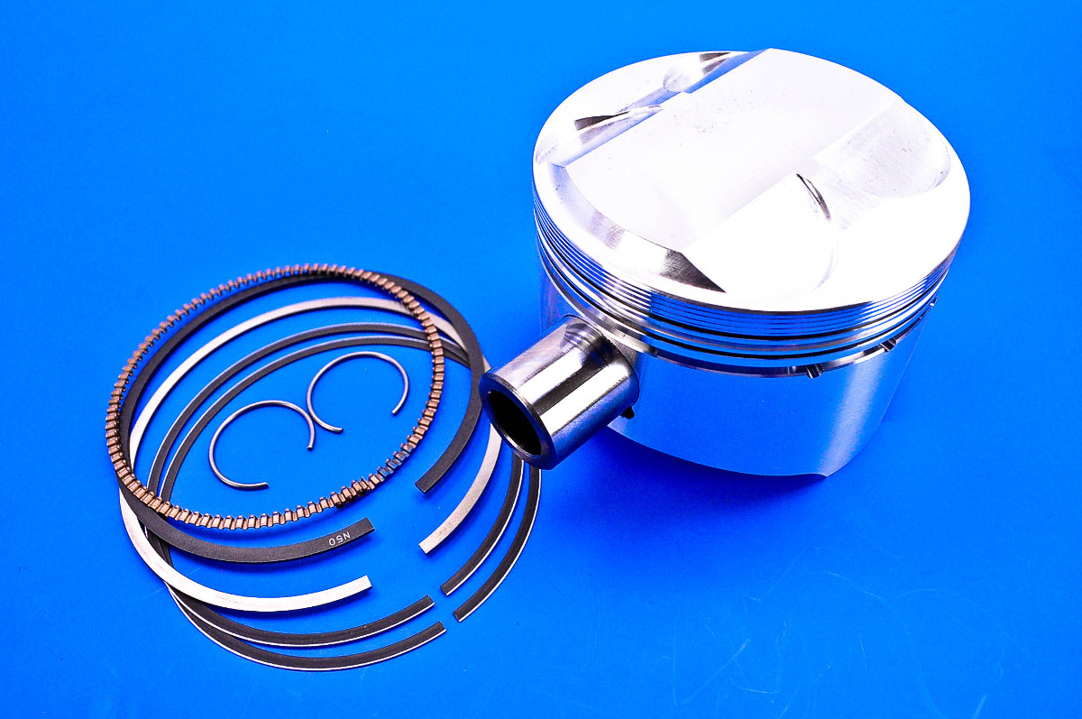

    Order the one size over (if you are still on the stock bore) Wiesco 10.25:1 piston kit. It will come with a new wrist pin, gaskets and rings. Have it bored and honed. If you pull the clutch cover off for some reason, be careful putting it back on. It's easy to break the decomp system inside.

    Yes, that's it . But I don't see anywhere what compression that one is. It may be stock ratio, which is fine too, but the 350x's run real nice with the 10.25 to 1 compression.
    Measure your cylinder first to make sure the 1 step overbore is the one you need. Just in case its been bored before.

    if your piston is over sized, it will have a mark on top like .25 or .50 or .75 or .1.00 or .010 or .020 or .030 or .040 etc. . . the first four numbers are mm . . the second are thousands of an inch.
    10.25 is the amount of compression it will provide which is an increase of around 1.0 which will make a small but definite noticeable increase in performance . . if your current rings are leaking compression then it will make a big increase in power feel simply because your old ones were leaking.
    you can do a compression test with the engine warm before you take it apart now if you want so you have a baseline.
    i would start a file and write down all the changes and how it performs etc as you go.
    i would also use good oil in it that has lots of ZDDP and is designed for wet clutch engines.
    here are the wiseco piston numbers . . you can buy direct from them or type the number into your search engine along with the words wiseco ebay and see what you get.
    http://www.wiseco.com/ProductSearch.aspx
    heres one i just found but the photo is completely wrong.
    http://www.ebay.com/itm/Wiseco-Pisto...9a9129&vxp=mtr
    here is the actual wiseco 10.25 piston
    Wiseco
    Wossner also sells them and they have a graphite anti friction coating but if you want one of these, contact them and ask what compression it is
