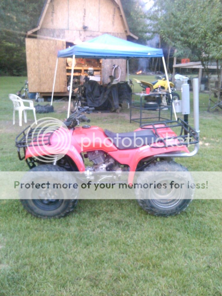

    little something ive been working on.all new bearings and seals,both clutches,new oil pump,complete top end rebuilt and got the exhaust and snorkel fitted today.more pictures to come

    got the bike all together,waiting on tires,lift and front locker.

    Looks good. Makes me wish I had a real gas tank for mine. How does it turn with the locker?
    1,775
    What rims are those? Are they Honda rims?
    louisiana
    1,499
    idk there were on the bike when i bought it.both front/rear are 12 inch.i ended up putting some silverbacks on it with the front locker.locker really doesnt effect steering to bad.
