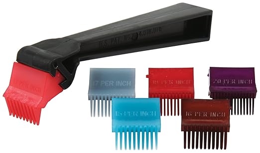

    John, as far as straightening the fins, you can do that with the exact same tool they use.
    http://www.amazon.com/Allstar-ALL106.../dp/B006K8GKBO
    I like the idea of going natural, however, imo, they won’t look great after they are stripped due to their age and/or the finish on the orig material . . If I went natural, I would get them anodized . . You can get this done In different colors or you can get a semi gloss or chrome like finish.
