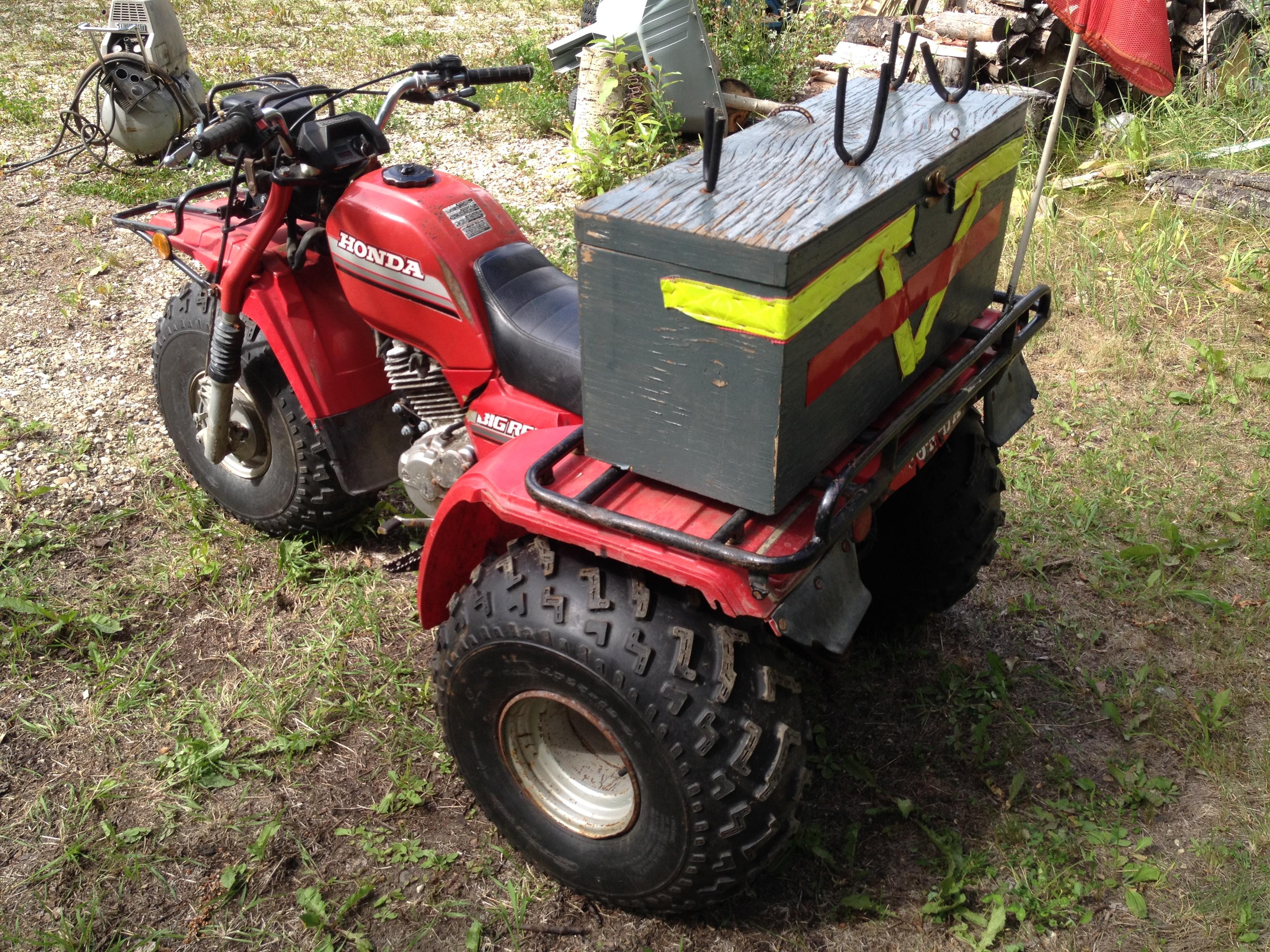

    Hey all...I am a first time member and post-er to this forum. I joined up because I recently purchased a storage locker and found a trike within it! While I am somewhat mechanical, I have never owned (until now) or spent much time with ATCs or ATVs...I thought I would post a few photos for your enjoyment, and ask a couple questions...

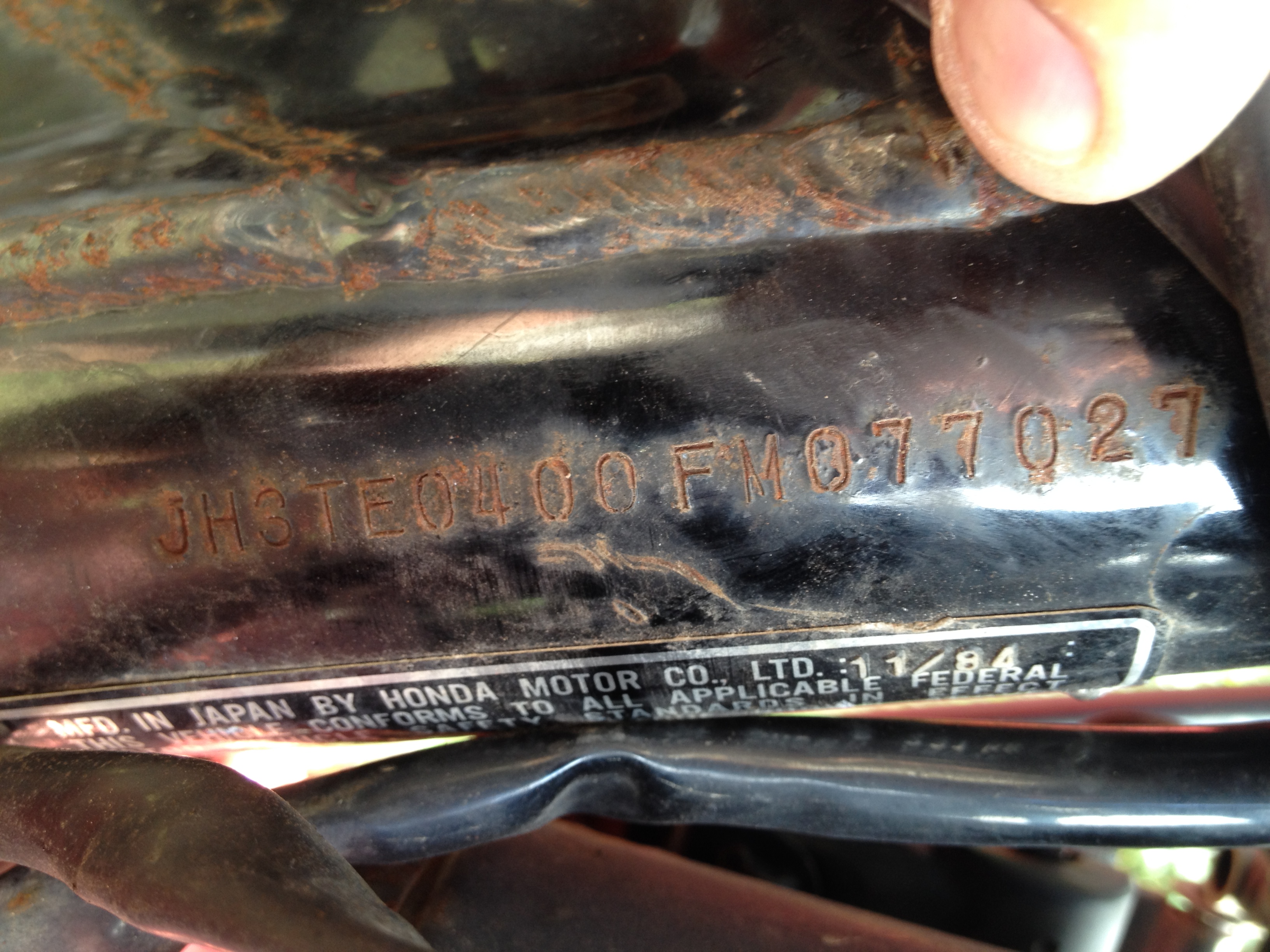

    1. The online VIN identifier called this a 1985 250es Big Red...on the engraved label, it states it was made in Japan in 1984 - is this kind of discrepancy common?
    2. I have tried all over the web to find out about the value of the "wagon" (trailer?) that comes behind the trike. While I have found ads for them from the 80's, there don't appear to be many of them around now. Are they common? I was thinking about repainting it with an appropriate red color - do you know if one is available through Honda, or is it basically a "grab a paint can of similar color"?
    3. Do all 1985 250es Big Reds come with a kick start? I was under the impression that kick starts at that age were a bit oddball?
    Hope it's all right that I post a bunch of photos...just starting off in here, so please feel free to correct me if I step on toes. I've been on enough boards before to know that there are rules, and then there are unwritten rules, and both need to be followed.
    Here to learn, and thanks for your time,
    Ellegon

    Kickstart is normal. That trailer is one helluva find. Take good care of that setup. Don't see those everyday.
    Thanks for the comments, Yaegerb...I know this is a bit of an odd question, but how rare is this thing? Honestly I bought the locker to resell stuff, and thought the trike was the valuable part...if you saw one down in the States, how much would it go for? I can't find any records online to give me even a ball park figure....

    Great "Storage War" find, don't believe it's a HONDALINE trailer but a very good quality built aftermarket Mfg. Too bad it's north of the border

    things have to be manufactured before they can be sold, so yes it is common for the manufacture (made) date to precede the model year.

    Nice find ellegon. I agree it doesn't look like a Hondaline trailer but still cool. Looks like an old surveyors setup. What part of alberta you from? I may be interested in buying it.
