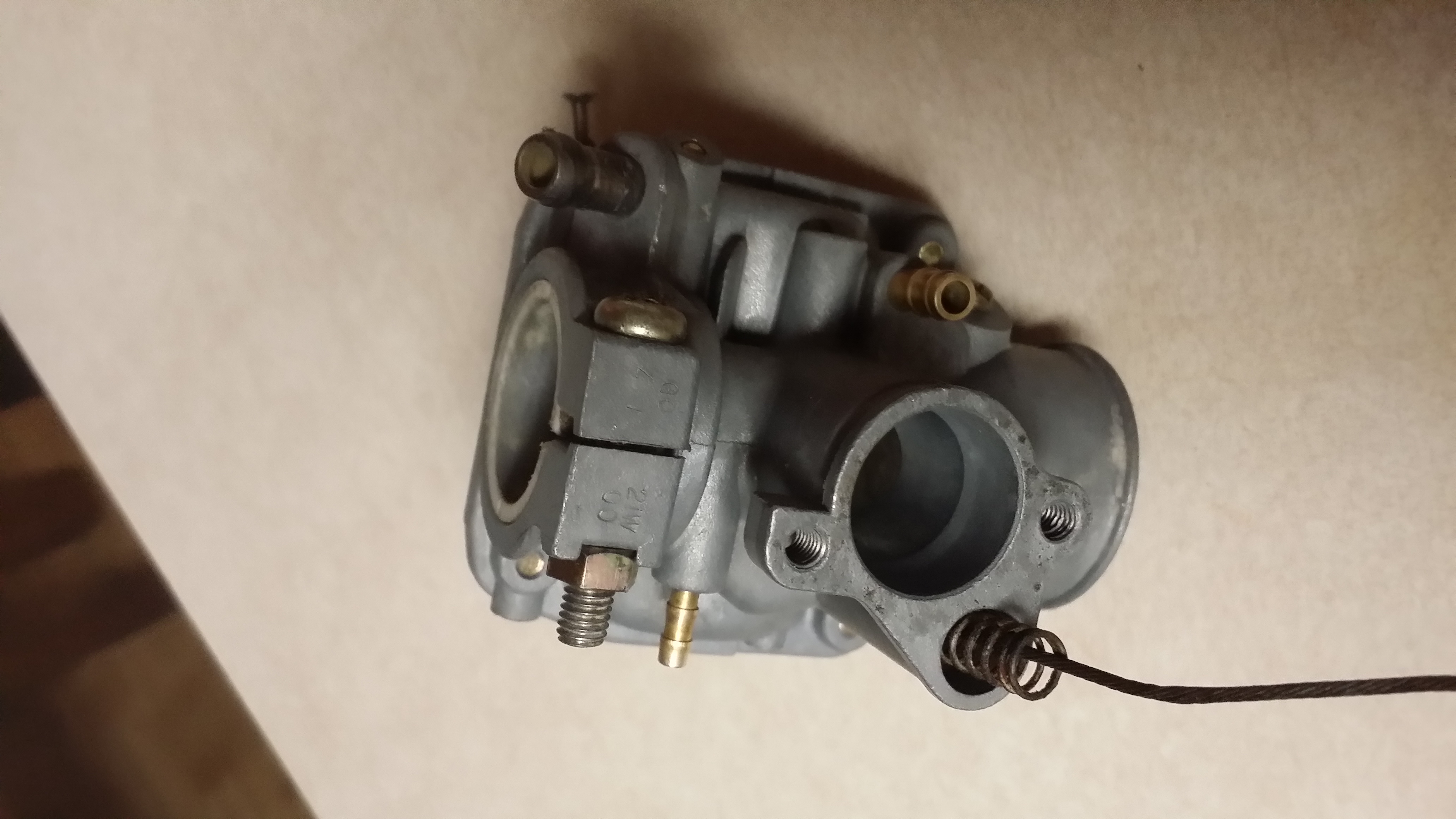

    Just took it off the bike & cleaned it up. Here it is off the bike. Any more ideas? I'd sure like to get everything hooked up right. Thanks!Click image for larger version.

    glendive, montana
    1,822
    I hate to tell you this but that is not the original carb for that bike I have a couple of them and will get you some pics in a little while, and will also get you some pics of the inside and propper jetting for it as well.

    if you are going to run the carb you have you will need to open it up and check to see which inlet is actually to the float, that will be you fuel inlet, and then the other two are breathers, and the oil injection is the same one I identified for you.
