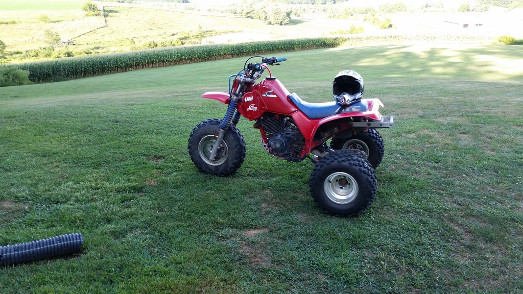

    Hey all, proud "new" 350x owner here, and I've got a question.
    My new trike has a stock head pipe with a DG slip on, uni filter, and what I think to be stock jetting. It starts up first or second kick every time I've ridden it and seems to have great power. Here's the problem, after it gets warm it has a low idle and a low-end stumble. It also seems to want to "hang" the revs a little once its warm too.
    I also have a 300EX quad I bought as a "parts mule" a while back, that I've been pillaging random stuff from here and there. Through some research on this site, I've come to the conclusion that the 300EX has a 32mm carb on it with an accelerator pump whereas the stock 350X carb is 31mm.
    If this is indeed true, and I am in the market for a re-jet/rebuild anyway, what is stopping me from using the 300EX's slightly bigger carb and taking advantage of the accelerator pump? I understand the 400EX carb is the way to go if you're swapping it out, but I've got the 300EX carb on hand and its free
    Edit: To add to this, I'm having a strange problem with the throttle sticking every once in a while too. You can feel the thumb throttle stick at about 1/4 throttle. You can either "push" your way through it, or back off the throttle and "massage" it and it will go back to normal. It doesn't do it all the time, but it is annoying when it happens, and it only does it when the machine is running. More research here has pointed at the bore in the carb being worn. Anyone have any experience with this issue?
    Thanks for any insight you guys may have!
    MIke
