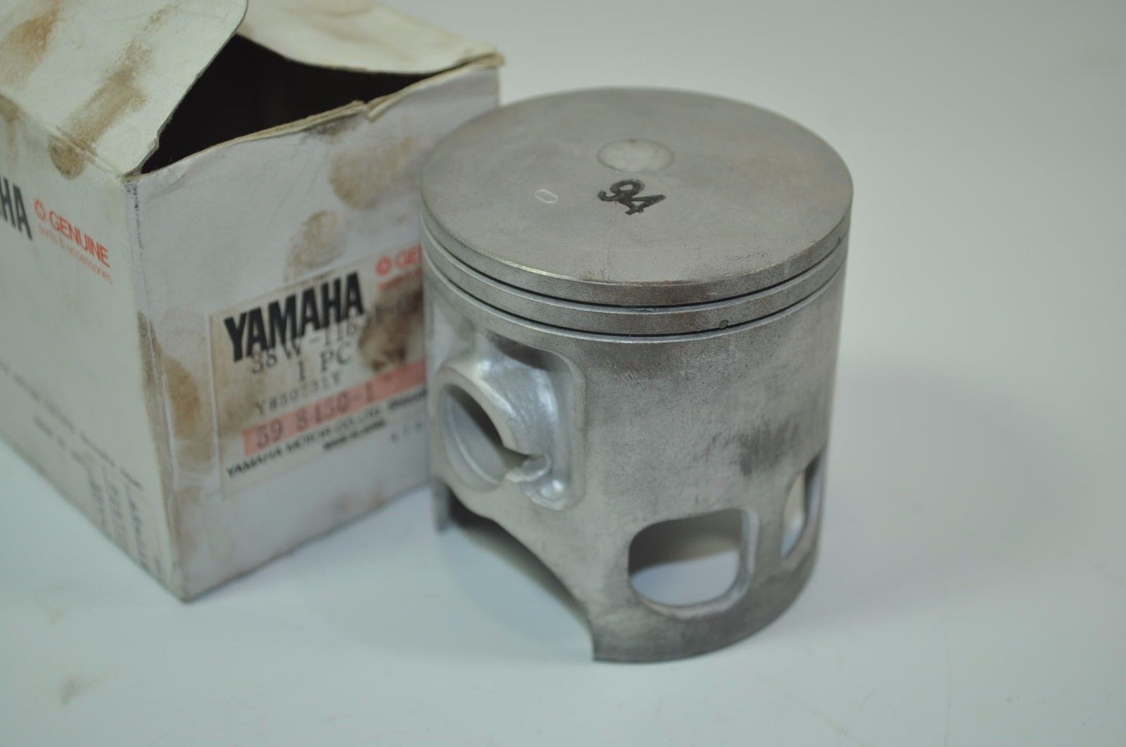

    Now when I bought this bike the original piston was broken (at the carb side) So i went to the local dealer here in the netherlands and he sold me a original yamaha z250 piston (note about 300$ ***** ) Now this one has a bigger intake for the gasoline.
    As I remembered with the old Zundapps back in the days we made these bigger intakes ourselves. But As we did that little to far it didn't want to go in its rpm's at 4/5th gear.......
    Now the issue with my trike is the same..... so could it be that this piston just won't work in the tri-z? Or what do you guys think? Id really hope that there is someone who can help me out as im afraid to go to that super expensive dealer here again

    I googled these two pistons so don't check for the numbers given on the picture. But the original came out and the other one went in... could it be that that one opens up the jets earlier? I never took measurement as the dealer advised me that it would work... ( me)

    Hi Guys, So im able to give you'll an update on this matter: tested the smaller main jet and felt like it got worse. So I decided to take the whole engine apart and would just measured the piston. As it turns out its just the wrong piston, I mean too small intake so no wonder why it wouldnt give me any power right. So I guess im going to order a new piston this week and give it an other try. Its still the original size from 1985, so this cylinder has long time left
