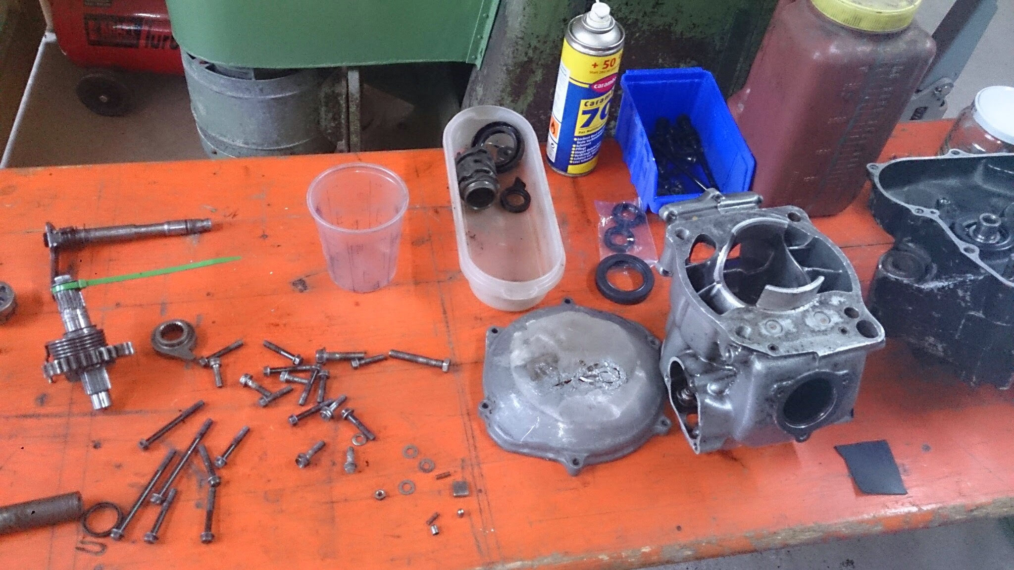

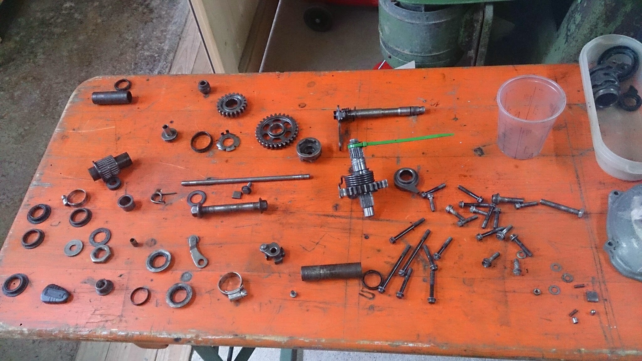

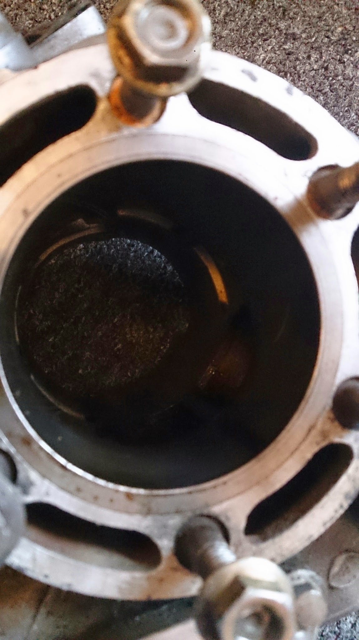

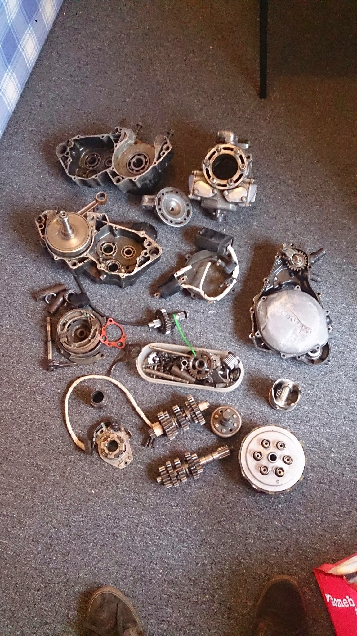

    The design of the trike began during the abroad year in england of my engineering studies. I bought a cheap Honda CR250 engine on ebay uk in great conditon as you can see.

    After a bus ride across europe the engine arrived save in my workshop:

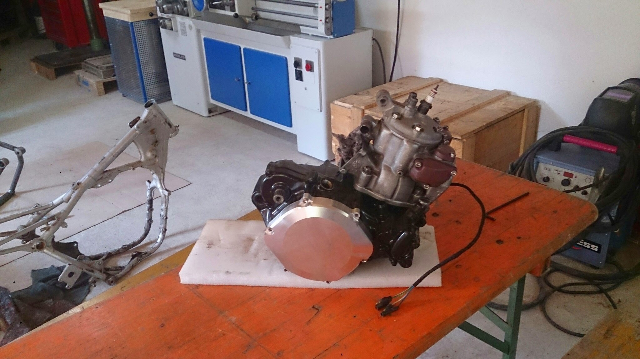

    The clutch cover and the generator cover was to damaged to weld it and therefore new covers were cnc milled:

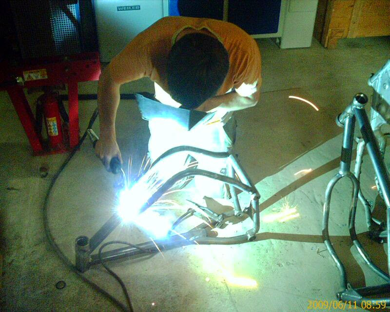

    A jig was weld around a tecate frame to get the position of all the holes and tubes:

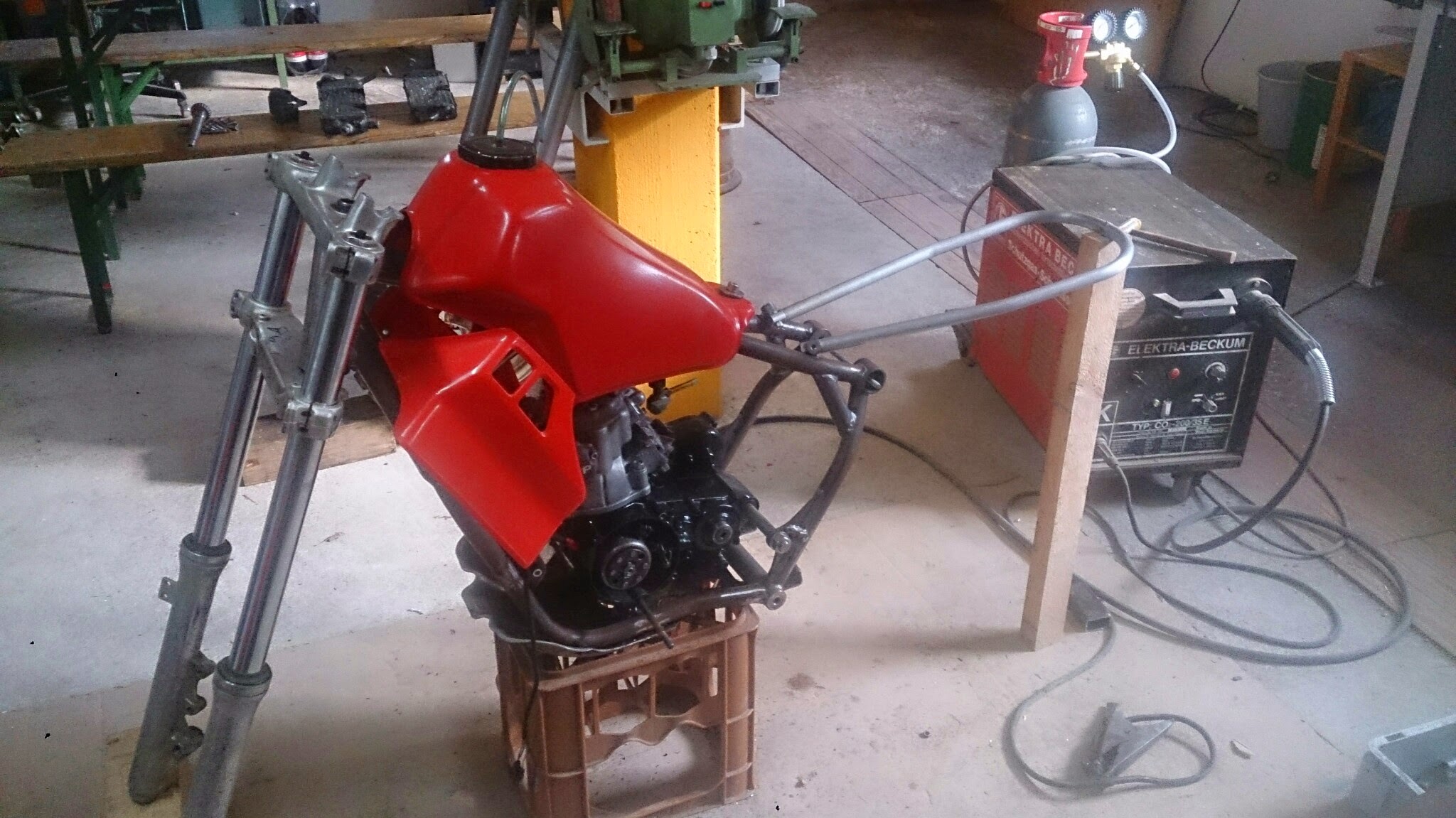

    First testfit of the engine into the frame:
ID:	220426Click image for larger version.
ID:	220427Click image for larger version.
    Aug 2015
    Germany, Bavaria
    98
    I had a CR250 fork laying around from another project which was combined with a 250R tripple clamp from ebay.
    The tank is from a Honda MTX 125 that i cannibalized a few years before:
ID:	220473Click image for larger version.

    Some picture of the plasma cutted engine mounts and of the engine fitting in which was a PITA:
ID:	220434Click image for larger version.
ID:	220435Click image for larger version.
