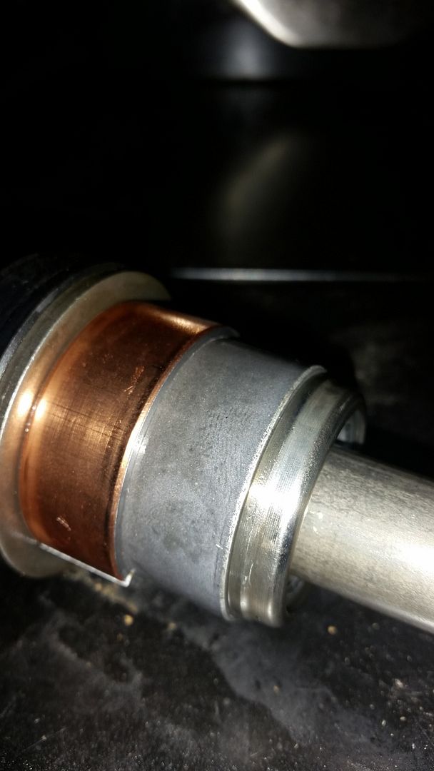

    I need help finding a set of front for bushings for my 86 350x. I'm rebuilding the forks as completely as I can internally but I'm having trouble finding these 2 bushings the one I need is number 11 in the microfiche Part 51415-MA6-003. Honda says there no longer in stock I'm hoping that someone else knows where to find some. I'm not even sure there wore out there completly gray if that means anything. I just figured if everything else was worn they would be to. Thanks

    Are you figuring that the grey color is the Teflon surface?
    If so the manual says you are in good shape.

    If you can post a picture I can help you.

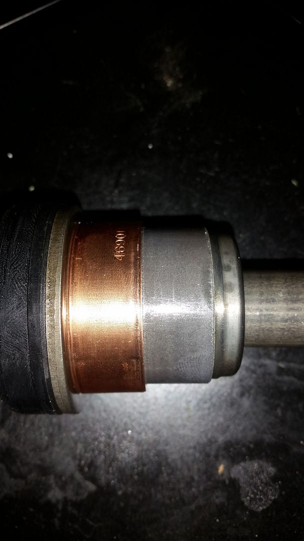

    Yes i'm figuring there teflon coated looks like the inside of a pan but grey not black. Theres nothing but that coating showing I'll go and try to get a pic now.

    I would replace them, they are showing though, unless its the camera playing tricks and your not showing the side where the DU slide metal bushing is over it.

    Ok let's pretend like I'm a idiot here what is the du slide metal bushing. what else do you need a picture of it was dark so couldn't get a very good picture. Thanks

    The bushing on the left side.
    If the forks were not taken apart correctly it will jump over the DU piston bushing on the right side and pulls up the PTFE coating once the edges are pull up from wear or disassembly and you reuse them the coating will wear off quickly, sometimes the coating will come off in sheets.
    If your forks were together we could perform a few tests at this point there 30 year old forks with what appears to not have a known history I would replace and reset history.
    Trike forks were not made to tight tolerances to begin with and they only get worst with wear.
