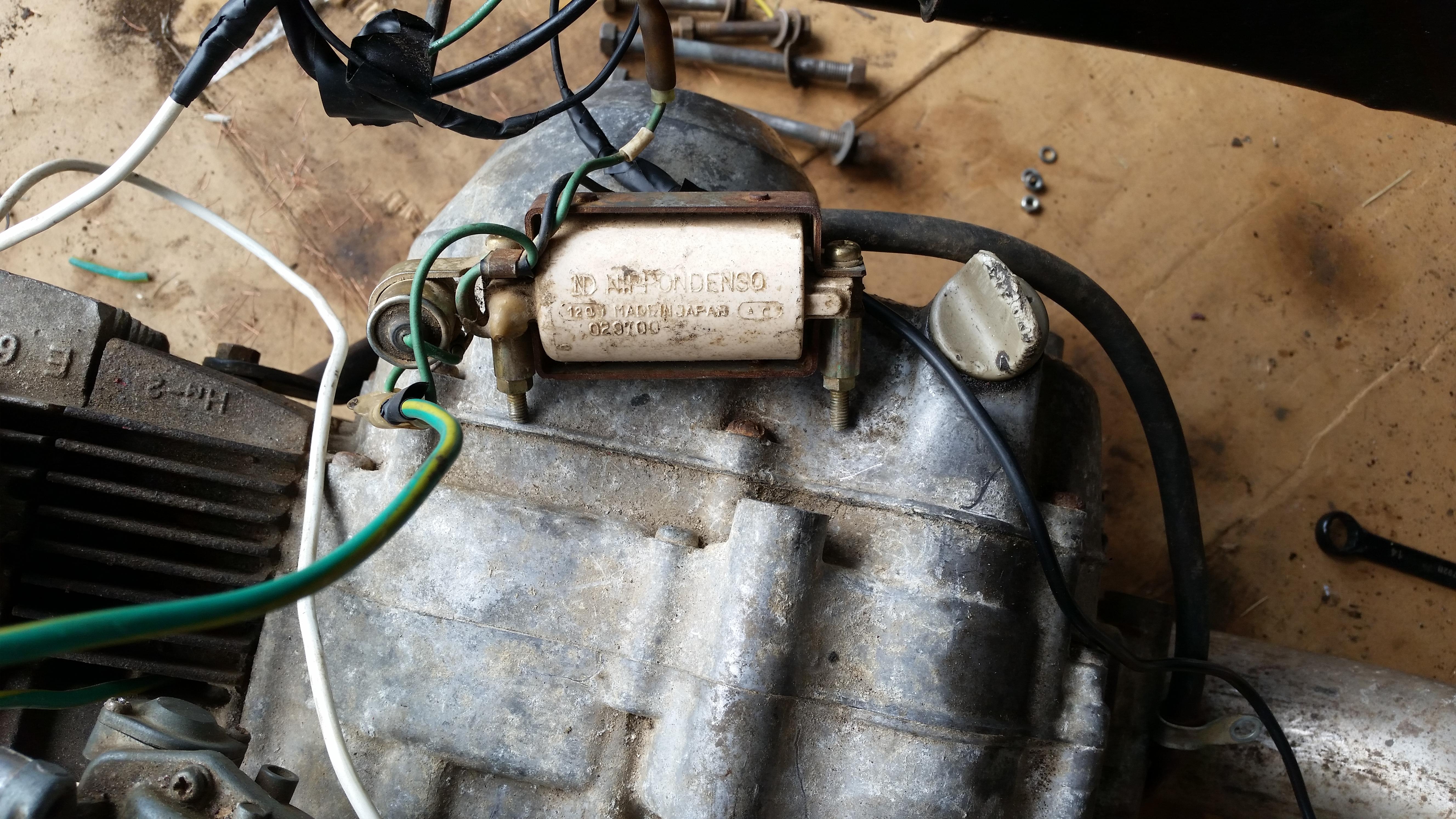

    Put my coil ground to the engine wth no spark (Picture 1) and tryed to pull the rope, No spark with both coil. I know on picture it look like a nothing but ground were ground.

    Put the coil on the engine with nothing else (Picture 2) and pulled the rope. It SPARK but from the grond? I mean it spark from the ground bolt that we use to frame it (Picture 3).

    After looking at your pictures again, I'm wondering what would happen if you cleaned up all your grounds thoroughly, and tightly connected everything and tried again. The spark at the coil bolt you are seeing is the primary circuit current, and the spark itself is indicating poor contact. As far as the plug goes, I generally use the factory resistor plug caps and non-resistor plugs, but the secondary should still be able to fire with both resistor plug and a cap. That being said, I have seen the old NGK resistor caps go bad more than once. Try another one if you have one, or take it off and see if the bare coil wire will spark to ground.
