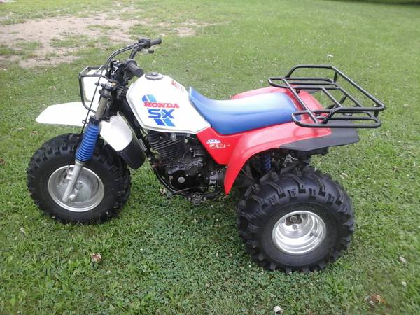

    Hello, I wish I could answer you question directly but I don't know much about the drum brakes and what will fit. I did however see this 250sx for sale with new aluminum wheels. Maybe the seller can answer your questions if you contact them? Good luck, I think it looks good and would be the way I would go if I had a 250sx.
    http://flint.craigslist.org/snw/5172700124.html

    Thanks SSLS1, I reached out to the seller to see if he could provide any information.

    The seller got back on those pictures SSLS1 and said he is running 10" in front and back.

    Great to hear he was helpful, I would be buying that 250sx if I had not just bought a mint 350x just 1 day befor it was listed. Looks cool with those wheels IMO.

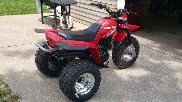

    Check out this 86, looks like he installed some OEM 200x aluminum wheels. .......
    http://flint.craigslist.org/snw/5163120325.html

    Some nice trikes popping up for sale up North SSLS1!. I'm not as a big fan as everyone else seems to be with the front Bear Claw tire. Yeah those definitely look like 200x rear wheels on that 86'. Those don't look too bad but not really what I'm looking for on my setup. I want to try to keep things matching. That 85' is pretty spot on the what I was looking into. The seller gave me the exact info I'm needed. Funny how the word "rare" is loosely used nowadays.
