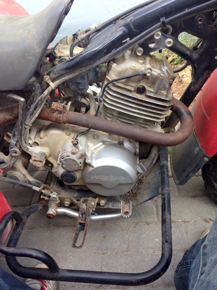

    After being asked if my '86 big red can be sent to the dump I decided to take a break from building an '05 trx450r & go back to the in-expensive beast of my childhood that stood up to abuse no other could! It sat in a garage for 3-4 years after it stopped running & then was put outside behind the garage for about 5-6 years under a tarp.. burried through brutal winters, and... It still looked good!
    With the help of this site, Google & facebook Ive managed to discover some pretty cool things people have done with the BR,
    Mickey Dunlap being the innovator of them all though with his new spin on things! Didnt take me long to be hooked on the idea!

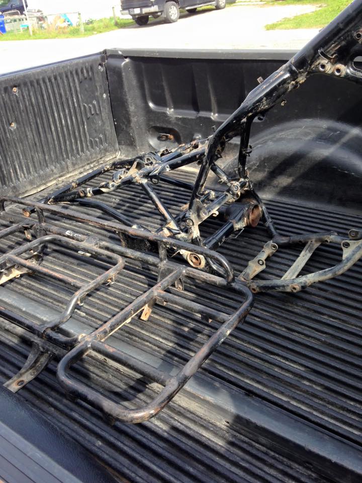

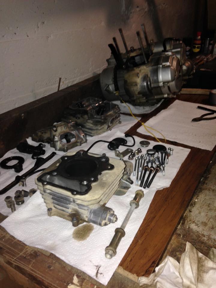

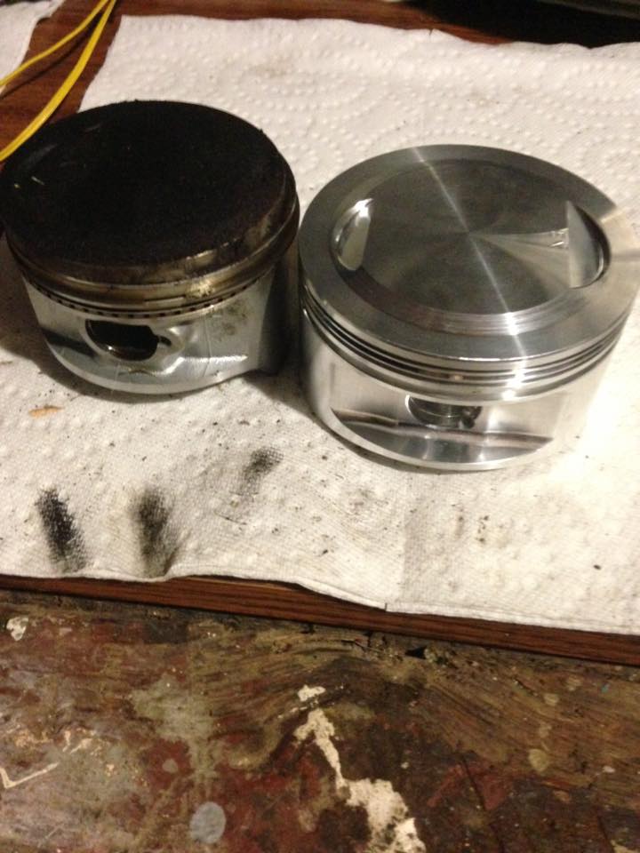

    So I started july 25th of this summer, Brought it home from the cottage & started stripping it in the driveway, to my surprise everything was still mint and completely useable! I have seen parts on ebay in worse condition that are still good... Every friggin' bolt and nut felt like it was torque'd by an impact gun made for andre the giant though, Snipes & wd40 were never far, eventually got it all torn down without much help, Ive never had more than the seat off before and am not the greatest mechanic, more less an ambitious tinkerer that loves bad @ss toys.. The engine was mint! even had the cross hatches from day 1!! nothing loose, everything was surprisingly mint! so.. started sending stuff off to be sand blasted and powder coated and am almost done with that process, will post photo's of when the stuff gets back from the coaters... got some new rims, Still havent ordered rubber but was thinking 26" interco swamplites, got the big bore kit in, Sent out the cylinder and sleeve to be machined and put together, Sent out the head yesterday for porting & bigger valves/installation, Oil cooler kit is on its way, 300ex carb is on its way, Found a nice stainless Bolt Kit on ebay for 150$, thought about tumbling mine but some heads were stripped and theres no sense throwing ugly bolts on a nice new looking bike.. apparently the seller even labels/identifies each baggy of where they go!, so its safe to say I got a big organized mess of parts kicking around waiting for powder and engine work but im just around the corner to putting it all back together!
